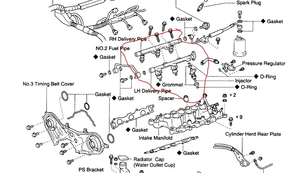

I would drain and flush the fuel tank as the fuel is no good at all. I would also replace the fuel pump, flush the lines up to the injectors.
I am also concerned about the injectors as well. They could have separated fuel contaminating the injectors.
https://www.2carpros.com/articles/how-to-replace-a-fuel-injector

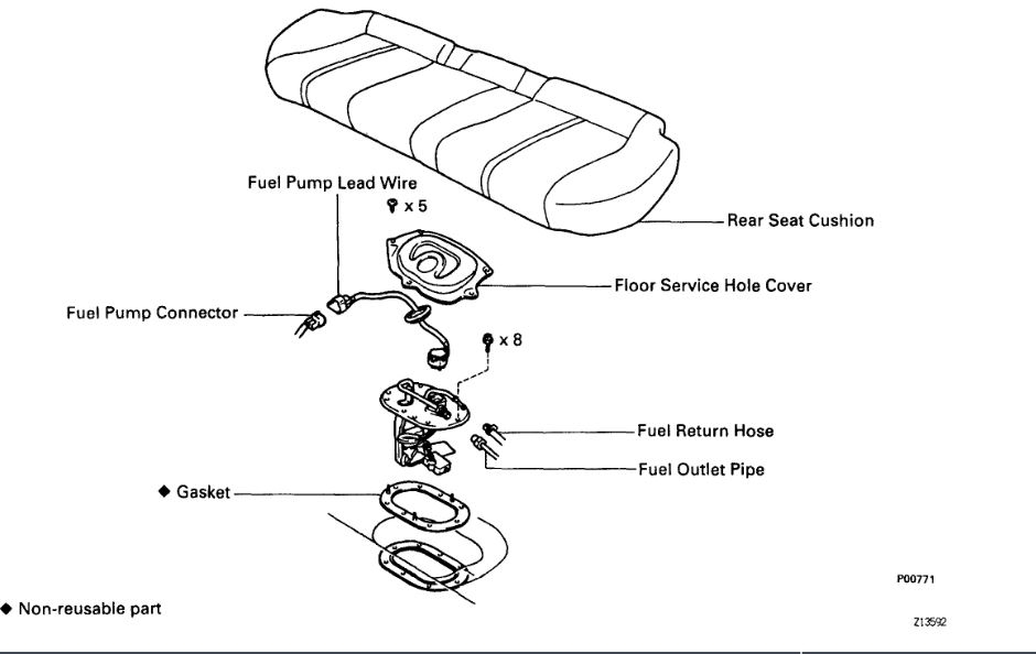

CAUTION: Do not smoke or work near an open flame when working on the fuel pump.
1. REMOVE REAR SEAT CUSHION
2. REMOVE FLOOR SERVICE HOLE COVER
- Disconnect the fuel pump connector.
- Remove the 5 screws and service hole cover.
INSTALLATION HINT: Check for fuel leakage.
3. REMOVE FUEL PUMP LEAD WIRE.
