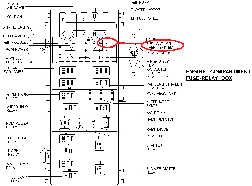

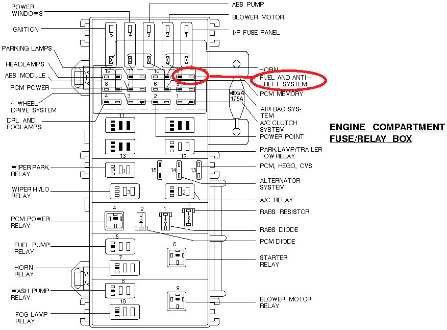

Can you upload a picture of the fuse that blows in and the fuse panel and location? Because it is not showing the ignition 50 amp fuse. I will be able to look it up from the location and then see what it powers so we can fix the problem.
Please report back.
Jul 29, 2018 at 2:21 PM
DENNIS BARNES
  • 4 POSTS
It is the engine compartment fuse relay box under the hood drivers side and it is the number 5 slot 50 amp ignition.
