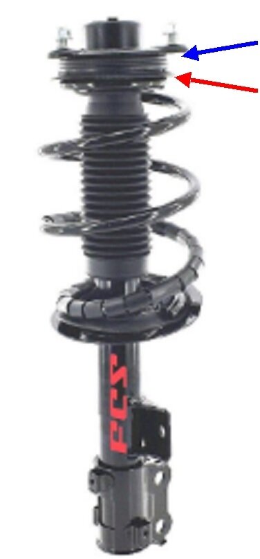

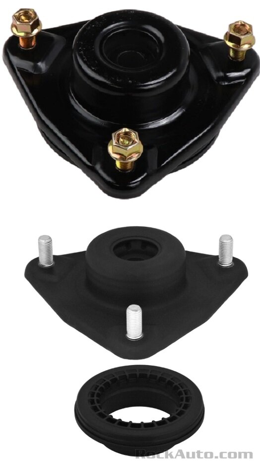

This first photo shows the entire front strut assembly with the new coil spring and upper mount. It's a relatively easy bolt-in installation. The second photo shows just the upper mount, two views. This part bolts to the inner fender. That's also the blue arrow in the first photo. If you open the hood, you can see the three bolts sticking up.
Everything from the red arrow down rotates as you turn the steering wheel. This upper mount and coil spring have the vehicle's weight on it, then the turning movement takes place between the red and blue arrows. That's where any binding or sticking will develop.
