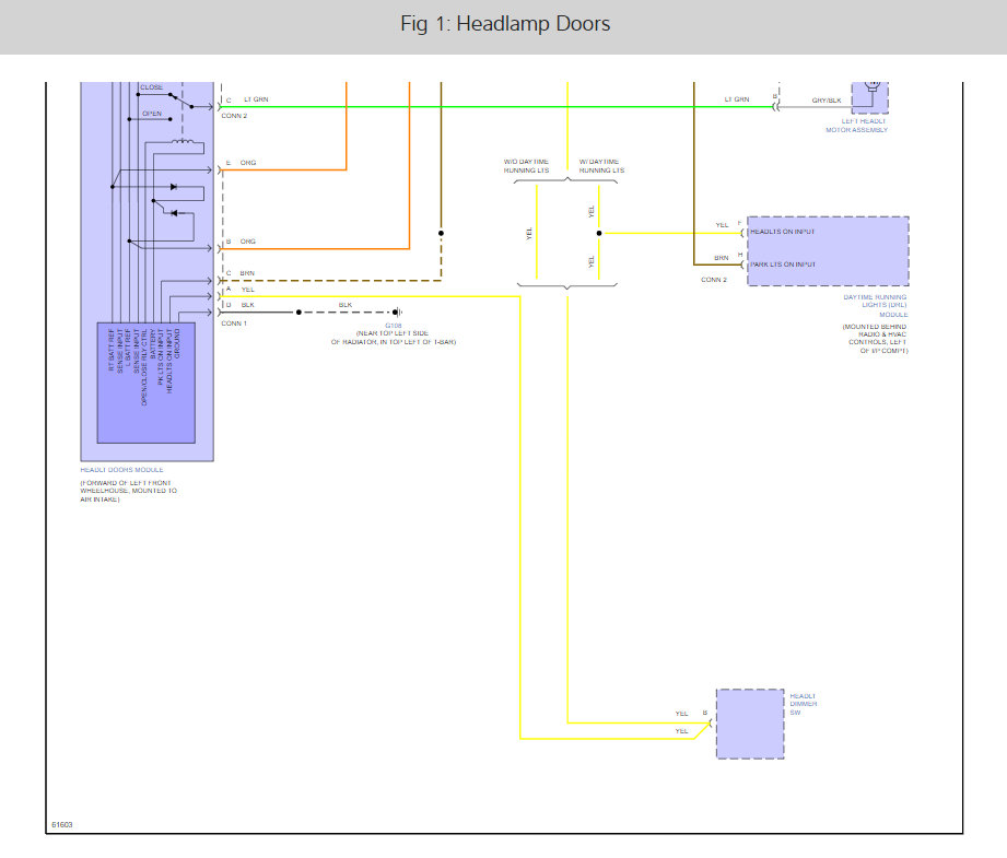

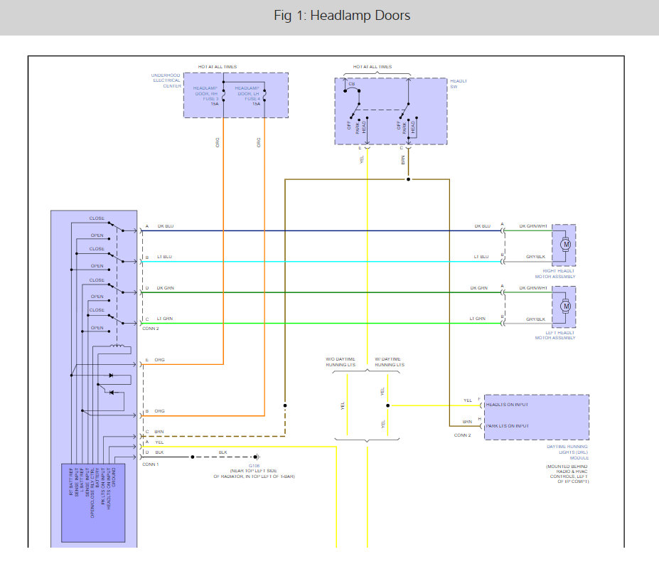

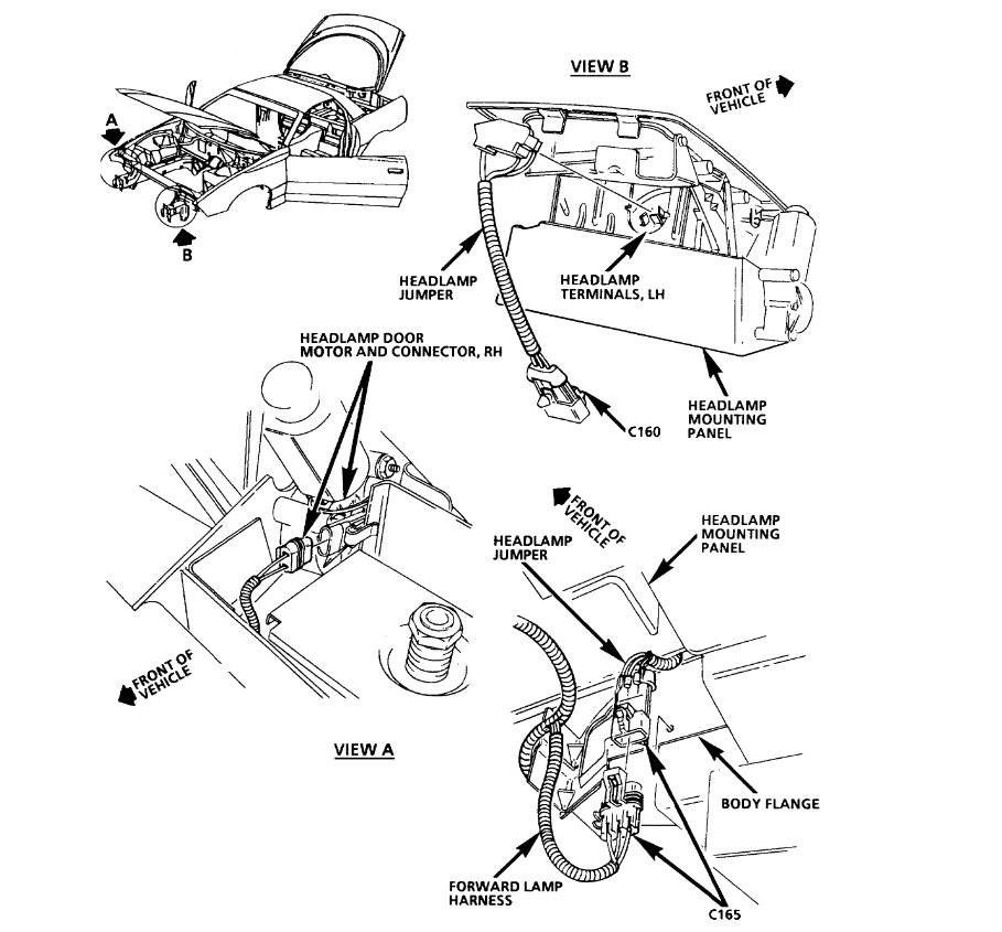

I would replace the motor again, is sounds like you got a bad one, one of the armature poles is not working this is why you must turn the headlight motor to get it to work, but to be on the safe side recheck the power and grounds for the system I have included how in a guide below and the headlight motor wiring diagrams are in the images below to help you see how the system works.
Aug 27, 2022 at 11:20 AM
