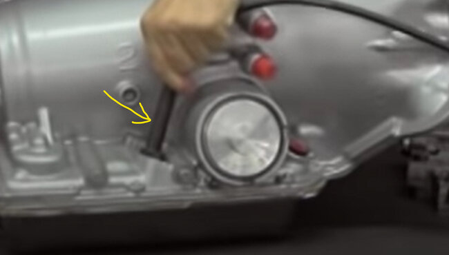

Okay. No problem. I am adding a picture of the placement of something called a TV cable. Check your transmission and see if you have this cable.
Since you dropped the pan and replaced the filter, I would fill it with fluid completely and see if anything changes. I would get it up to 8 quarts, start it then check it while it is running. Then add accordingly. Keep in mind as the fluid heats up it will expand making the fluid level higher.
What was the condition of the old fluid and filter? What color was the fluid?
Was the filter sitting in the pan when you pulled it off or did you have to remove it from the transmission?

Also were you able to look on the passenger side of the transmission and see if you have a cable? I will re-add the picture for you, maybe it didn't come through for some reason.
Please let me know. If this vehicle is an 87 it will not have a 4L60E in it. They weren't made yet. The 700R4 was rebadged the 4L60 in about 93 I think but it was not electronically controlled until around 96.
In order to provide you with the most accurate information and the best help, we need to be sure which transmission you have. Please take a look at the photo and look on the passenger side of the transmission and see if you see the black cable on the transmission.

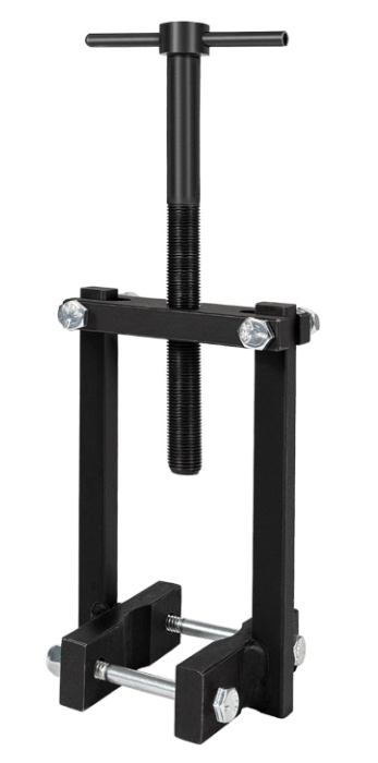

You will need a puller for the pump. I found one on as an example. I have never bought nor am I affiliated with the seller. Here is the link for you:
https://www.ebay.com/itm/255775223198?epid=25043912290&hash=item3b8d642d9e:g:uLcAAOSwznxkr2TU&amdata=enc%3AAQAIAAAA4HkH6FDfSP1df%2B4S3PSS5sCJv3PNV8M7wFp6FO9foJAGm7SqYodXYMb2TJ7eKpsV4jvw2YQgUFWgYGmD9%2BQ%2FQSgxuFu9xXeSlughbutX1zq40txdGUCZE2E1Wq6JQDkjX%2B6JKHliOxxTEH6CR3XioLkbK1ho0RcEkhmQV2iuIUI7KyQiE%2FMWeRoaNcWUlWFloUOqYLTSWjjC75E4Lw9k7pzy2%2B5gzJo6vVOQQSWlkzNAnTY5ctLaX1Wp619ImmWOn0FRPzOOJ9izv0dUnSR%2BuXL2elOzf79MlkVK8h2AmQUV%7Ctkp%3ABFBM8Kni5ali
