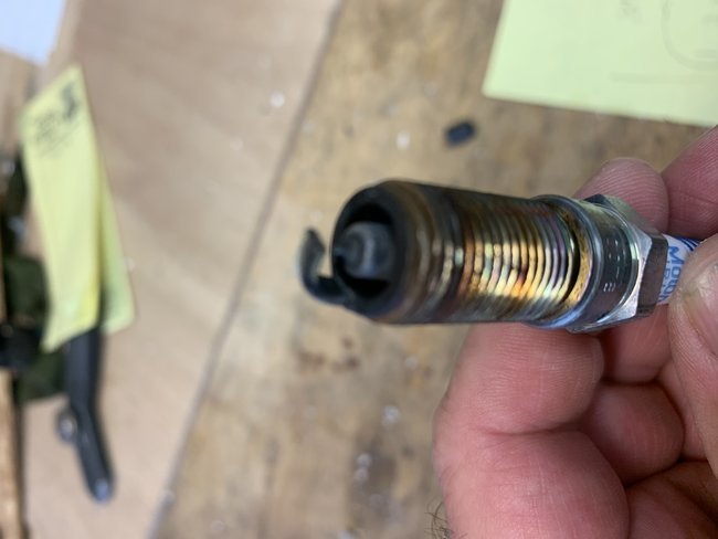

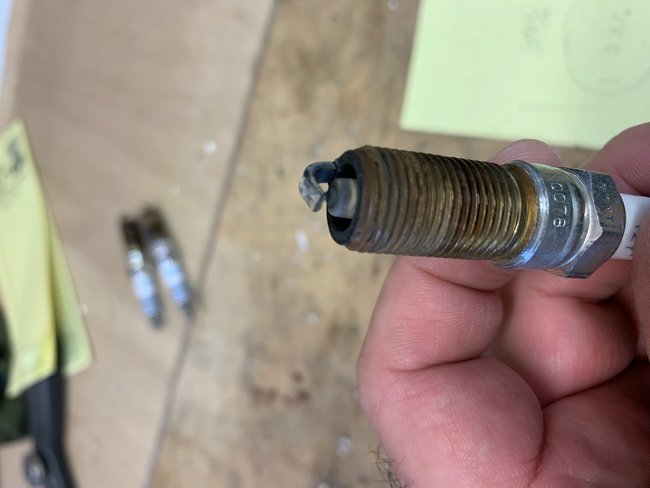

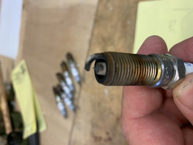

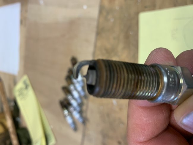

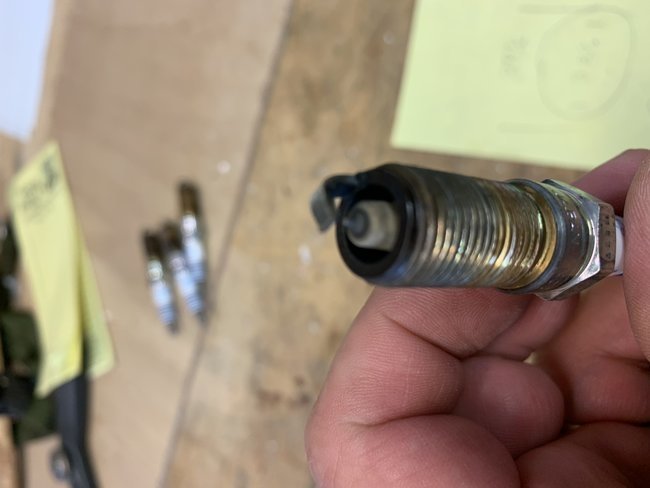

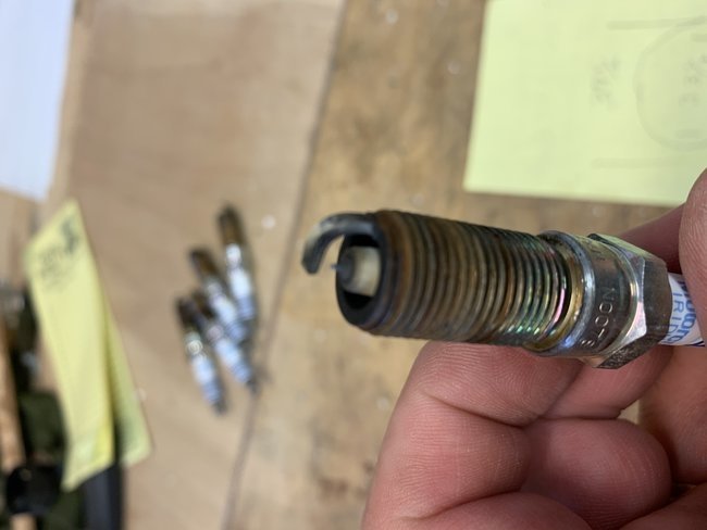

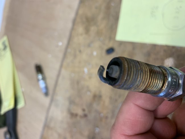

Okay, I’ll take a look at those things tomorrow and let you know what I find. I changed the plugs awhile ago and I think they’re gone, but I did take some pictures which I’ve included for you to look at. For some reason I only have 7, but they were all very similar. Tell me if you see anything, I always have a hard time reading them. It always seems like it could fall into several categories.

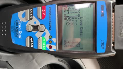

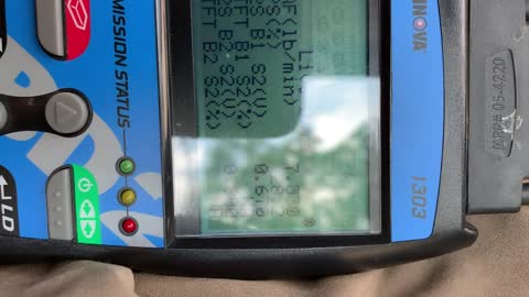

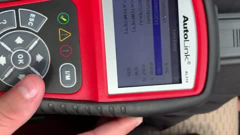

I've got 3 videos for you here, I'm not sure if I've got the readings you want to look at or not. If not let me know and I'll go back out. I also apologize in advance for the quality of the 2nd video, my 12 year old was holding the camera because I thought that would be better than me doing it while driving and it didn't quite work out that way.
The 1st video was me accelerating onto the highway this morning after about a 5 minute drive.
The second video was me entering the highway again but with different measurements on the screen.
The last video was me cruising on the highway after the second vide, with a different set of readings. Hopefully one of these helps.

The numbers are not out of line. However, the last three spark plugs that you had pictures of appear to be carbon fouled. Do you know which cylinders these came out of?
I would think about changing the injectors out of these cylinders. Clearly anytime we are dealing with fuel mileage it is very subjective to the amount of hard accelerating you do but if you have been driving the same the whole time then I am thinking you have an injector or two leaking.
The only other possible cause would be o2 sensor issues. However, they appear to be operating properly.

Looking at the O2 sensor data, the bank 1 and 2, sensor 2 data seem to be similar when cruising , but if I accelerate or vary the throttle they become very different. they can be reading .7 on one and .2 on the other and one might be changing more rapidly than the other. but I'm not sure just looking at the tool and the one I have doesn't graph. I think I can get one that does if you think this might be the issue. when things get back to cruise or consistent throttle they tend to read the same. The sensor 1 data seems to be closer together I think.
I have some video my wife took of the scan tool but she wasn't real steady and I'm almost embarrassed to send it to you. You almost need to look at it in slow mo to see what's happening.
Could this be the problem causing my issue, even without a CEL? IF it might be I can have my son take better video and send that too you or anything else.

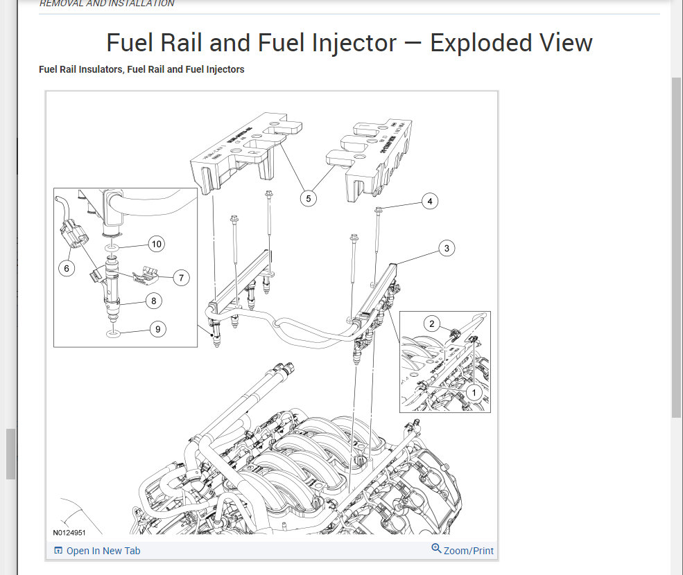

The goo thing is you seem to have one bank running properly and the other is not. This means we can verify what the issue is by switching components one at a time from one side to the other to find when the other bank starts running rich just like this current bank is.
I would suggest starting the o2 sensors. Swap them all from one side to the other. I don't think that is the issue but they are the easiest thing and could be doing it so I would swap them just to eliminate them for sure.
The fact that this is only affecting one bank, it is unlikely that it is a MAF sensor or vacuum leak as that would effects both banks.

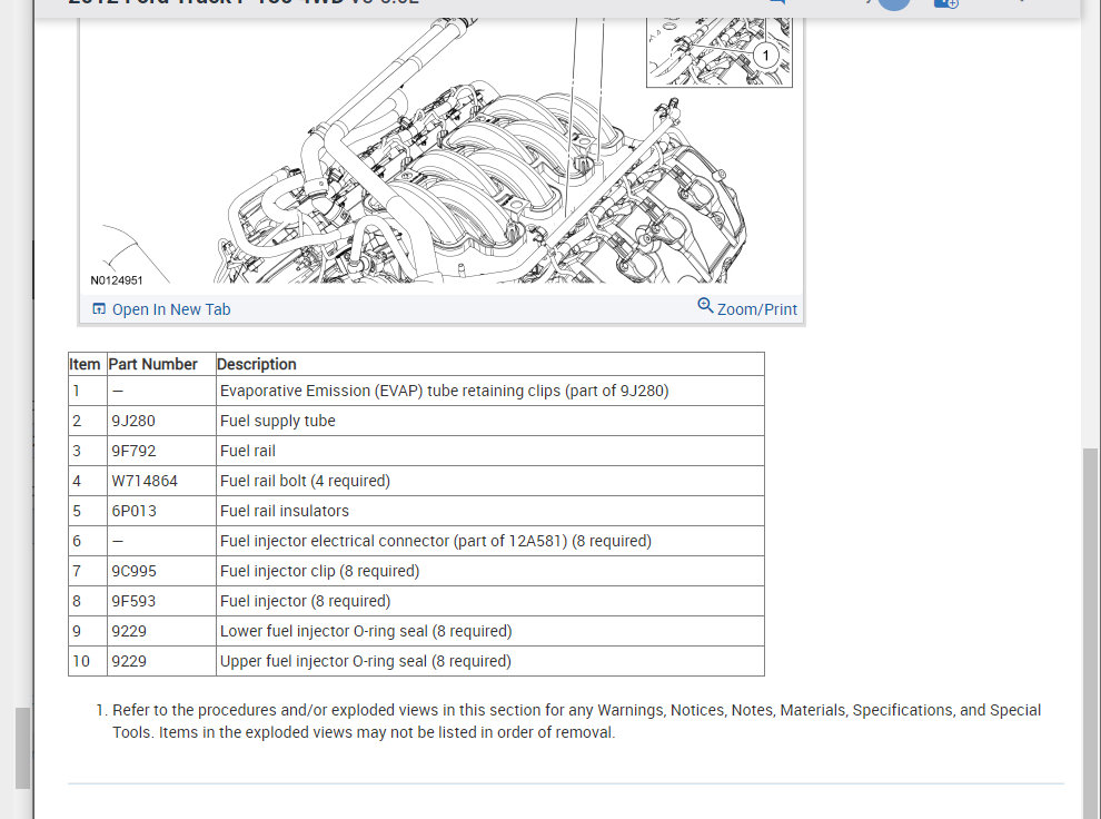

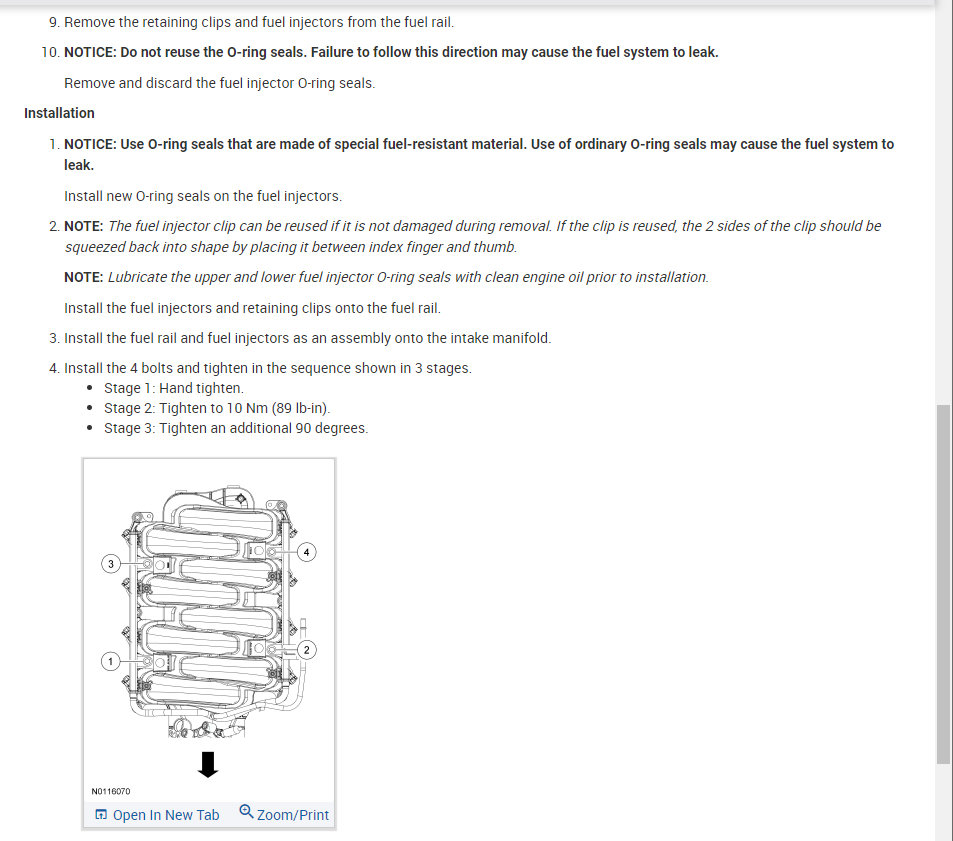

If the o2 sensor is not the issue then I would swap the injectors side to side.

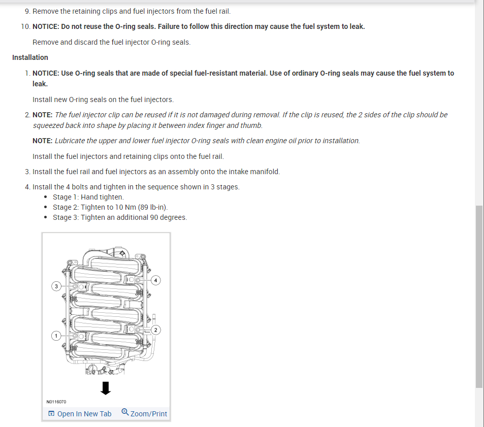

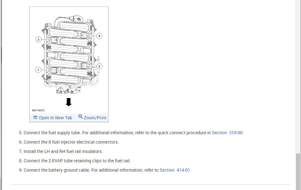

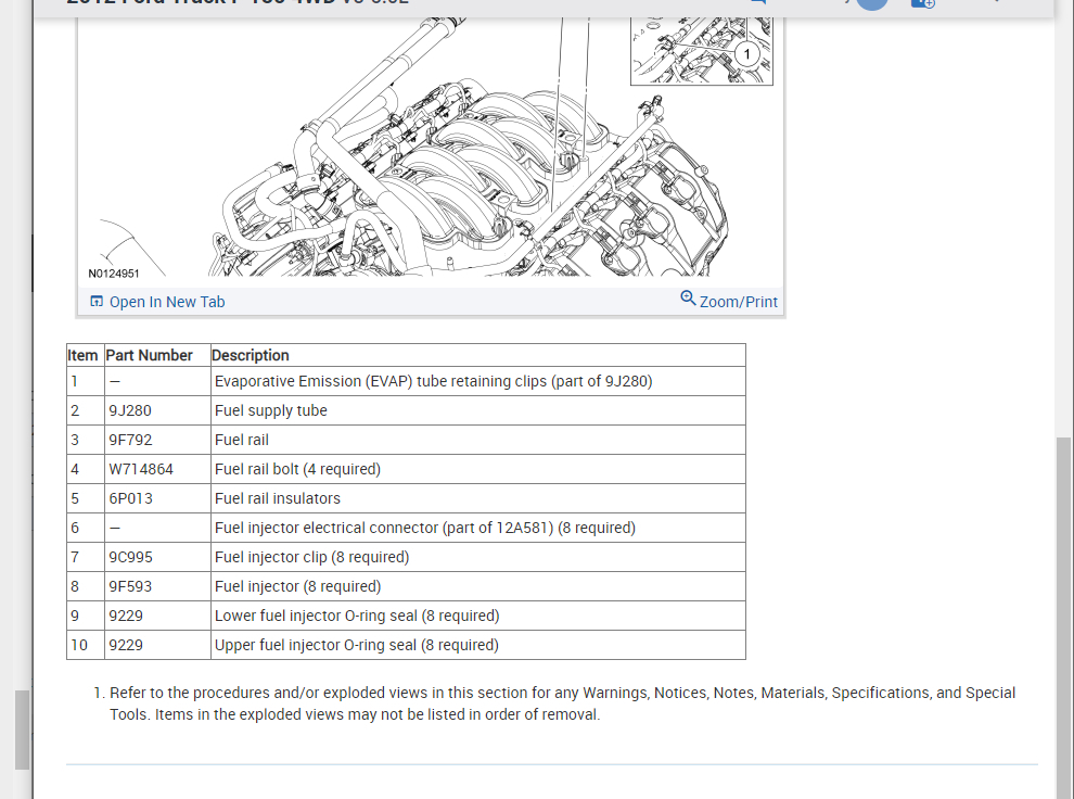

I included the process below for this. Please let us know what you find with this.

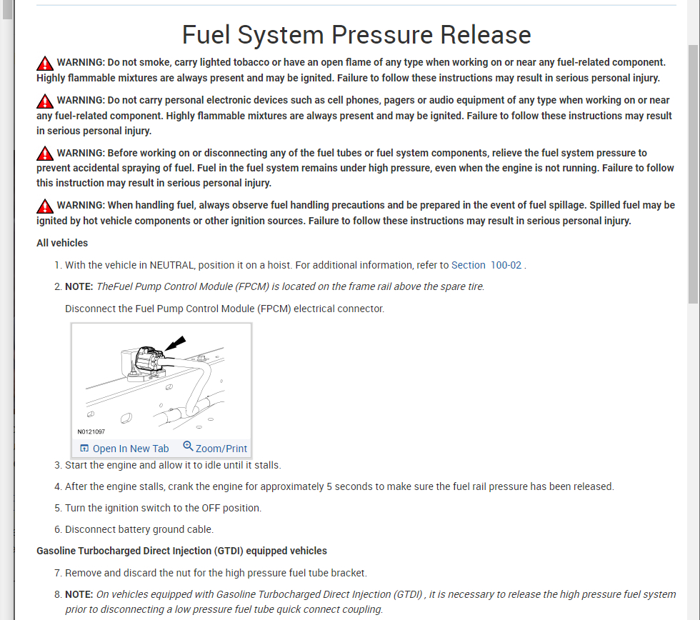

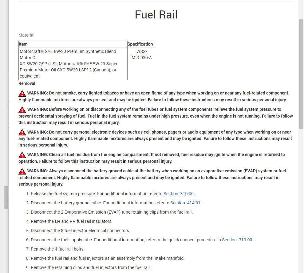

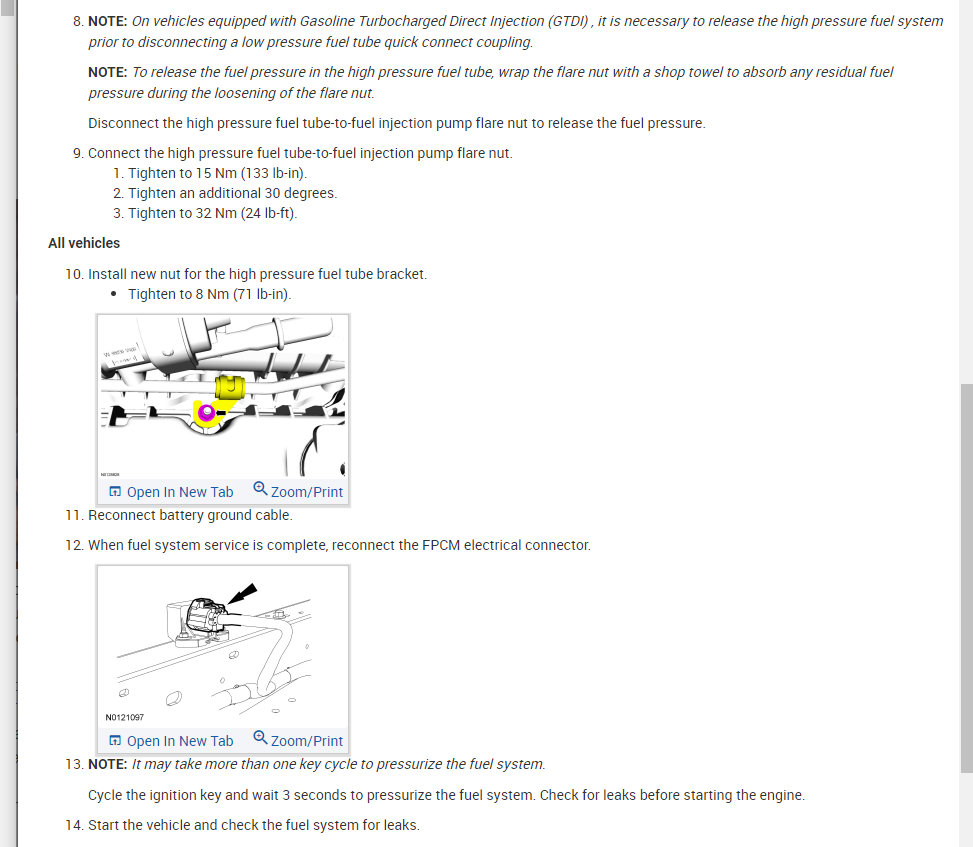

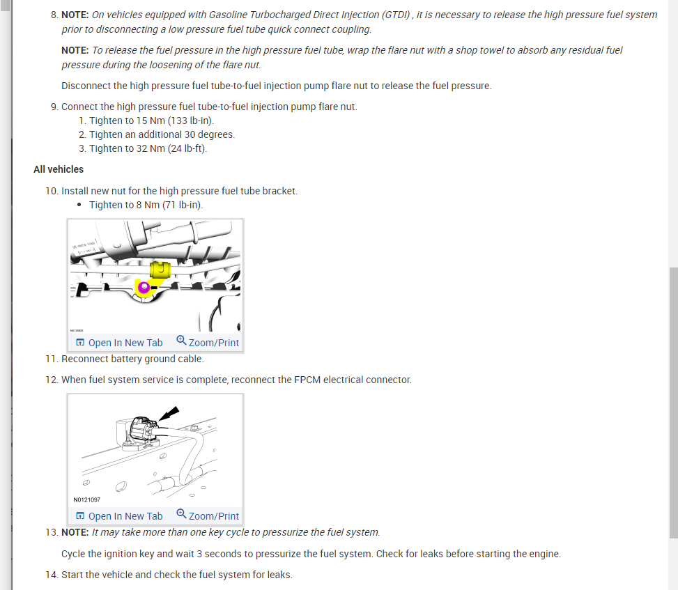

As far as the injectors, I’ve never messed with them before. And it’s a little intimidating, although videos online make it look like changing plugs and depressurizing the fuel system. Is there anything I need to watch out for or that’s easy to screw up? My buddy posted a meme a year or so ago that said “every 20 minute job is just a busted screw away from a 3 day ordeal”. Anyway let me know what you think and I’ll try to get better readings and swap the sensors.
Thanks
Jul 20, 2021 at 10:15 AM
This can be a big deal if you are not familiar but not impossible. I am attaching the process from the manual on how to depressurize the fuel system. Also, if you are still worried just wrap a rag around the connection that you are taking apart as you pull it apart and that will keep any fuel spray down. However, if the pressure is relieved then you are good.

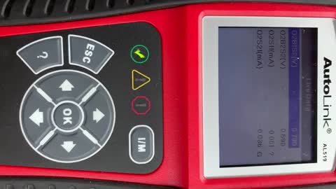

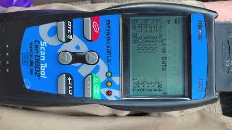

I wasn’t able to get any physical work done this weekend, but I did get the other scan tool and was wondering if you could look at these 2 videos and let me know if they tell you anything. Things are moving so quick that it’s hard for me to tell what’s actually happening because I’m not sure how they should react normally. One is definitely moving faster than the other, I just don’t know if the slow one is lazy or the fast one is incorrect. They were both taken while accelerating. The strange thing is that when I had my wife take video while hauling the boat, they didn’t seem as bad.

Here’s the second video. Also this scan tool will graph, it just won’t graph them both together so I don’t know if that would help you or not.
Jul 26, 2021 at 5:28 AM
Unfortunately those numbers appear to be perfect. Both high and low are switching around 0 but are dropping high to low which means that the PCM is seeing a rich condition and it adjusts, then adjusts again. Basically it is never going to be sitting still when operating properly. When they are not switching or jumping around is when there is an issue. That means that the exhaust is rich or lean and the PCM is not able to adjust it by adding or removing fuel.
Just to take a step back, were these numbers when the engine was not running properly?
Also, what were all the tempeature sensors reading? Engine coolant, ambient, and intake air temperature.
You are correct that the o2 sensor data is ignored until it is warmed up so if this was before the engine warmed up then that may explain why they look okay.

I understand what you are saying. However, that is not abnormal. Basically the down stream o2 sensors are measuring the ability of the converter to reduce the harmful emissions and they are going to work differently from each other. As long as they are both switching numbers and not remaining steady then that shows they are operating.
Based on this info, I think we can move on from o2 sensors but we need to check compression next as that can definitely cause what you are seeing.
