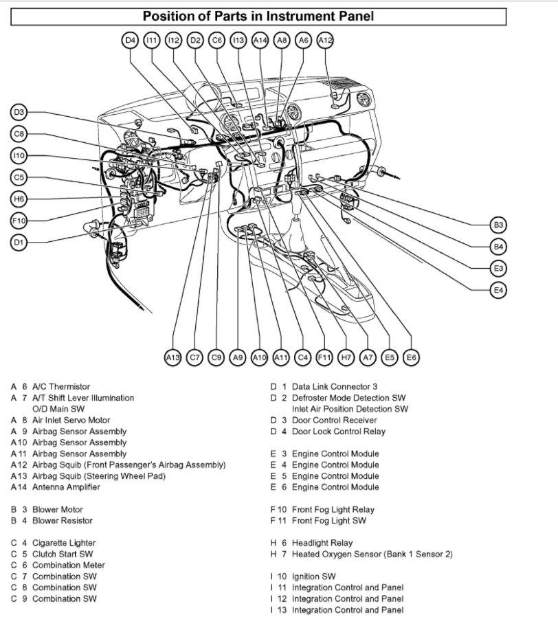

In the meantime here are some guides that will help you understand the problem before you take it in.
https://www.2carpros.com/articles/car-air-conditioner-not-working-or-is-weak
and
If it is a blend door actuator problem here are some diagrams (Below) that are for your car.
