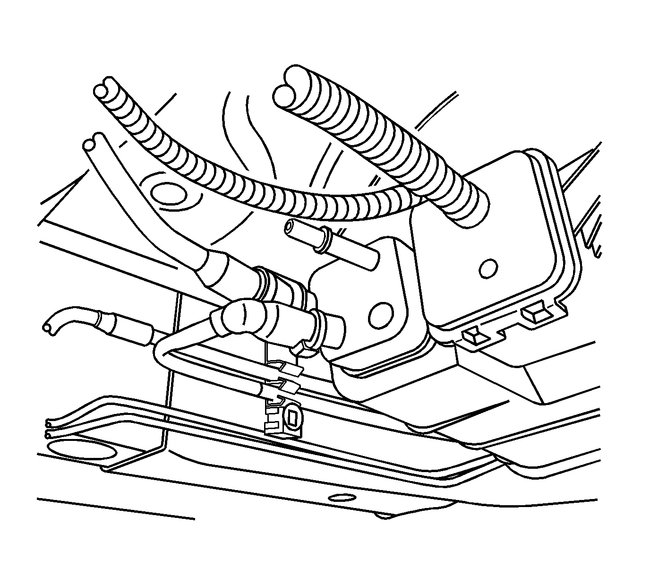

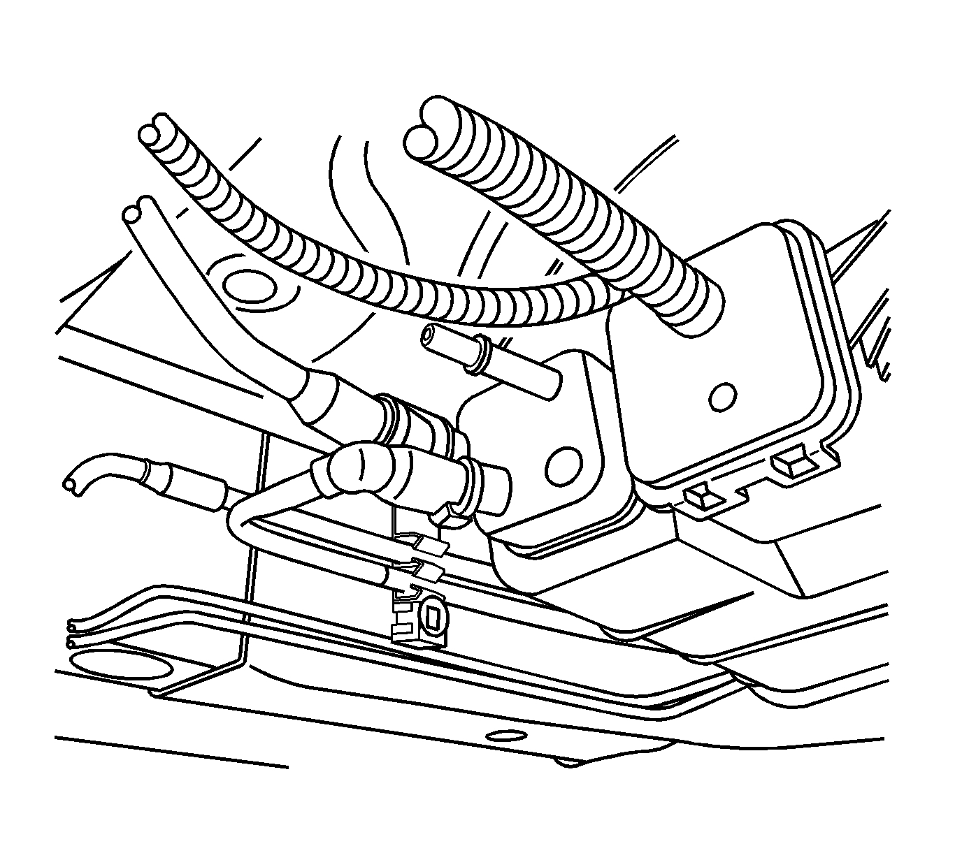

4. Raise and support the vehicle . Refer to Vehicle Lifting.
pic 1

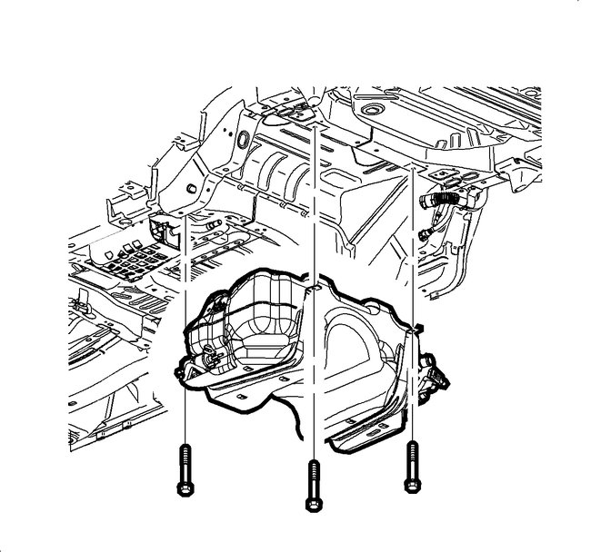

5. Remove the rubber exhaust hangers on order to allow the exhaust system to drop slightly.
6. Remove the propeller shaft, if equipped.
pic 2

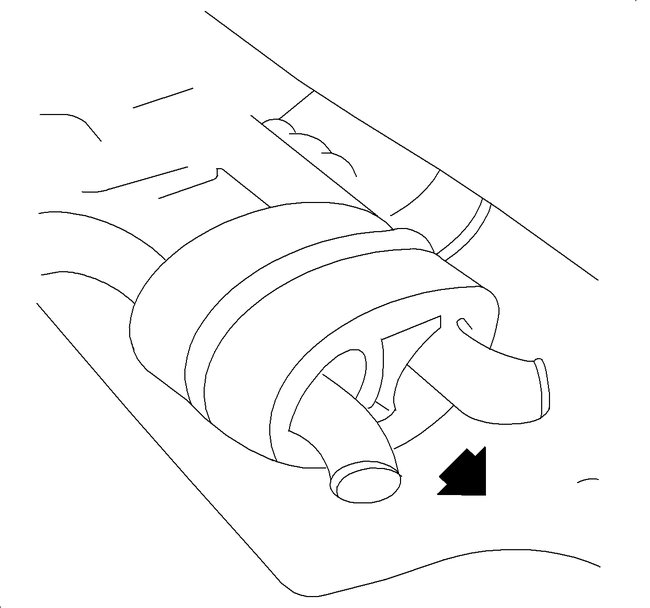

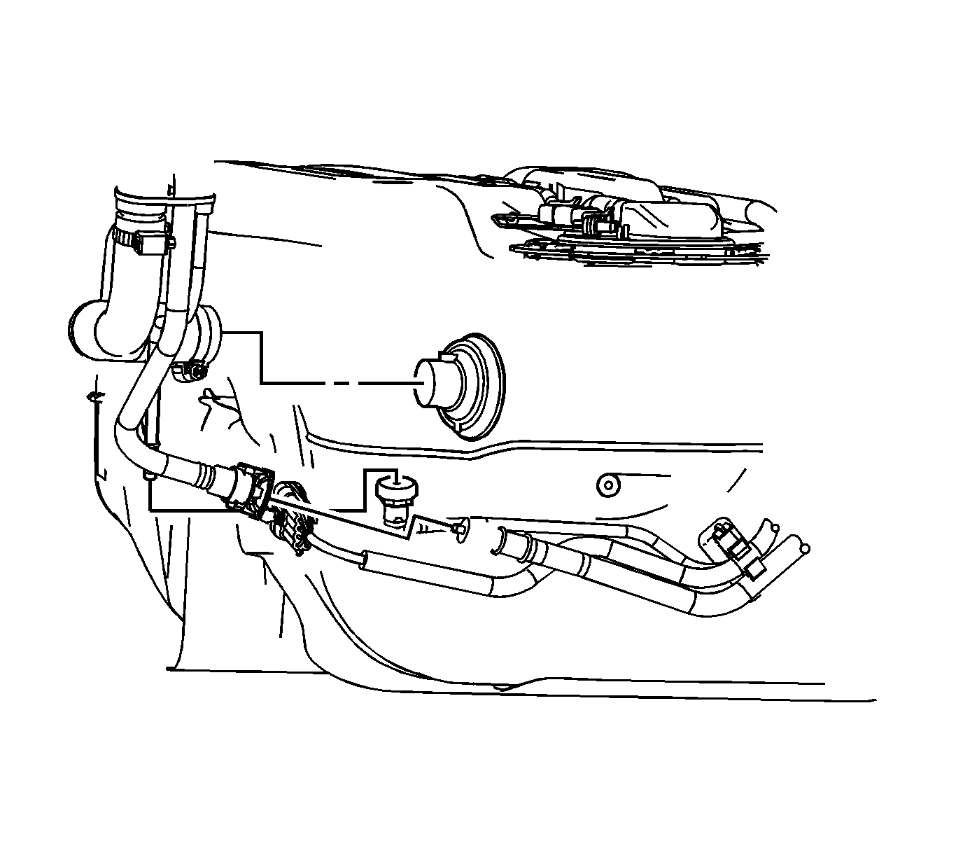

7. Disconnect the EVAP canister vent and fresh air hoses:
NOTE: Clean all fuel pipe connections and surrounding areas before disconnecting the fuel pipes to avoid contamination of the fuel system.
1. Grasping both sides of the quick-connect fitting, twist the female connector 1/4 turn in each direction in order to loosen dirt within the quick-connect fitting.
2. Blow any dirt out of the quick-connect fitting using compressed air.
3. Squeeze the plastic retainer release tabs.
4. Pull the connection apart.
5. Inspect both ends of the quick-connect fitting for dirt and burrs.
pic 3

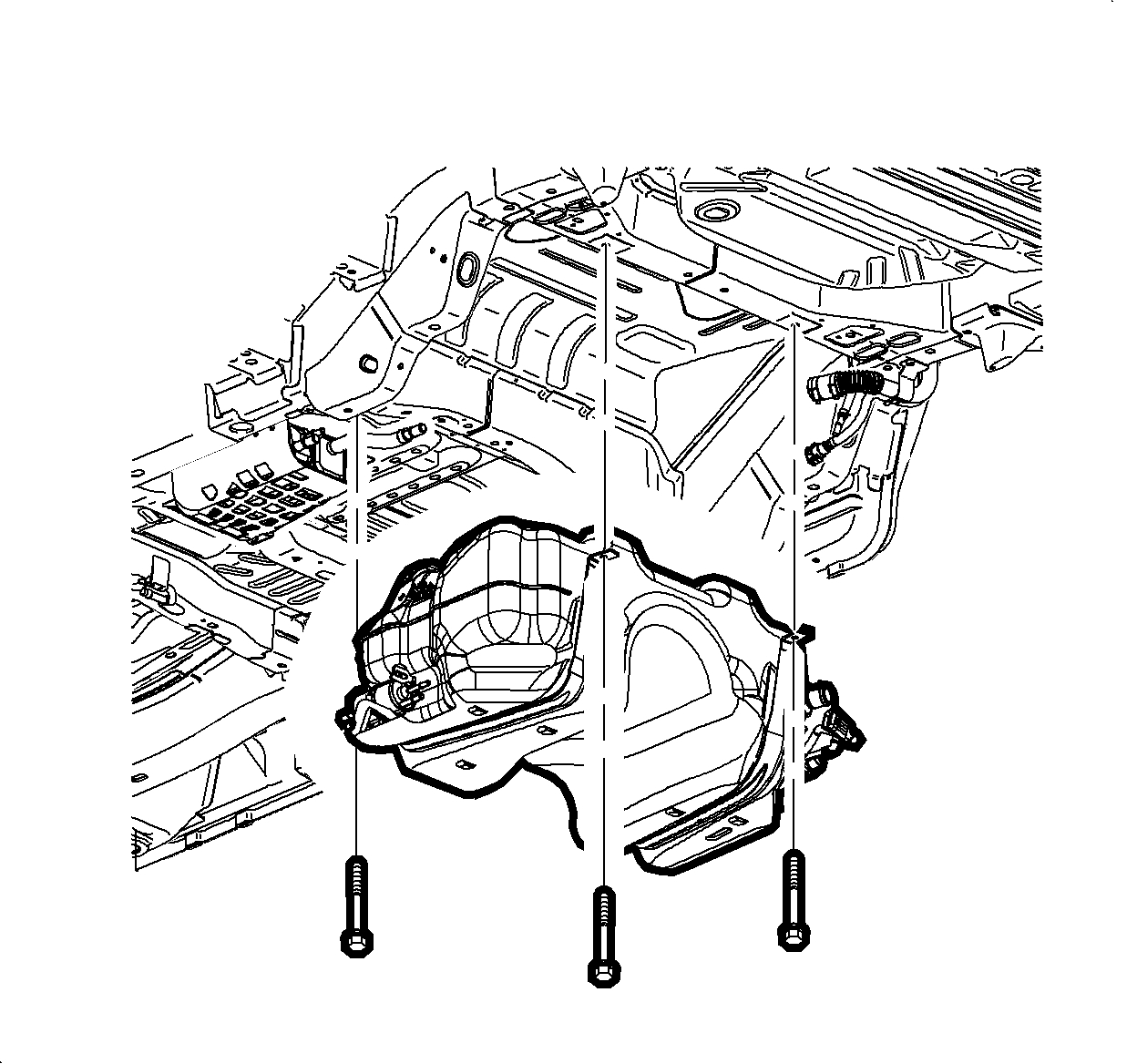

10. Disconnect the electrical connectors:
1. Fuel tank electrical connectors
2. EVAP solenoid electrical connector
pic 4

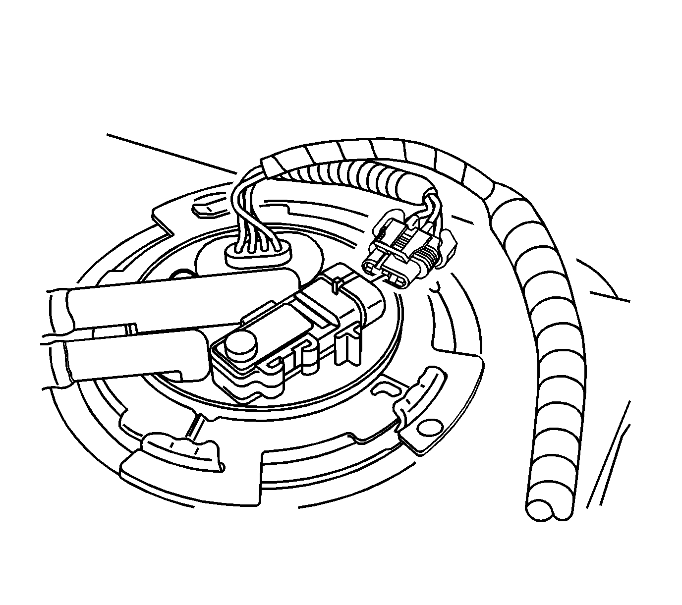

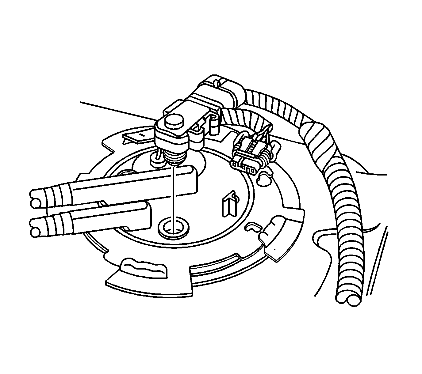

2. Disconnect the fuel pump module harness electrical connector from the fuel tank pressure sensor.
pic 10
3. Position 2 flat-bladed screwdrivers, one on each side of the sensor, near the vacuum port.
4. Carefully use the screwdrivers to lift and release the sensor from the fuel pump module.

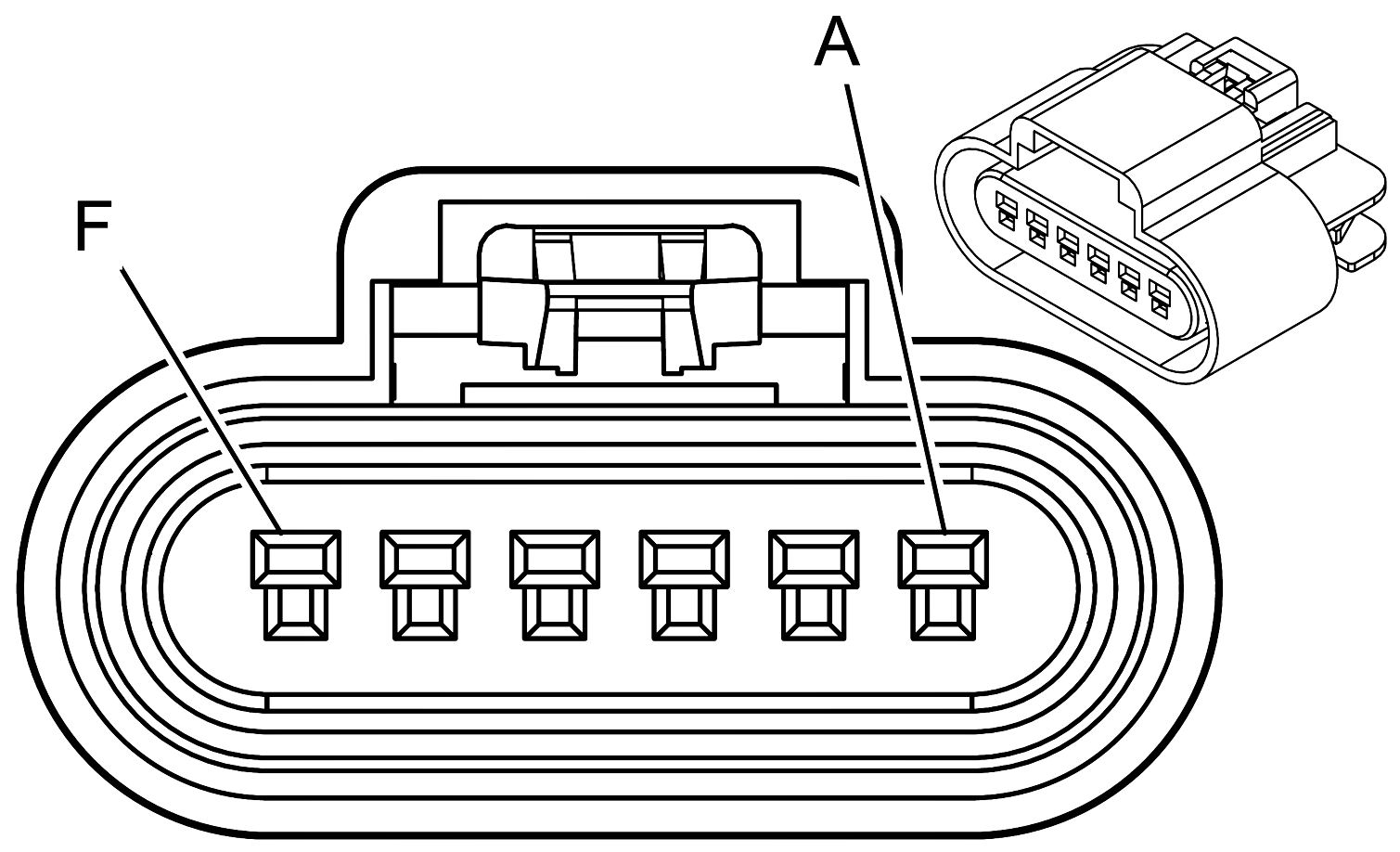

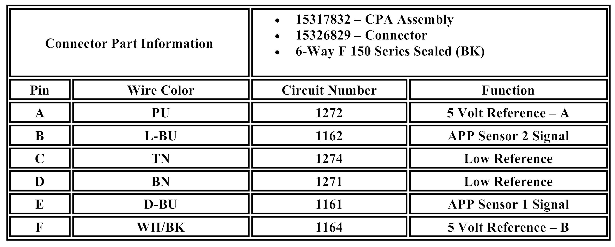

Okay, you should have a 5 volt reference in pin A and F of the connector. Pin A is the suspect for the issue, but check both. For the code to set, the ECM detects that the APP sensor 1 voltage is less than 0.13 volts. What I need you to do is check the connector pin to confirm there is 5 volts. If there isn't, either you have a broken or damaged wire, or there could even be corrosion causing a poor connection at the ECM.
If you look at pictures 1 and 2, they show the connector and what each pin is for. Focus on pin F for voltage.
Check that and let me know what you find. Also, if you find 5 volts, then confirm that pins C and D for continuity to ground.
