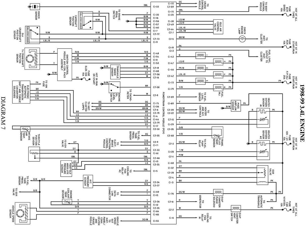

Okay i tried swapping coils and the problem does not move with the coil it stays on the same cylinder so this rules out a problem with the coils. still is there anyway to know wheater my ignition module is at fault because i dont want to replace it without it being sure it cost's roughly 90$ (alot of dough right now) I also re did my test to check there is a spark but far weaker then the others, when i unplug the cylinder there is no arc to the coil but when i do it to the others there is. aside from seeing the diference i felt the difrence between the sparks on my arm lol Could this be caused by the wires coming from the powertrain control module (as i no longer trust connectors on this truck) or would one of those wires being loose just cause it to not work at all
https://www.2carpros.com/forum/automotive_pictures/516029_1998201999203_8L20Engine20Schematic_1.jpg

Here is the schematic bigger just click the below link
