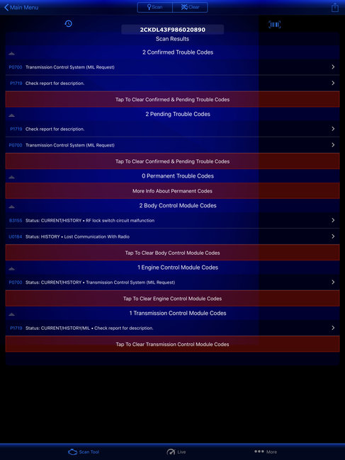

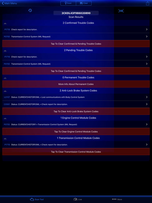

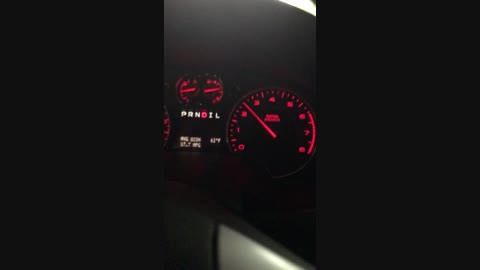

I have been having nothing but problems with this car. I just spent $3,000.00 on a new head gasket. Now, after awhile on the road, the transmission starts slipping and slamming into gear. Now it appears to be in limp mode. To make things worse, I am one hundred miles away from home. I attached a photo of the codes I can read from the cars system with my scanner. I would appreciate any help you can provide. I am truly desperate.

Photo and video uploaded as further documentation.

Good afternoon.
Can you tell me the last code listed at the bottom? The picture is too small and dark to read the codes.
May 13, 2018 at 1:06 PM
VSSOUTLET
  • 57 POSTS
P1719.

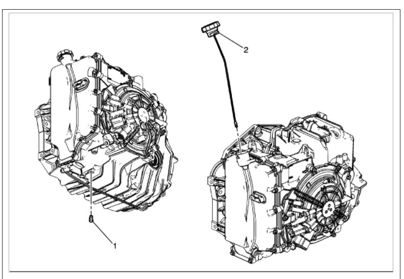

Too me it sounds like the transmission is low on fluid, you have a you have a turbine speed sensor that is not plugged in or is bad. Can I ask if this problem happened directly after the work was done?
Here is how you check the fluid level. Check out the diagrams (below). Please let us know what you find. We are interested to see what it is.

Fluid was checked at least three times and changed twice. This problem has existed for over five months. This issue is a true "gremlin." I cannot get it to happen for a mechanic because it must be driven for awhile first and then shows up under mysterious conditions. Codes I have been able to read from time to time include P1719, P0700, U2107, C0561.

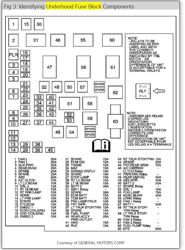

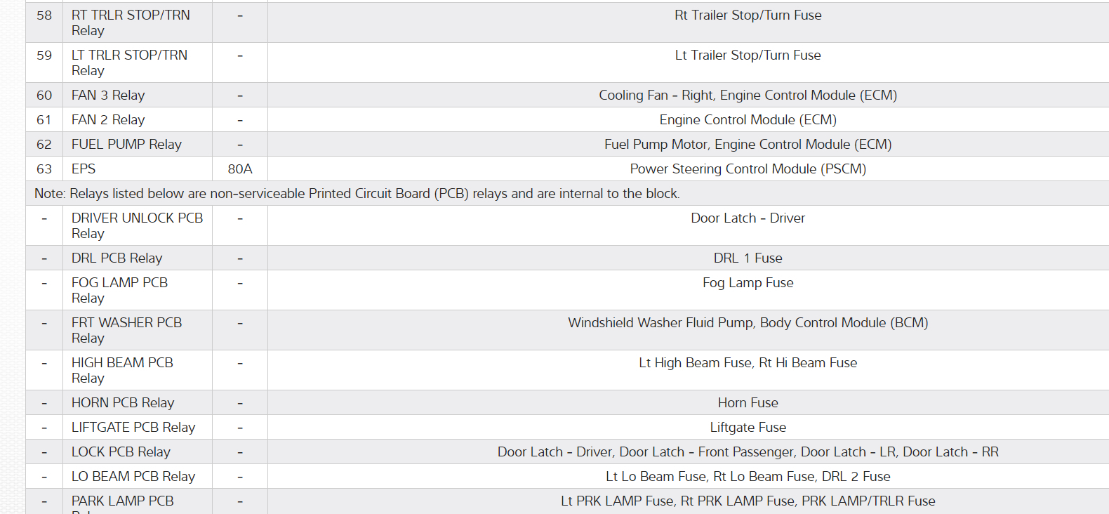

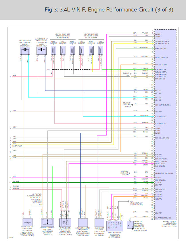

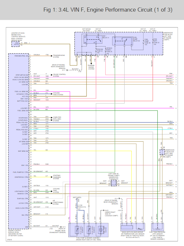

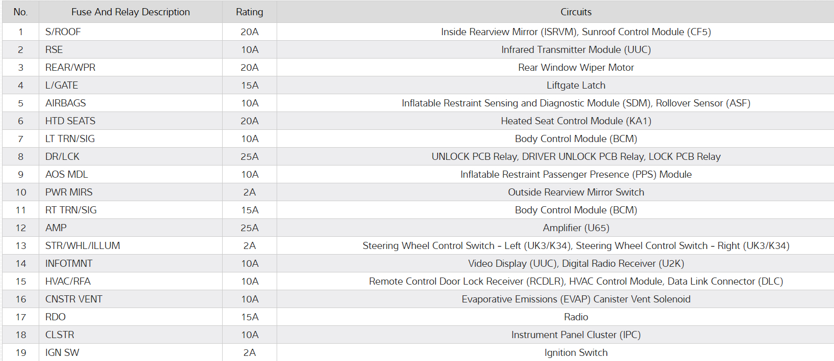

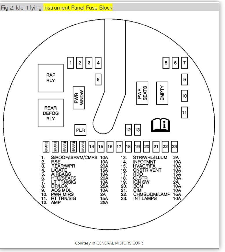

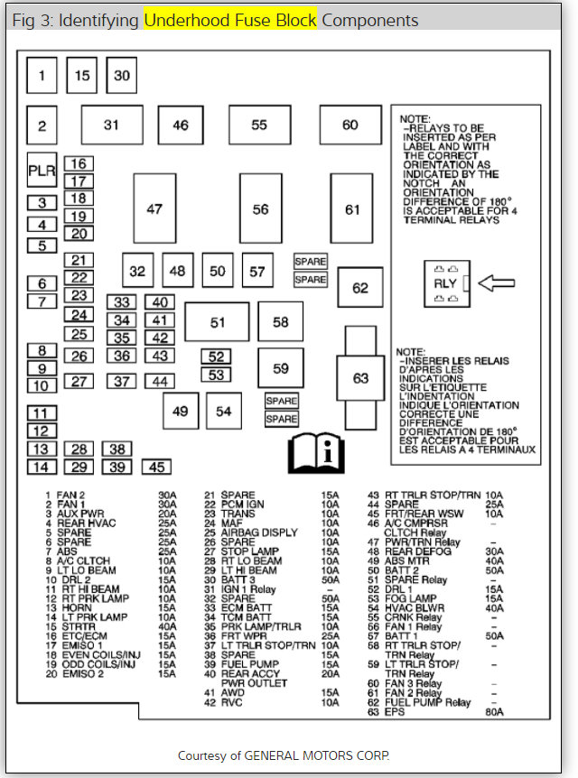

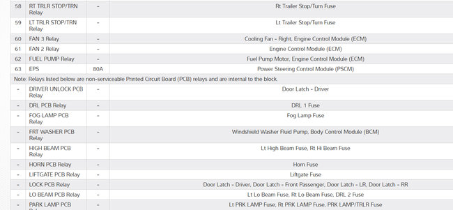

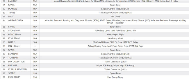

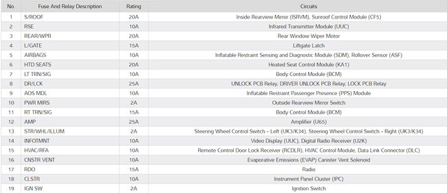

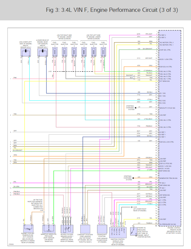

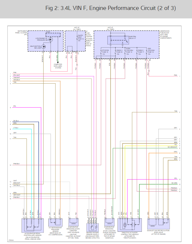

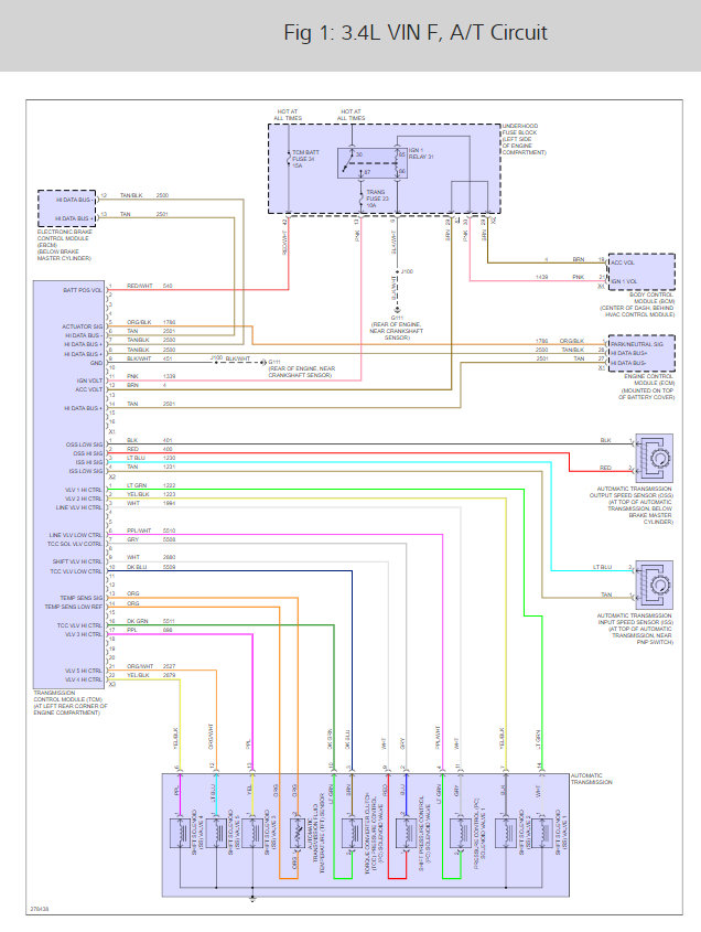

Those transmission and network codes can be a computer problem or an internal transmission problem. Let do a pin to pin check to make sure we are not chasing a connection problem. I see an Ignition relay that can be shorting out which would cause the problem.
and
Here are the engine and transmission wiring diagrams so you can see how the system works and the ignition relay location.
May 15, 2018 at 11:23 AM
VSSOUTLET
  • 57 POSTS
Ken,

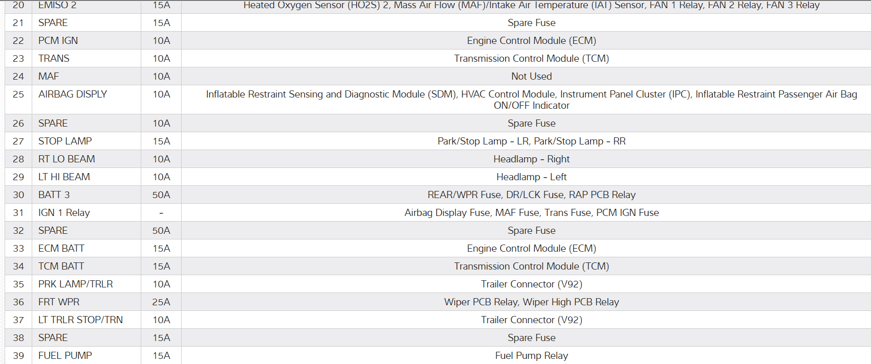

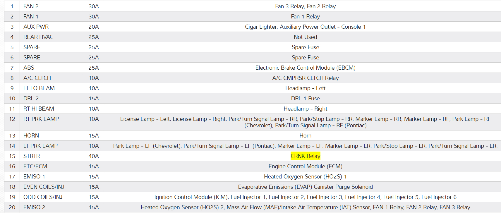

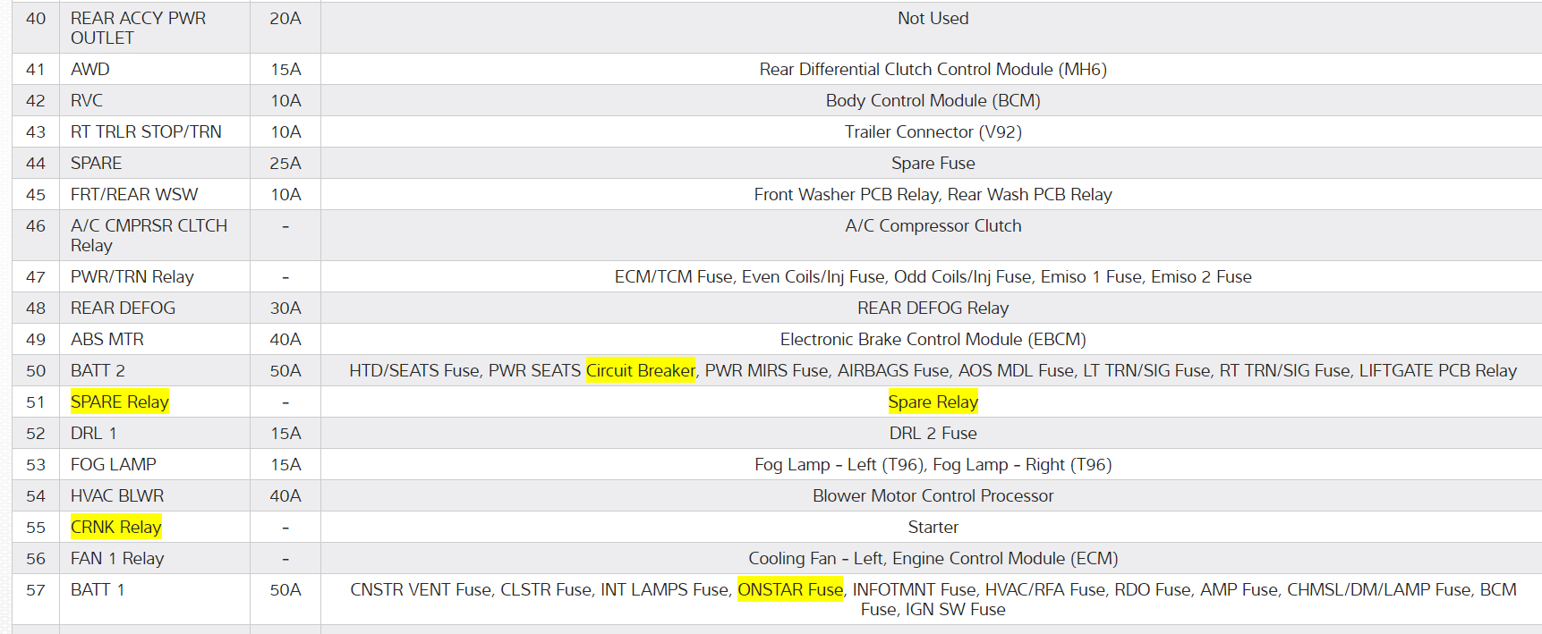

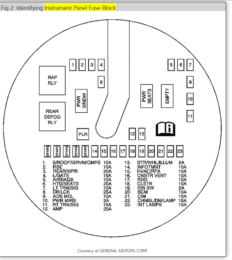

What makes you think it may be the ignition relay? Also, is that number 31 on the fuse block?
Does an intermittent problem suggest something going on inside or outside of the transmission? I am thinking something electrical because crazy things happen like ABS, brake and Stabilitrak going on and off and the gas gauge going nuts. Do you think these lead back to a faulty relay?
May 15, 2018 at 12:41 PM

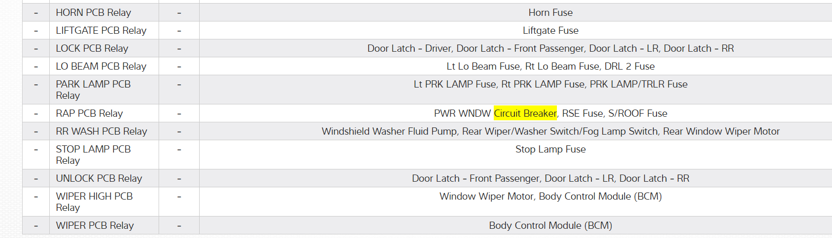

Big time, if the connection is weak or has high resistance (hot) to will stop powering a leg of the computer which will make the communication codes. Can you see if the PCM - IGN fuse has power with the key on? I would also check the power train relay #31 as well as #47.

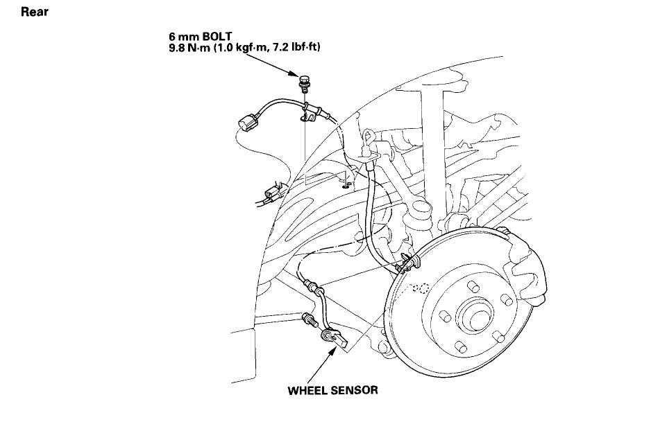

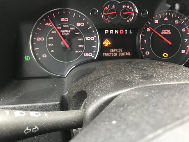

I wanted to update this issue. I fixed the ABS/brake light/stabilitrak issue. It was a broken speed sensor - cracked in half. I managed to fish both pieces out and replace them. No more problems related to that sensor.
However, I am still having the transmission issue. Mechanic says he cannot do anything until the car goes into limp mode while he has it. I cannot force that to happen. The problem is intermittent. Logic tells me that this is more likely to be an electrical than a mechanical problem. If it was mechanical, it would likely be constant and getting worse. I can go days and hundreds of miles without this issue occurring. Then the transmission starts slipping and banging into gear again. A hard bang causes the ETC light to flash on briefly. A few hard bangs and it goes into limp mode. Let it sit twenty minutes or so and it is out of limp mode.
How do I fix this? I am afraid to go any real distance in this car. I attached a screenshot of my scanner results when it was in limp mode.

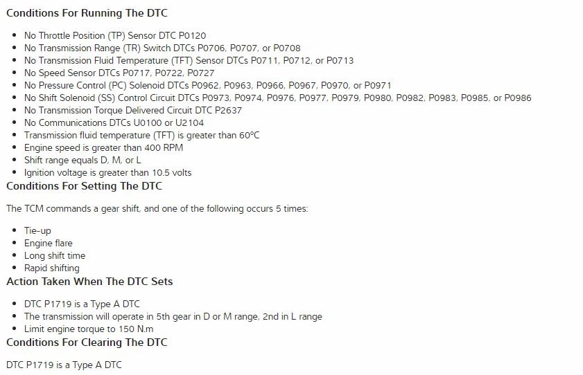

P0700 - Not a "real" code, it is a code to tell you you have a code in the transmission control system. It will pop up on the code readers that cannot talk to the rest of the system.
P1719 - Improper shift detected. This code sets if the TCM detects the conditions in the attached image. The long list on top basically says, everything in the transmission is working fine.
Then you get the flare and banging which is what is in the reasons the code sets.
You say the fluid was checked 3 and changed twice, How was it changed? Through a flush or did they remove the pan and change the filter?
The flare issue is caused by the transmission losing internal fluid pressure and the clutches slip. It could be a bad pressure solenoid or even a chunk of crud floating around in the system blocking a port. Did it start after the head gasket repair or was it going on prior to that? With 104,000 on it there is also the possibility that it is just a worn seal that is failing and a refresh is needed.
