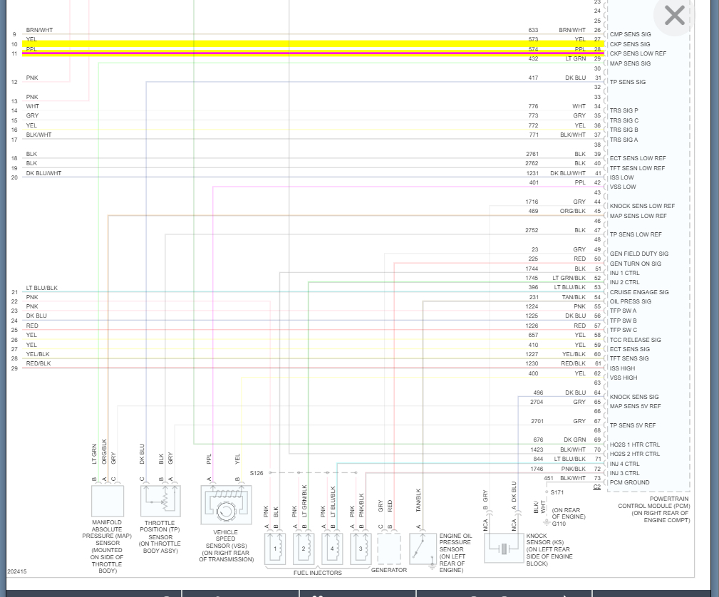

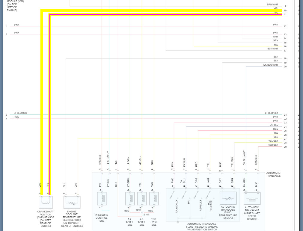

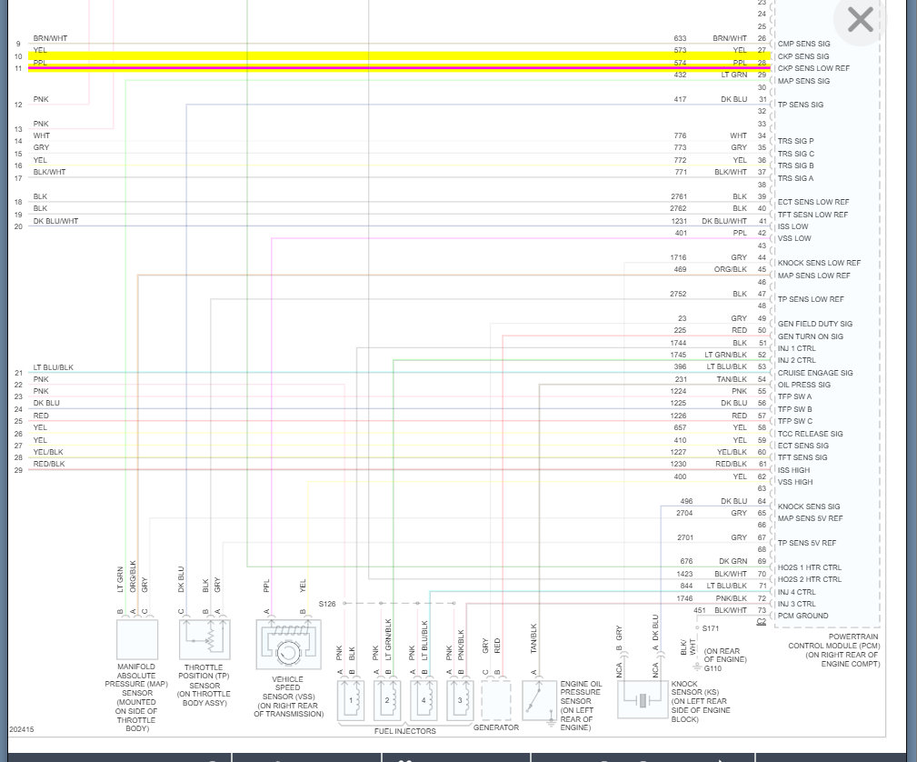

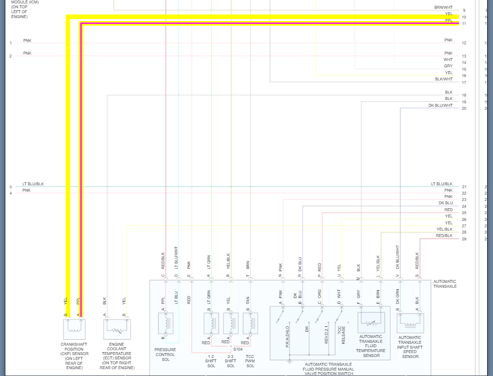

It sounds like you are just losing ignition in the PCM which would be a crank sensor issue.
However, let's run through this guide which addresses this issue with more possible causes.
https://www.2carpros.com/articles/engine-stalls

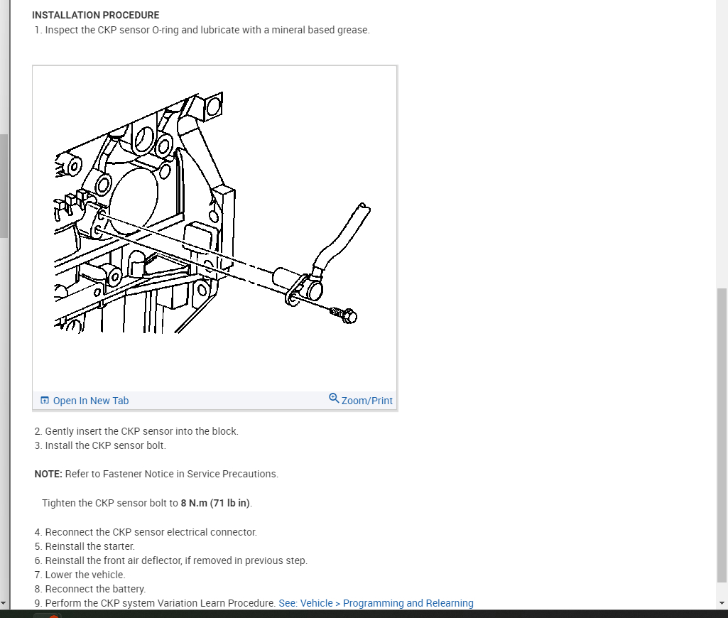

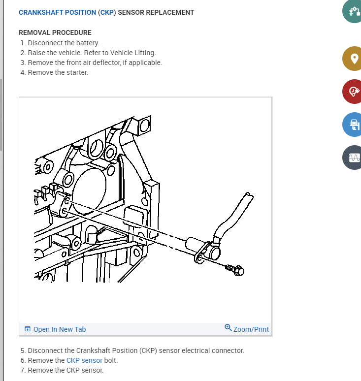

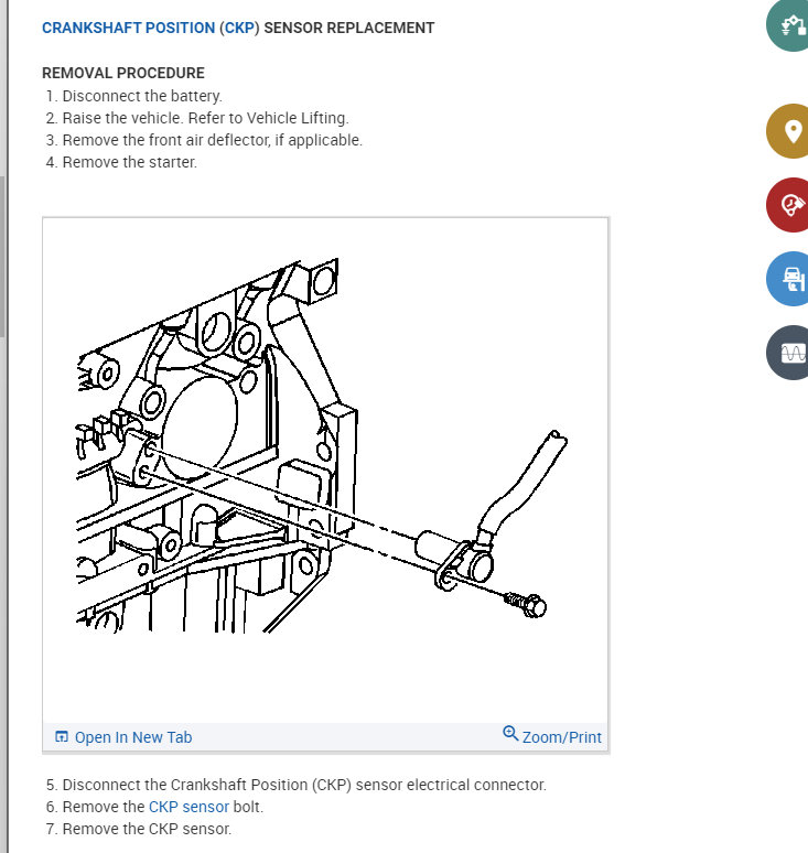

I would suggest starting with the crank sensor and here is a guide that talks about this as well:

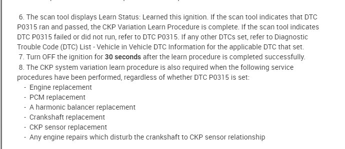

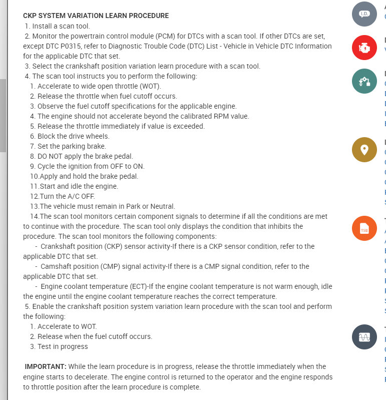

I am attaching the process below on how to replace this and do the relearn process.
Please run through this info and let us know what happens.
