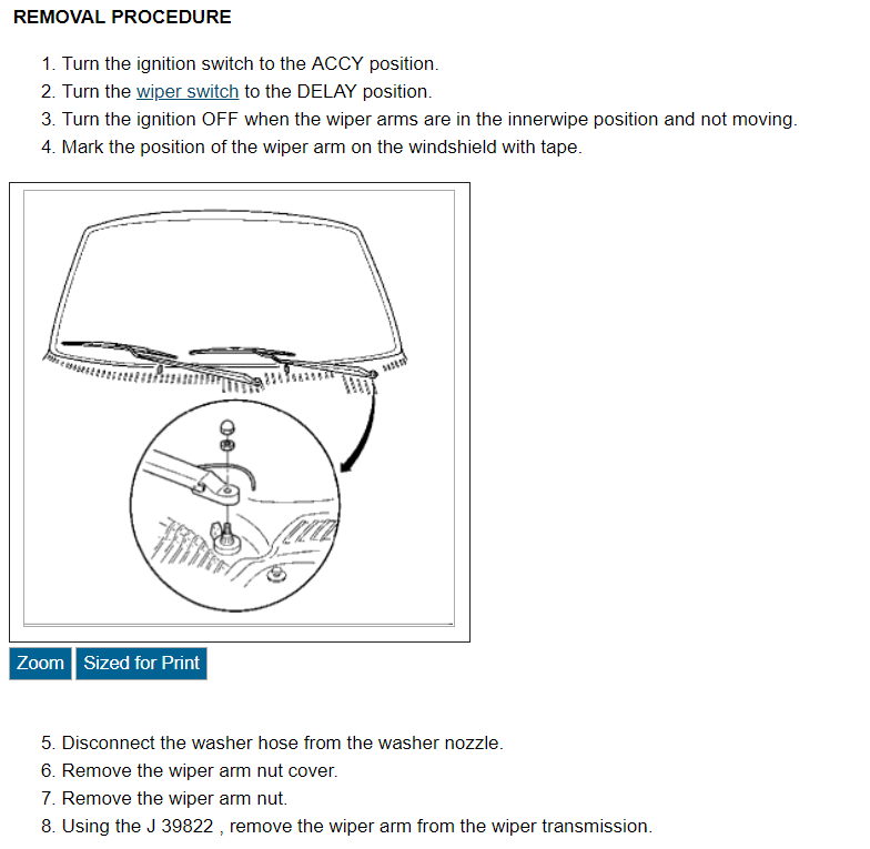

Install the nut so it covers the threads and then apply pressure upward on the arm, take a hammer and lighting tap the nut and pivot downward it should pop off it is tapper fit.
