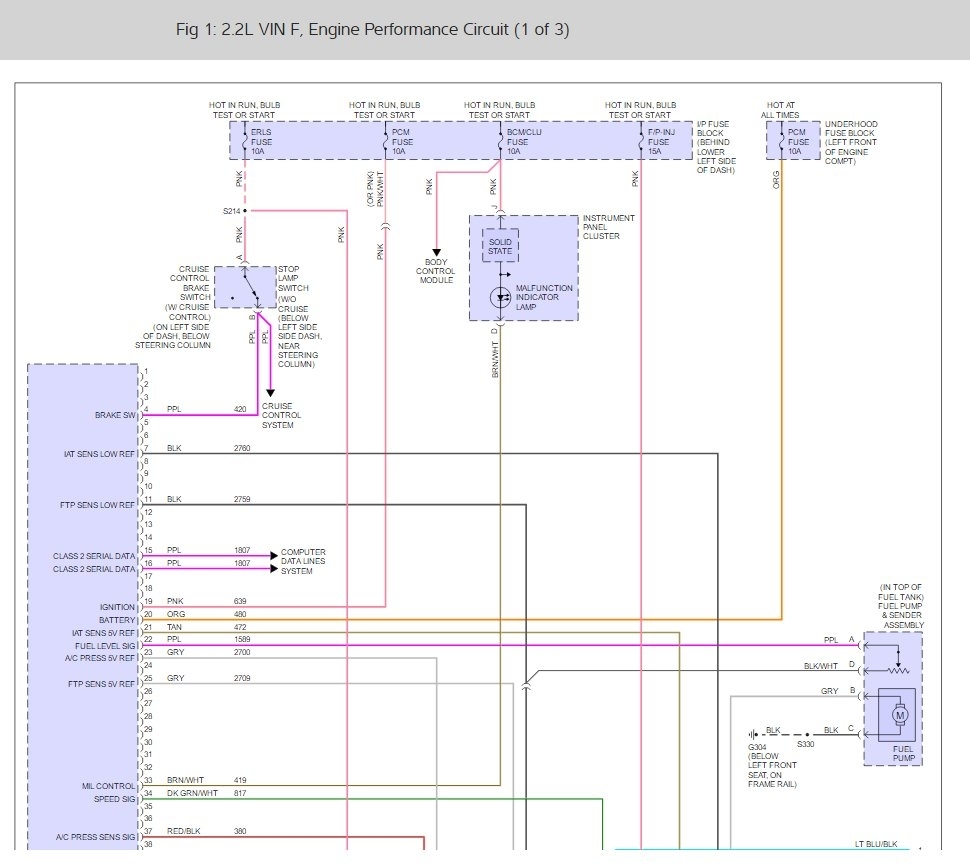

I'd like to know where the fuel pump reset switch is located
Jun 1, 2008 at 10:39 AM

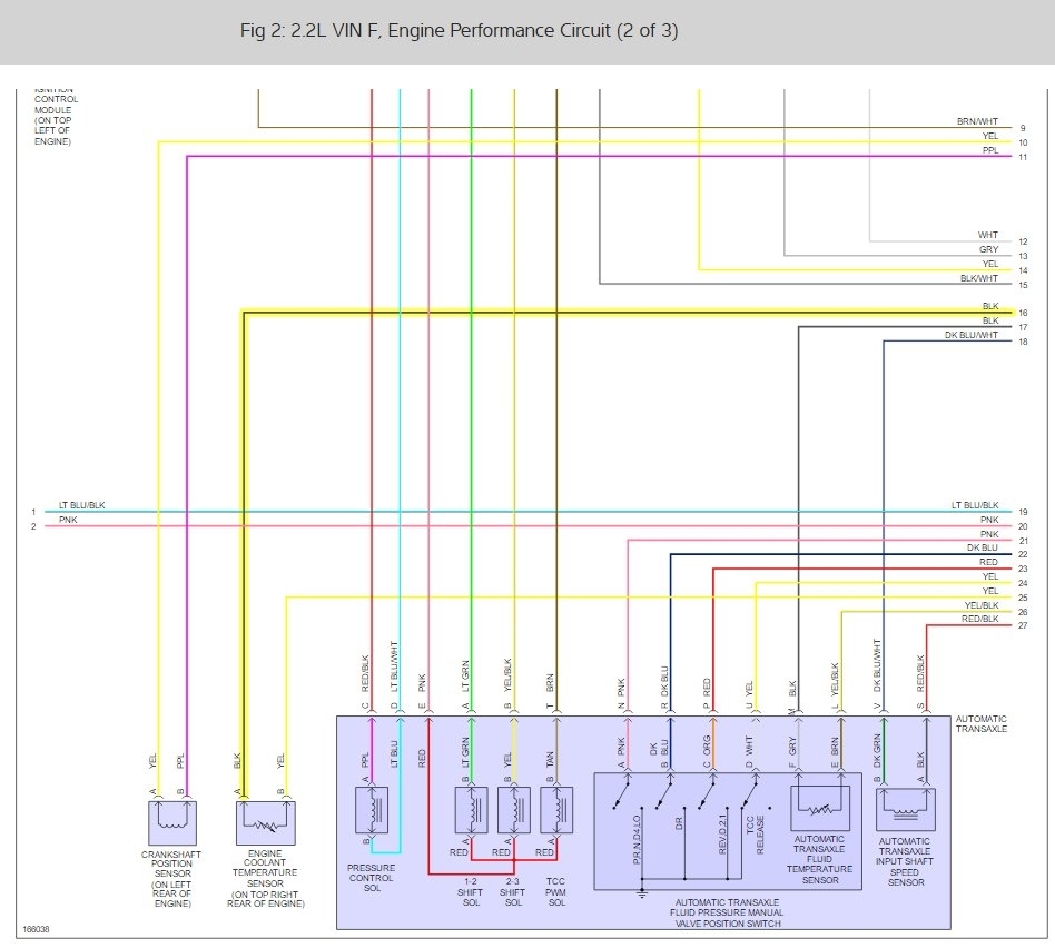

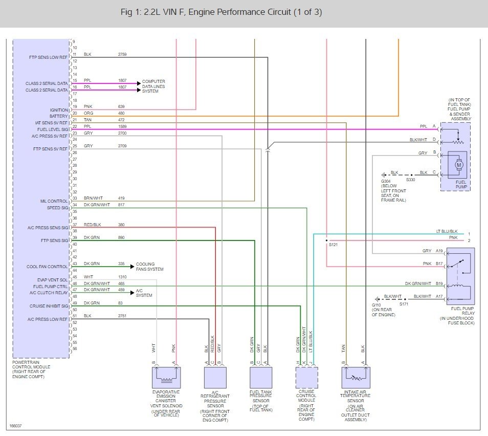

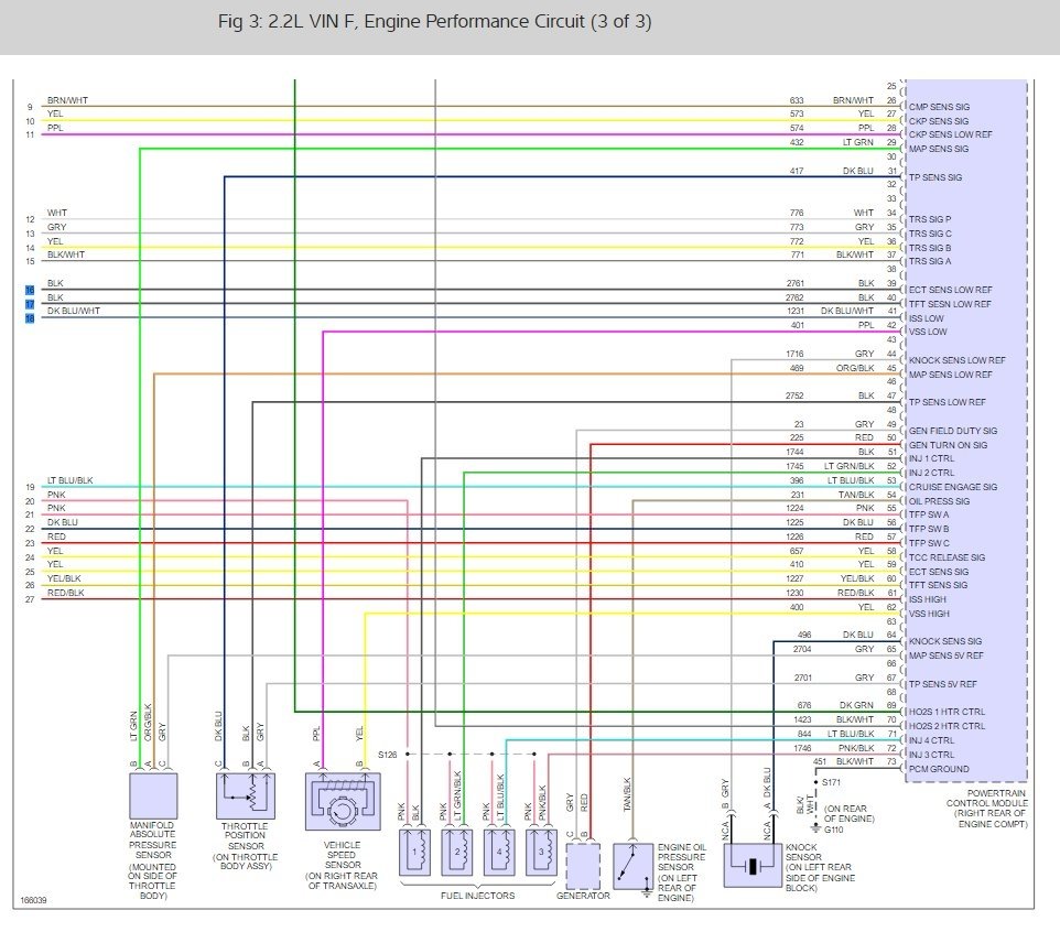

There is no fuel pump cutoff switch for this car. There is a fuel pump relay though, here are the engine wiring diagrams (below) so you can do some testing along with a guide to help you get the problem fixed.
