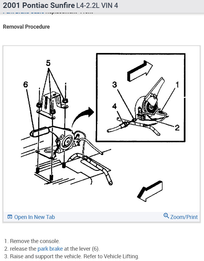

I have taken the middle console out, and traced the parking brake cable from handle all the way to the back brakes and cannot seem to find the spot on it to adjust the cable to tighten it up, if you could help me out it would be great.
Aug 15, 2010 at 6:03 PM
BLUELIGHTNIN6
  • 16,542 POSTS

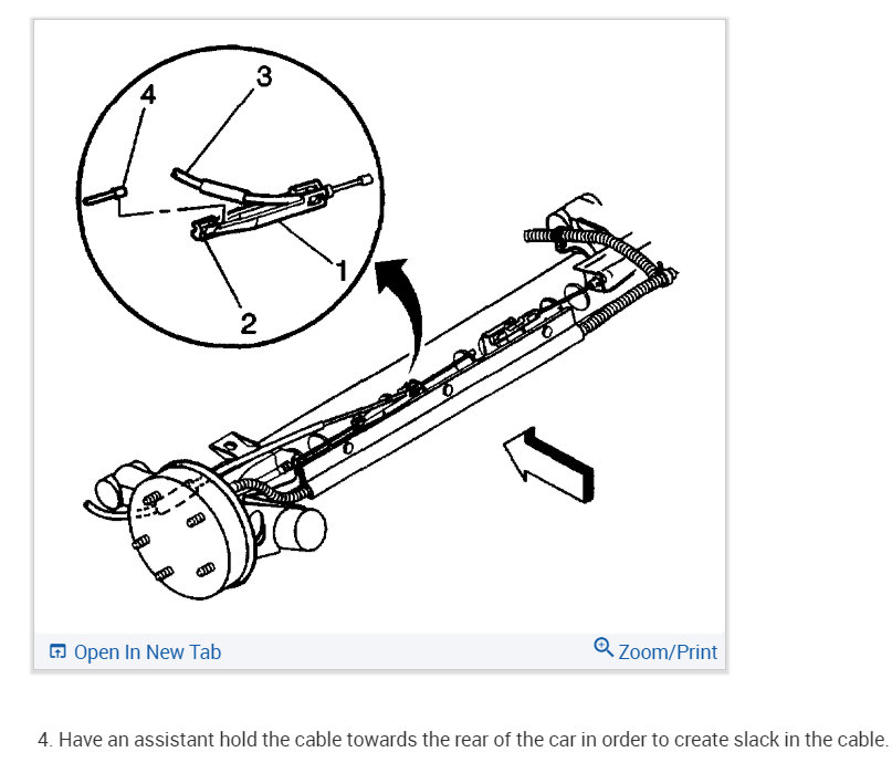

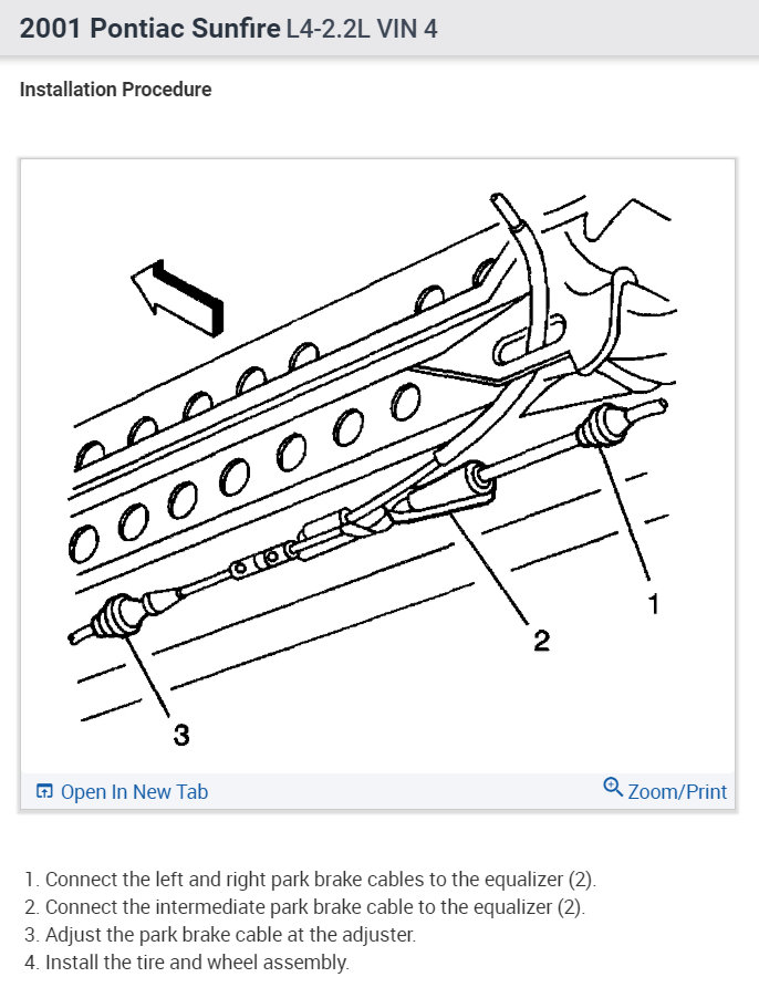

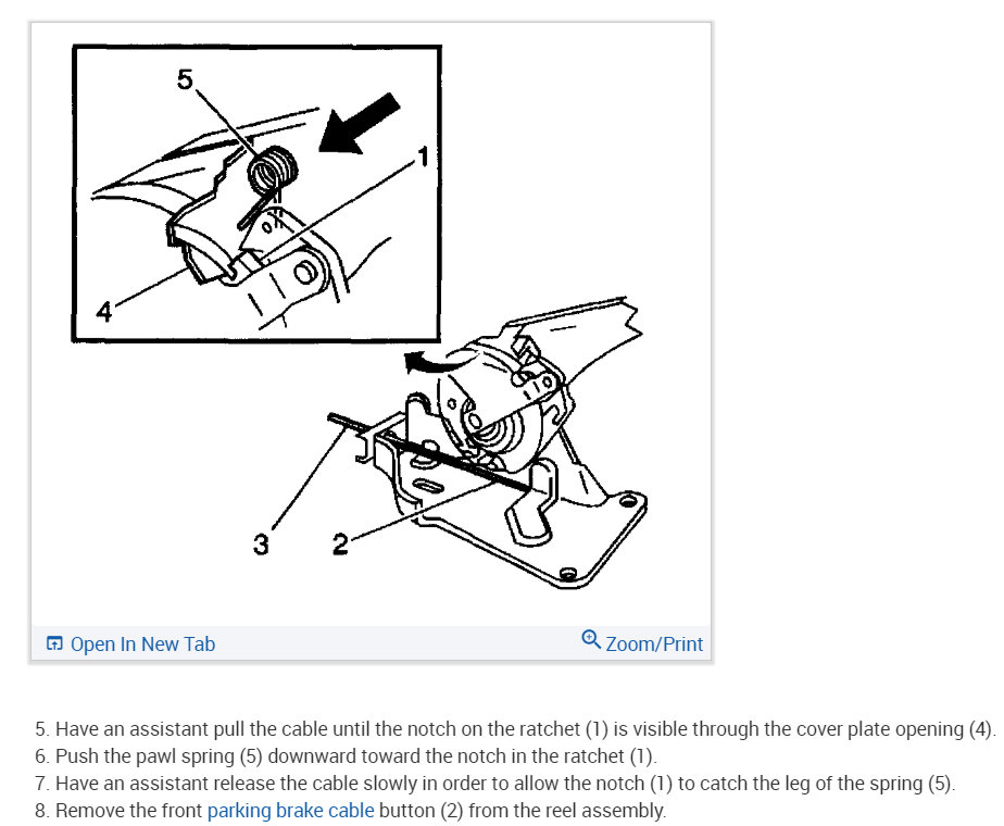

The parking brake adjuster is under the car Here are diagrams below to show you how and where the adjuster is.
Cheers
Aug 16, 2010 at 1:03 AM

The best way to adjust that is to adjust your rear brake's up.Your car will stop better and your ebrake will feel better.
