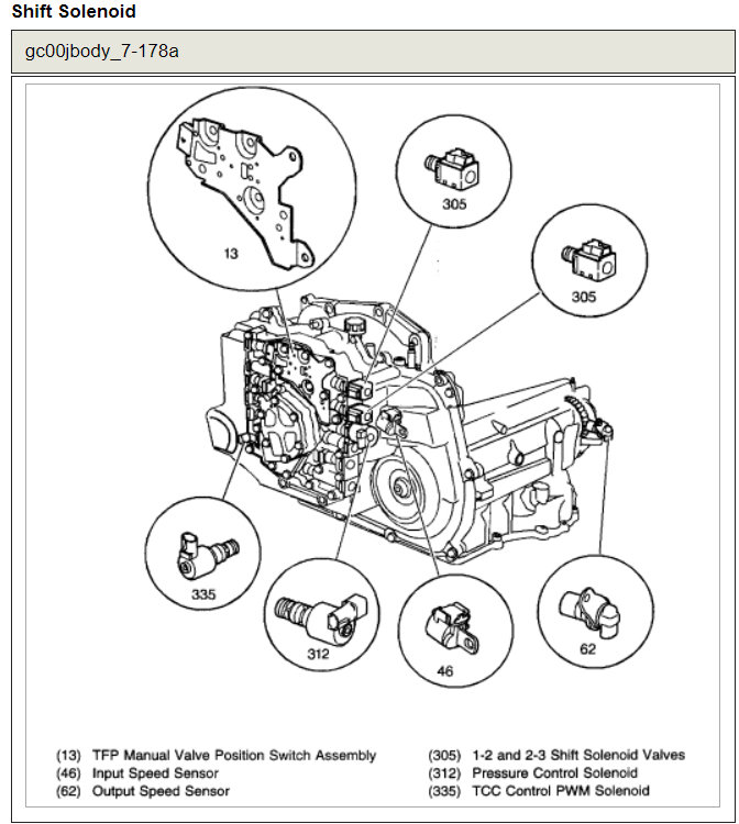

This sounds like a classic shift solenoid failure. You must remove the transmission pan and replace the solenoid. Here is a guide that will give you an idea on how to remove the pan.
You will need to jack the car up
Here is where the solenoids are (below) the pan on the side needs to come off.
