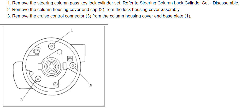

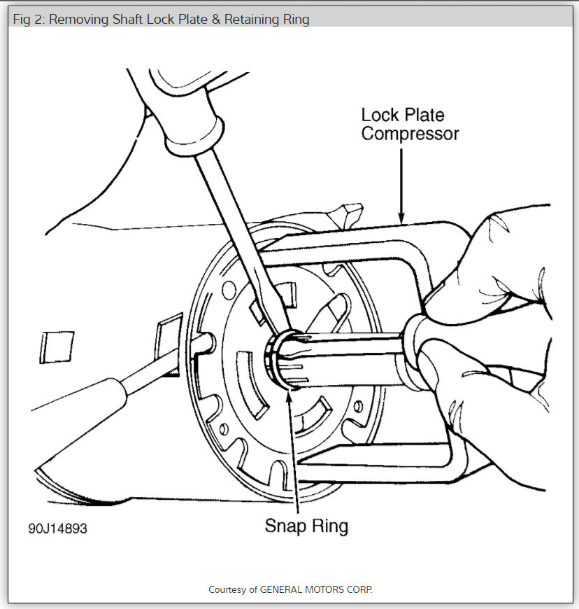

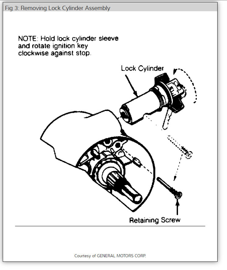

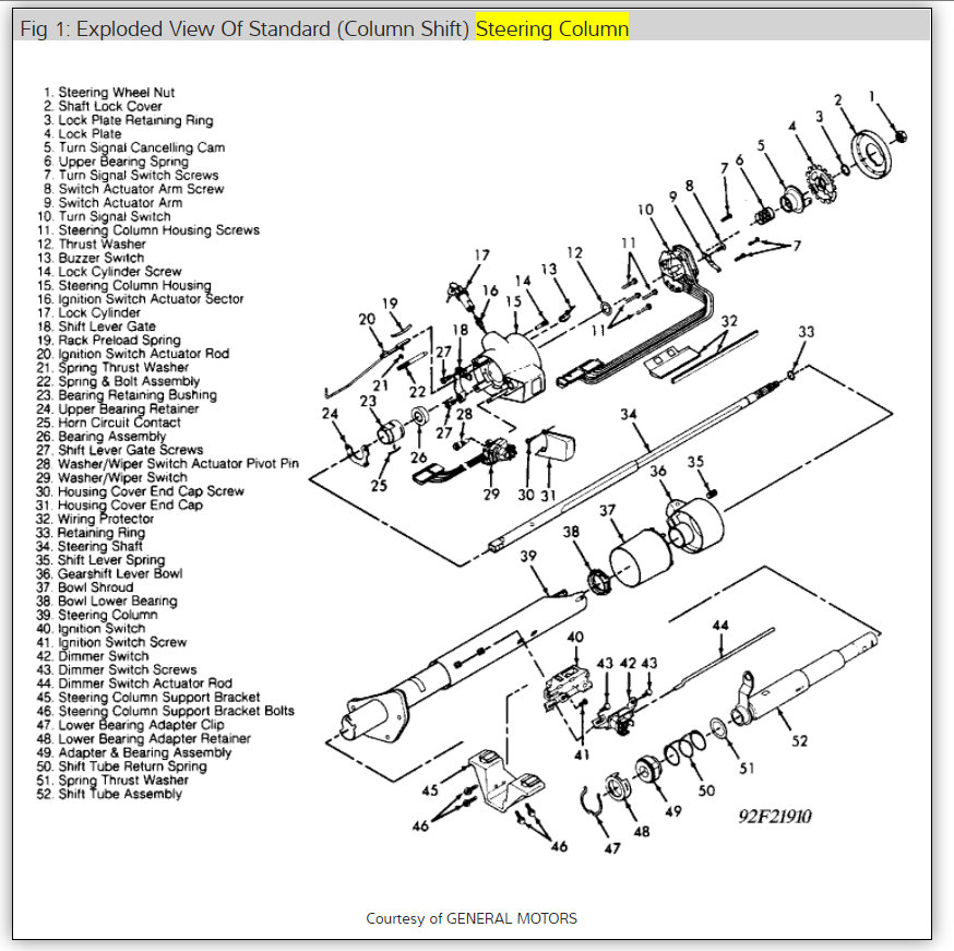

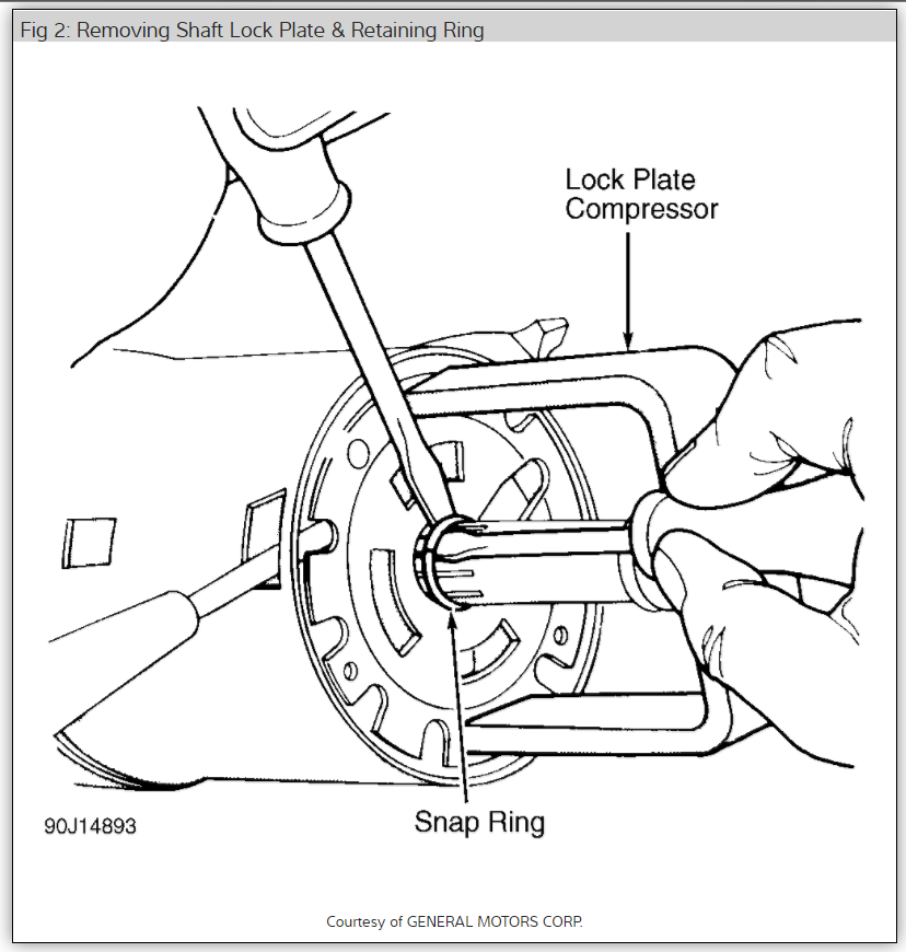

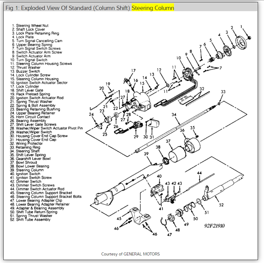

There is two small wires at the ignition switch that break which causes the problem you are describing. I assume you still have the original key? If so here is diagrams to help you see if the broken wire issue is the problem.
Check out the diagrams (below). Please let us know what you find.

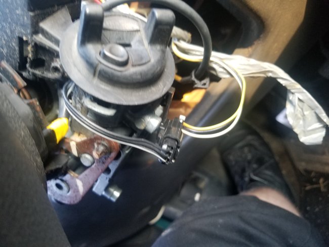

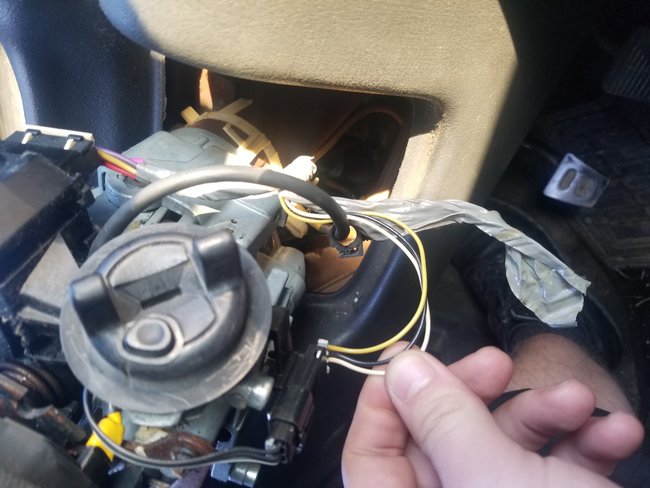

Okay, you said that two wires cause the problem. I talked to a friend of mine that is a mechanic and he told me if there was chip in the key it was most likely the computer and the chip went bad. Luckily there is not a chip. However, you described two wires that cause the problem, but how do I fix the two wire issue and which two wires? I looked at the diagrams and only see mechanical components. I did not see the wires you were talking about in the diagrams. I do have pictures of wires. I took the plastics off around the steering wheel and I see a white black and yellow ignition wire that runs to a quick connect and the other side of the disconnect that runs into the ignition area looks like it is two black wires and a white wire. Is the black and white wires the one's you were saying went bad? I will will post the pictures.
Jul 8, 2021 at 11:32 AM (Merged)
Yep those are the wires do they look in good shape? They look good from here. Lets try resetting the system. Please follow this guide.

The wires you were talking about are they the ones I was holding of the black and white? Could it be a short in the wire? I am going to try the reset that you gave me when I get off work and I will let you know how that goes.
The wire will be broken inside which you can feel if you move the wires around but from the picture they look okay. Double check to be sure though.

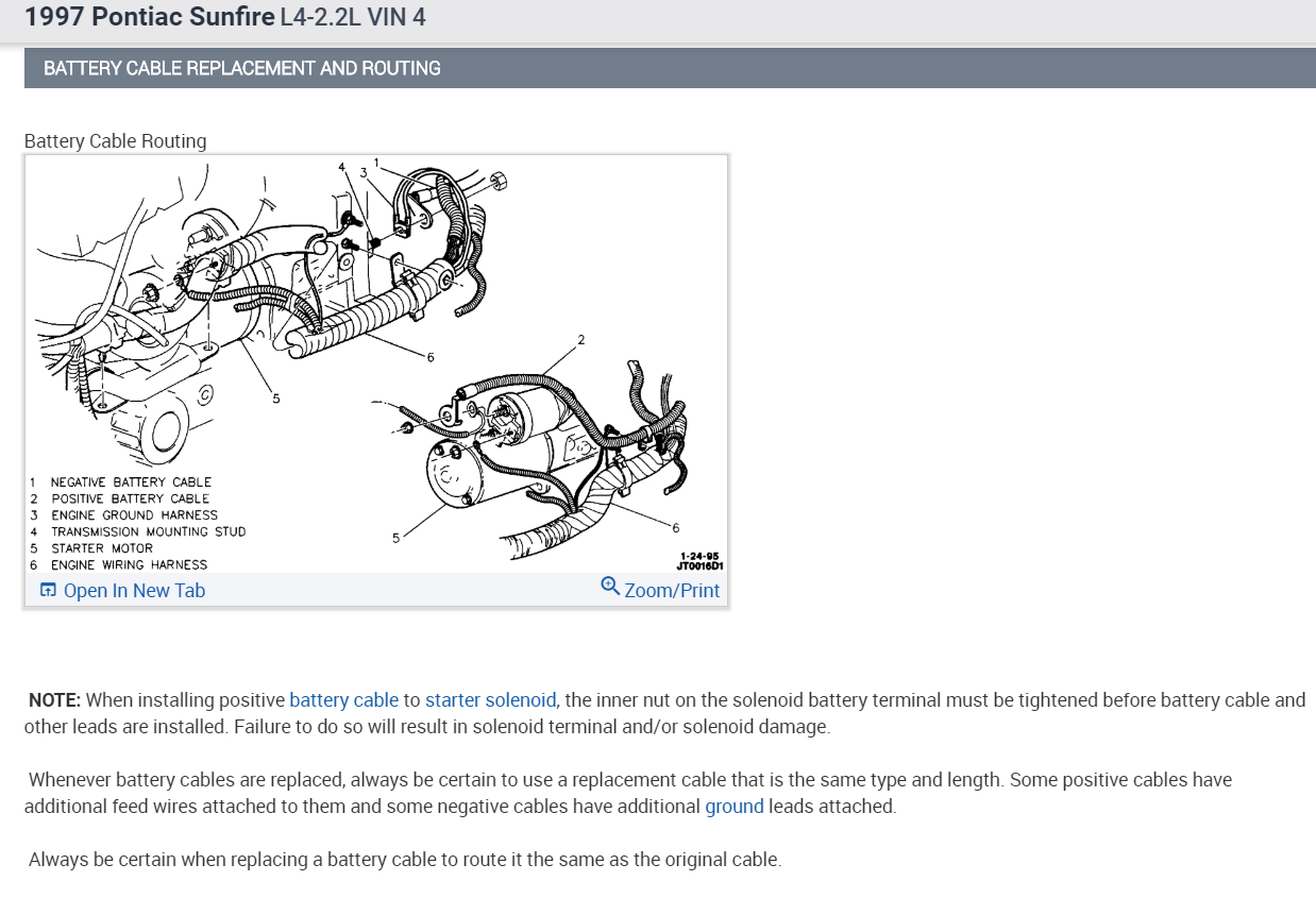

I tried. But the car kept turning on and staying running. I figured maybe it stopped doing that problem so I drove it to work last night and it would not start when I went to leave for work so I sat there for about ten minutes and tried again and it started. It makes no sense. I did notice every time I push the clutch in the radio turns off and the headlights get dim. When I shift and let off the clutch the headlights go back to normal and radio turns back on.
Great clue, I would check the battery ground to frame and engine block to make sure the connection are good and tight. You must have both block and frame or the car will have issues. Here is a diagram.

I checked all the grounds nothing seems wrong. Everything looked right from what I can tell. But I figured out how to start it every time without fail. Sometimes it will still shut off. Turns on runs for two seconds and shuts off. When that happens I take the key out of the ignition. Put it back in and as I turn on the car I press the gas and it fires right up and stays running every time. I do not get it. I am baffled on what it could be.

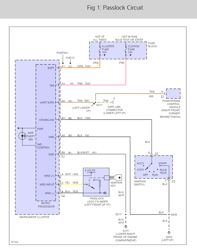

It could be the cluster here is a wiring diagram of the system so you can see how it works. You might need a rebuilt cluster. Here is a video showing her job being done on a similar car:
