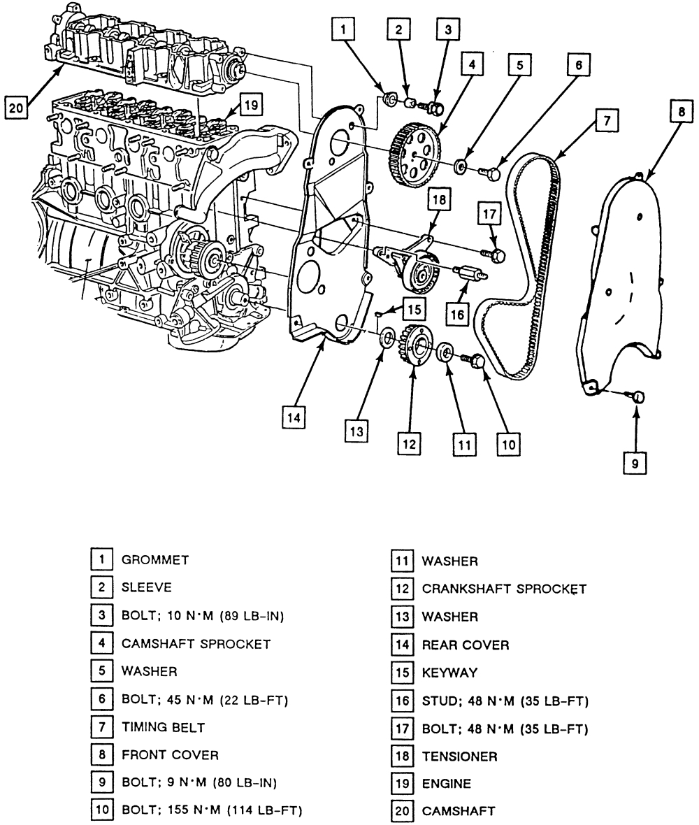

Also, here is a diagram of the timing belt and related components to give you a better idea. The bottom pulley is the crankshaft pulley.The water pump is attached to the engine and not labeled.
https://www.2carpros.com/images/question_images/199382/original.jpg
