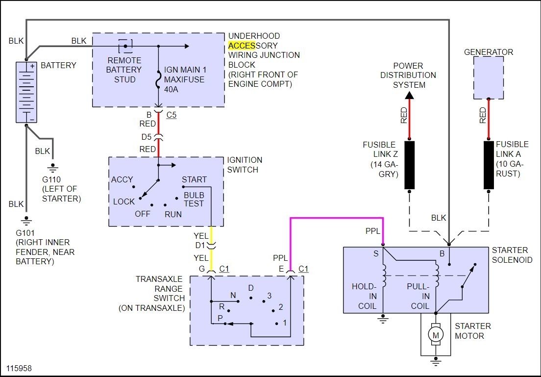

We tried to start it with the old battery and it would not start. We jumped it and it worked fine until we parked it. Then it did not start again. We replaced the battery and now even a jump start will not make it run. It will not even crank. The people at AutoZone said they tested the alternator and starter and said they were good.
