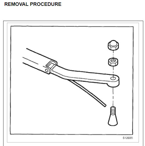

Take a garden hose and spray it at the windshield you will be able to see the water leak which will probably need to reseal the entire windshield which means replacement. Here is how you remove the wiper arms.
Pull upward on the arm while tapping on the pivot shaft.
