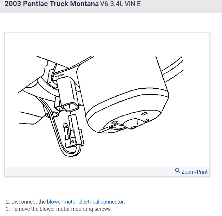

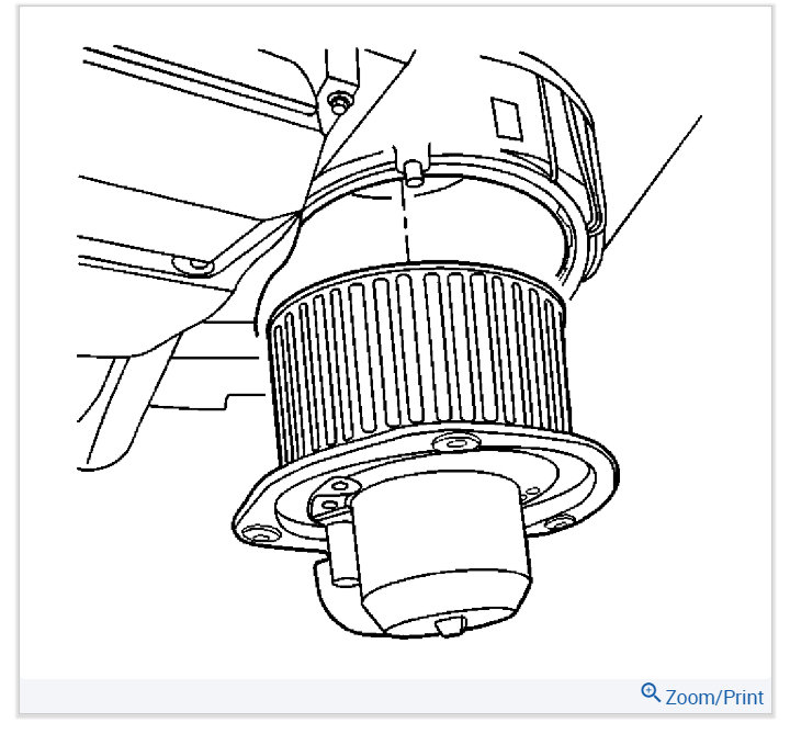

This sounds like the blower motor when out but to be sure lets run down this guide which shows how to test and replace the blower motor with diagrams below for how it can be done on your car.
https://www.2carpros.com/articles/blower-fan-motor-works-on-high-speed-only
Check out the diagrams (Below). Please let us know what you find. We are interested to see what it is.
Cheers

Thank you so much for this post it was the blower motor for me cost $56.00 all fixed!

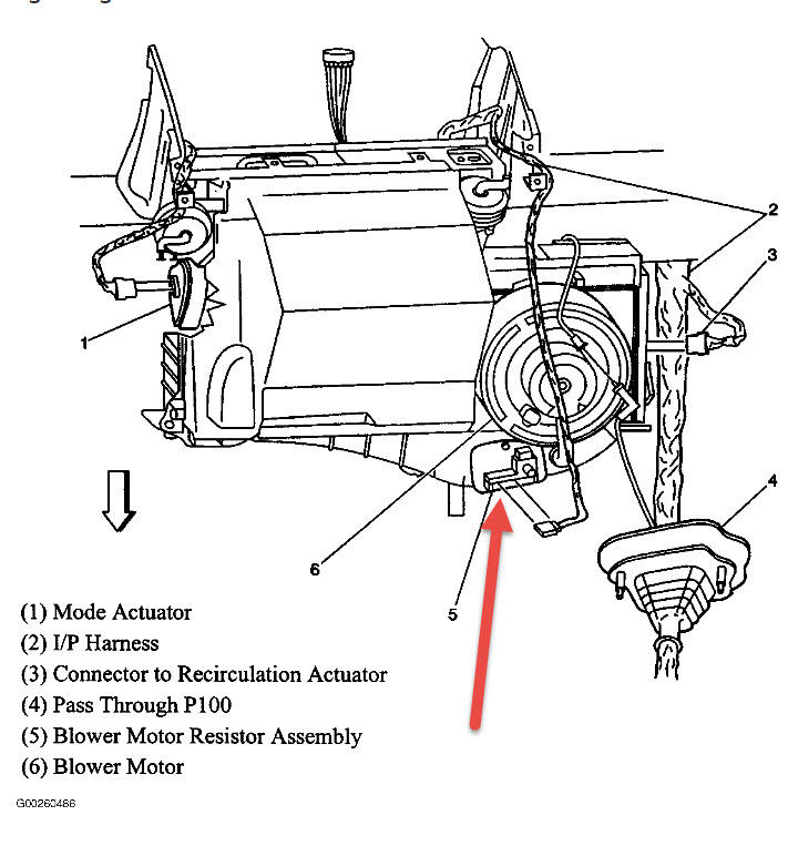

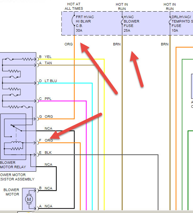

The front fan motor doesn't work but the back fan motor works fine. I can fill air when driving down highway.
Aug 17, 2018 at 2:03 PM (Merged)
HMAC300
  • 48,601 POSTS
check relay and resistor in pics I tmay be the control though which would have to be scanned by a pro.

My A/C and heater blower has stopped working on settings 1, 2, and 3 only. It still works fine on settings 4 and 5 on the dashboard controller dial. Can this be fixed?
Chances are the blower motor resister is bad. Have you tried replacing that? There is also a relay that can cause this, but my first guess is the resister.
