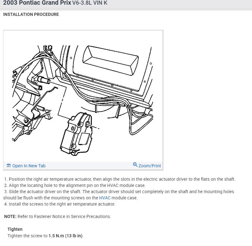

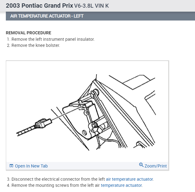

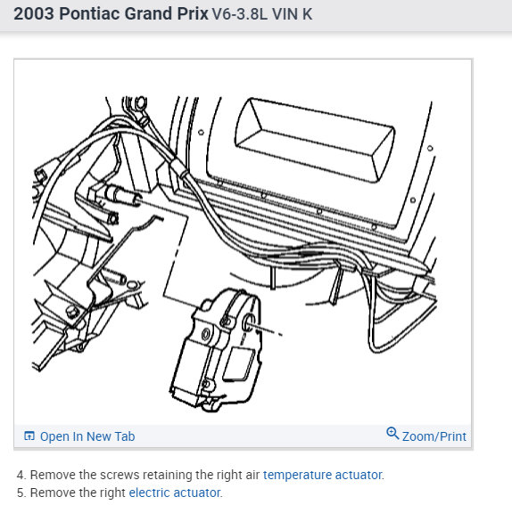

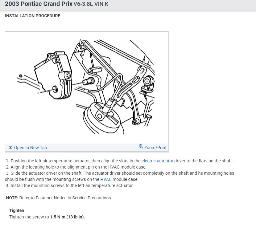

There are a few reasons why the heater might not work.
It could be due to low coolant, clog in the heater core, the engine not warming up properly, faulty blend door actuator.
Take a look at this helpful guide:
https://www.2carpros.com/articles/car-heater-not-working
Here is a guide on how to flush the cooling system:
https://www.2carpros.com/articles/coolant-flush-and-refill-all-cars
Please take a look at these guides and let me know if you have any questions.
