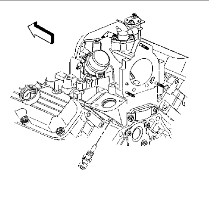

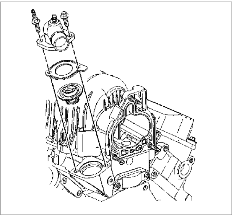

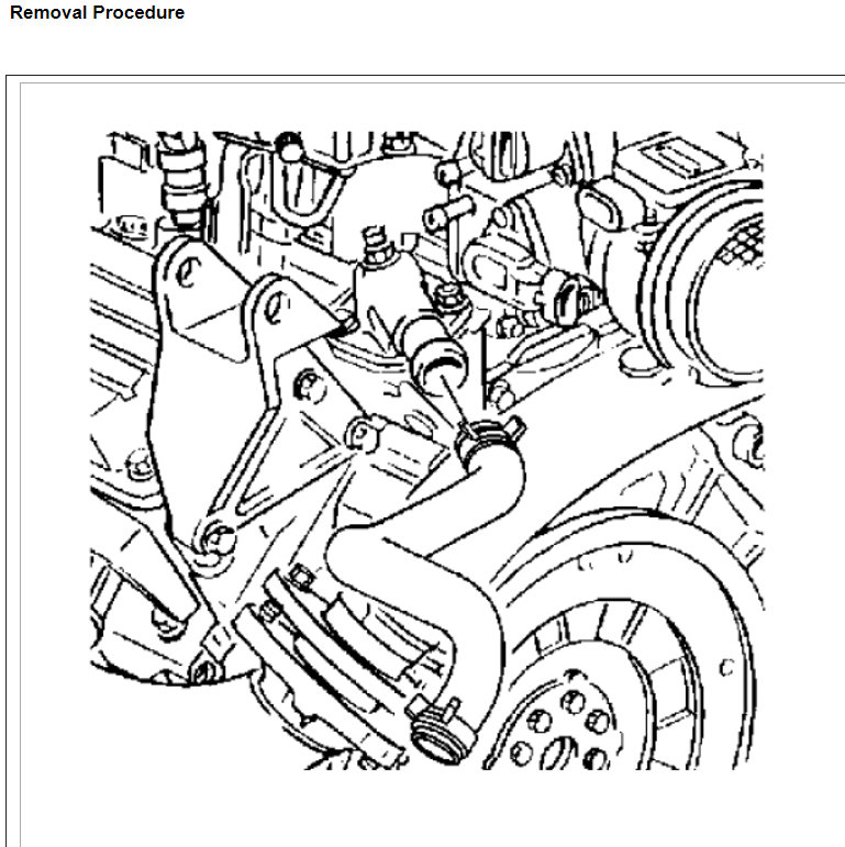

temperature gauge quit working. It still cycles on and off when you first crank the car. Then stays in the off position.
May 11, 2009 at 9:33 PM
It sounds like one of two things maybe happening. Fist is the temperature gauge is working fine and it is a thermostat that is stuck open causing the engine to run cold or you have a temperature sensor that has gone out.
Here are guides to help us confirm the problem and get it fixed.
and
https://www.2carpros.com/articles/coolant-temperature-sensor-cts-replacement
Here are how the jobs are done on your car (below)
