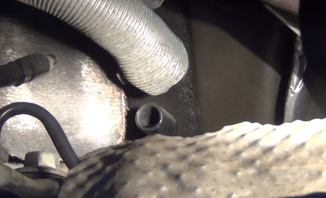

Need to locate the a/c drain tube to remove moisture build up

This drain tube is usually located on the firewall, passenger side behind the engine. Look for a rubber hose that is sticking out,, here is a picture of one in the next post.

Here is the drain this video will show you how to find it
https://youtu.be/q9_MZiS2_NE
