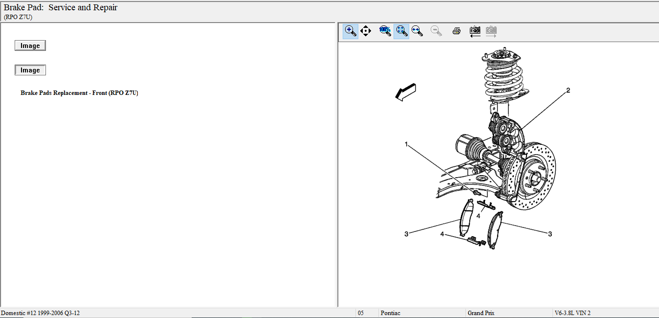

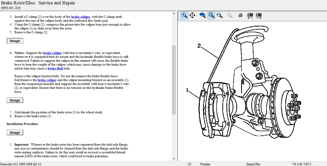

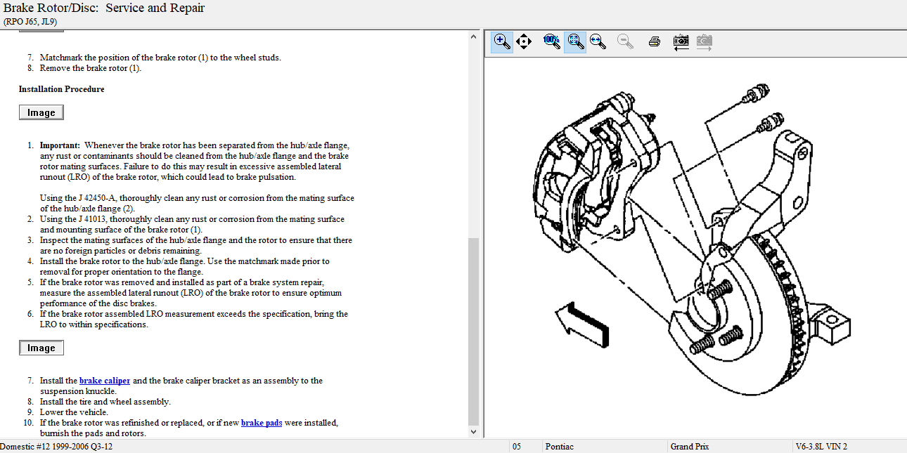

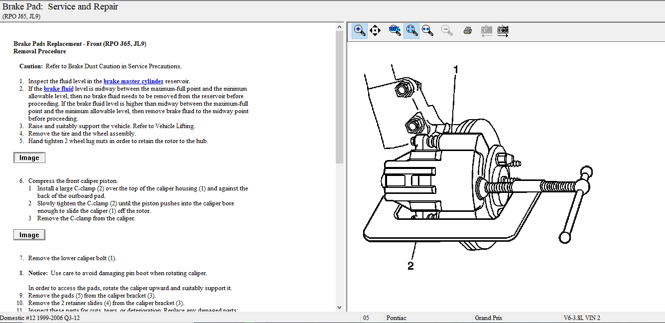

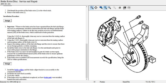

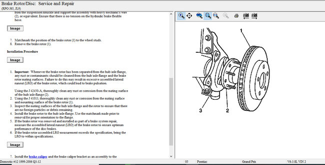

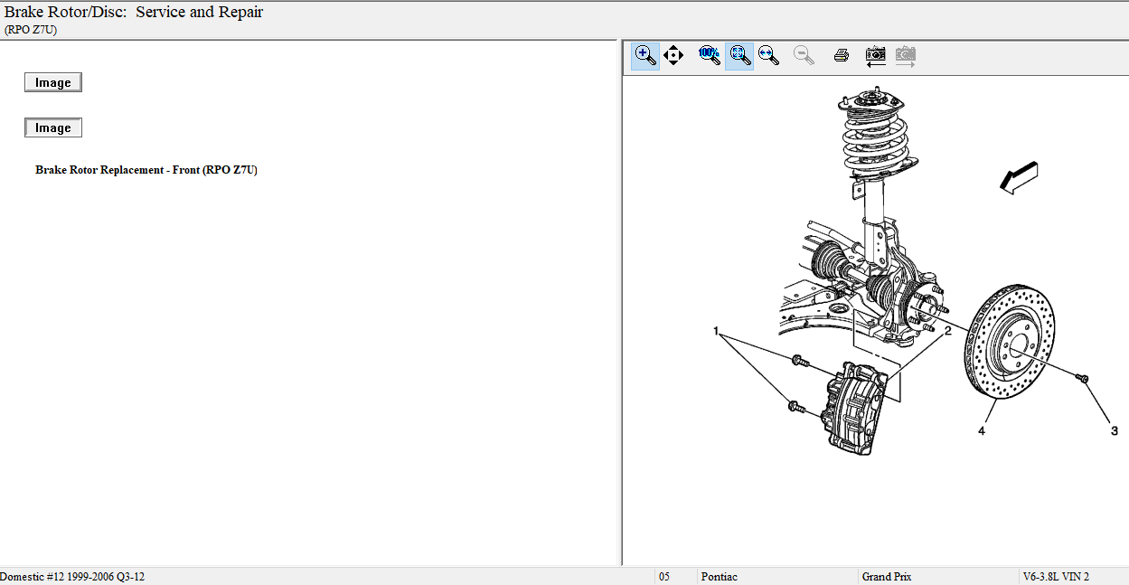

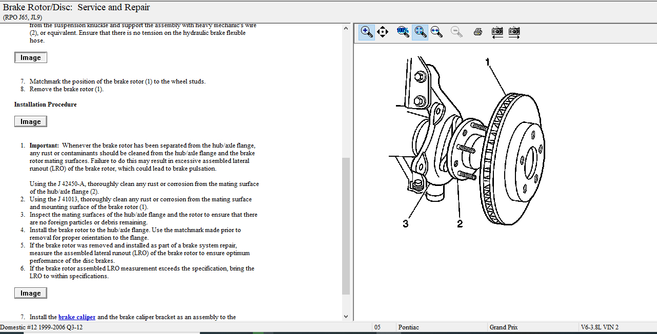

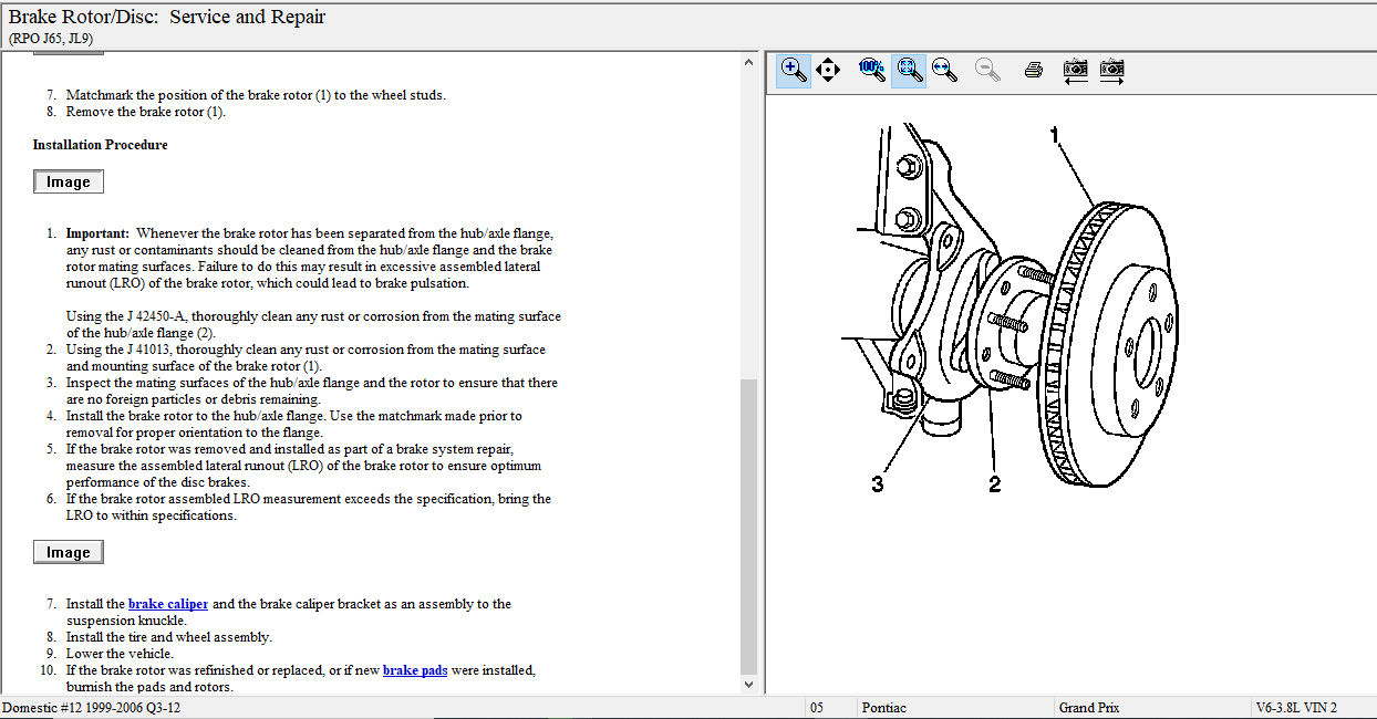

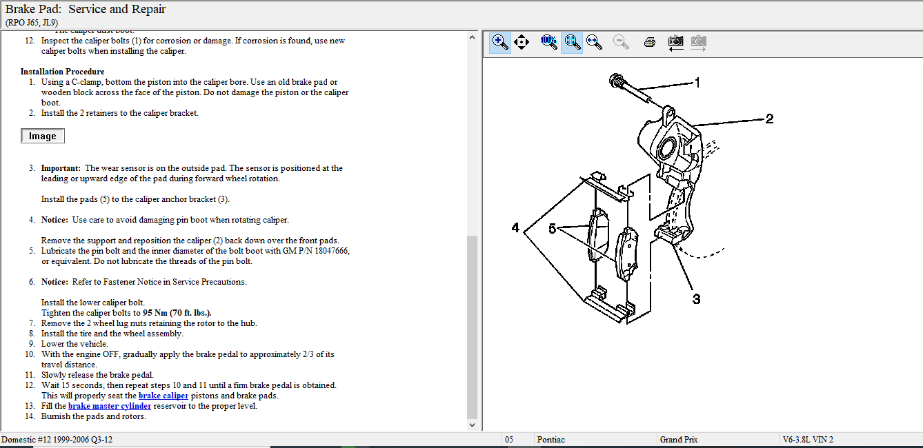

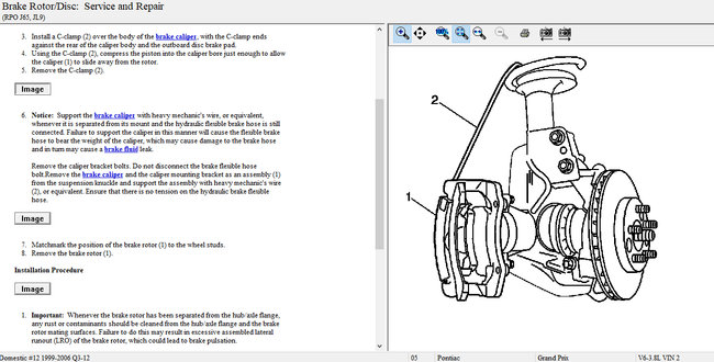

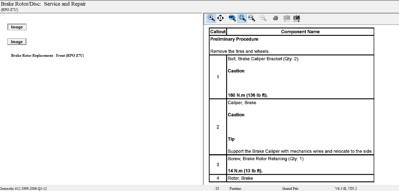

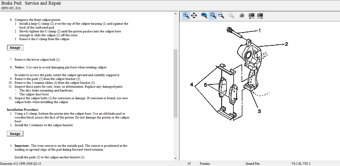

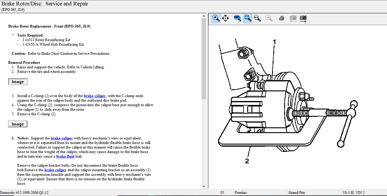

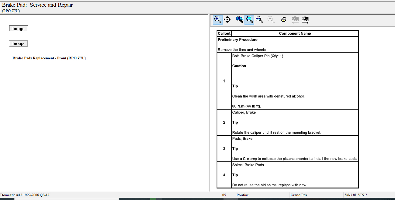

hello,
Check our guide below how to replace front brake pads and discs.
Check the diagrams below procedure how to replace front pads and brake discs.
hope these helps.
