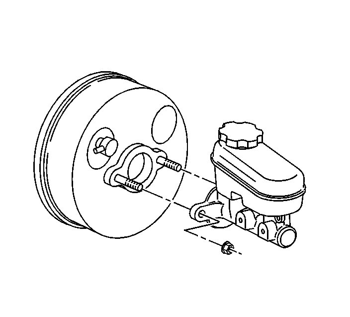

There are two bolts that hold the brake master cylinder to the brake booster. Take a look through this link. It shows how in general one is replaced. You can use this as a guide. It also explains bench bleeding a new master cylinder which will need done.
Here are the master cylinder installation instruction you have requested. Here is a guide to help you step by step with instructions in the diagrams below to show you how on your car.

Here are the directions specific to your vehicle. The pics below correlate with the directions.
Caution: Refer to Brake Fluid Irritant Caution in Service Precautions.
Notice: Refer to Brake Fluid Effects on Paint and Electrical Components Notice in Service Precautions.
1. Disconnect the electrical connector from the brake fluid level sensor.
2. Disconnect the brake pipes from the master cylinder.
3. Important: Install a rubber cap or plug to the exposed brake pipe fitting ends in order to prevent brake fluid loss and contamination.
Plug the open brake pipe ends.
4. Remove master cylinder mounting nuts.
5. Remove the master cylinder from the vehicle.
6. Drain the master cylinder reservoir of all brake fluid.
Installation Procedure
1. Bench bleed the master cylinder.
2. Install the master cylinder to the vacuum brake booster.
3. Notice: Refer to Fastener Notice in Service Precautions.
Install the master cylinder mounting nuts.
Tighten the master cylinder mounting nuts to 33 Nm (24 ft. lbs.).
4. Remove the plugs from the brake pipes
5. Connect the brake pipes to the master cylinder.
^ With ABS tighten the brake pipe fittings at the master cylinder to 30 Nm (22 ft. lbs.).
^ Without ABS tighten the front brake fittings to 27 Nm (20 ft. lbs.).
^ Without ABS tighten the rear brake fittings to 25 Nm (18 ft. lbs.).
6. Connect the electrical connector to the brake fluid level sensor.
7. Bleed the brake system.
