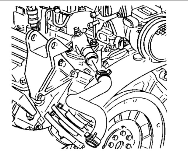

Here is what it will be lie on your car (below):

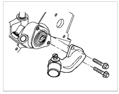

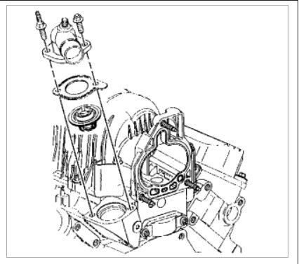

Tighten the water outlet housing bolts to 25 Nm (18 ft. lbs.)

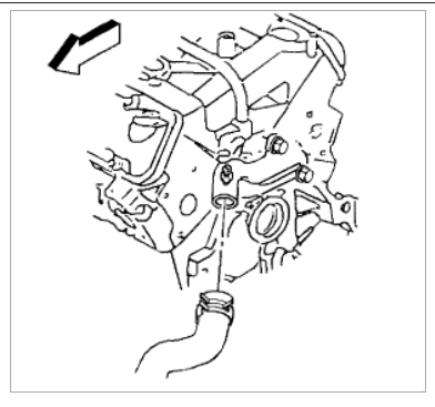

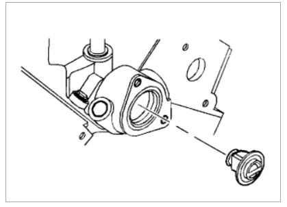

Check out the diagrams (below).

if you have a 3.4 l engine it is located under the throttle body. just follow the upper radiator hose to engine, the part it connects to is the thermostat housing. hope this helps. remember feedback and votes for me are greatly appreciated

Your thermostat is located right next to the throttle body towards the front of the car. You need to remove the injector cover to get to it.
You have two radiator hoses. One goes to the water pump, the other goes to the thermostat housing. Follow the hoses and you'll find your thermostat.

On GM V6 engines they are on intake manifold, follow upper hose to thermostat housing.
