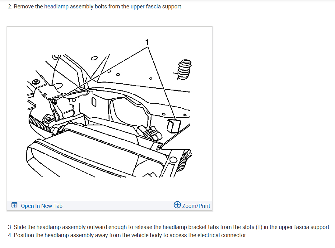

How in the world do I get at the headlight bulb plug on the drivers side of this car??...
I can see the plug where the unit goes into the lens, HOWEVER,, the is NO room to unscrew and unplug the connector to remove old bulb and install new bulb...how do I get at it?? Do I have to take the entire front end apart???

You have to pull the lens slightly out just enough to access it from the outside side ot the car.

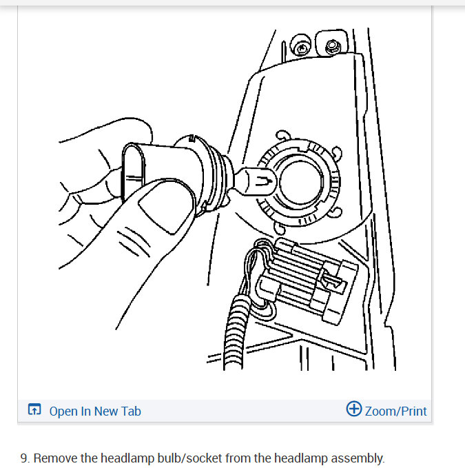

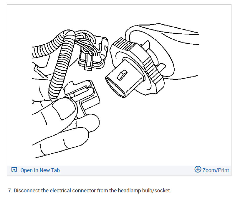

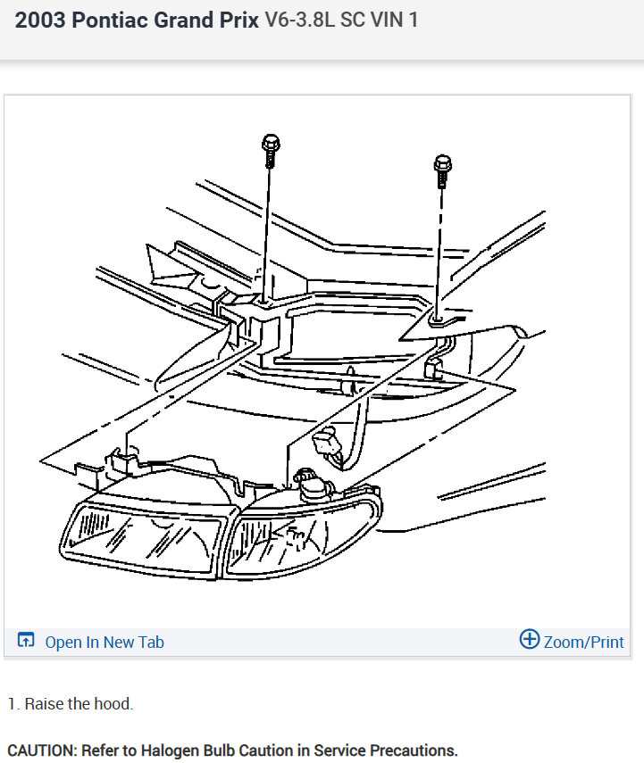

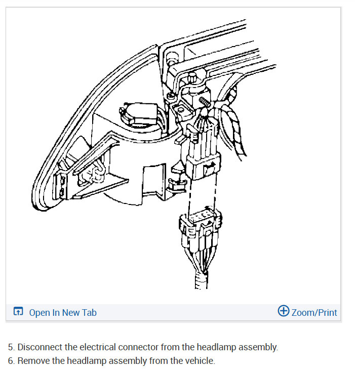

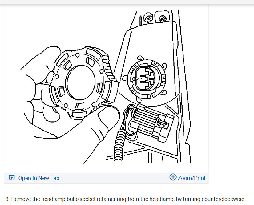

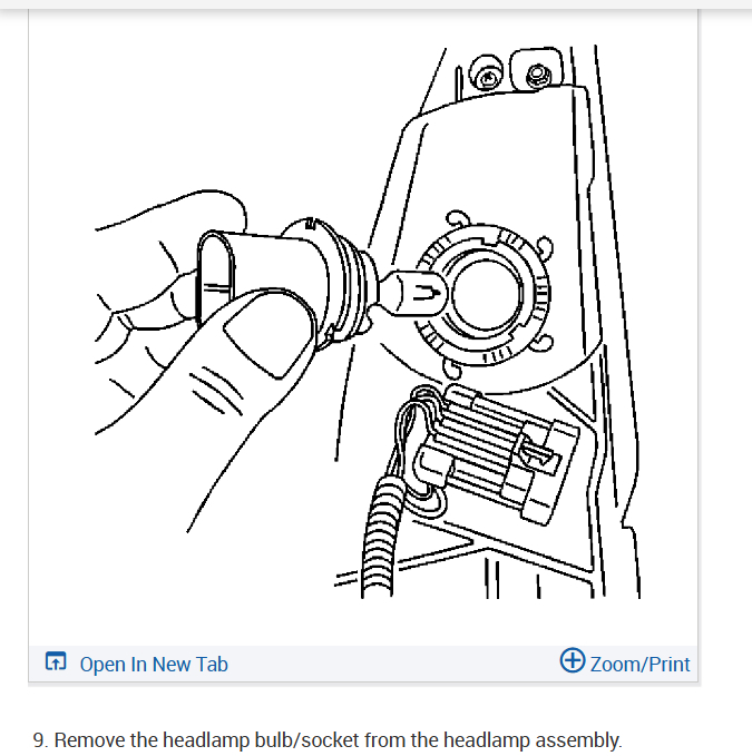

I agree with AMCGUY, here is how to change out the headlamp bulb. Check out the images (below). Let us know if you need anything else.
