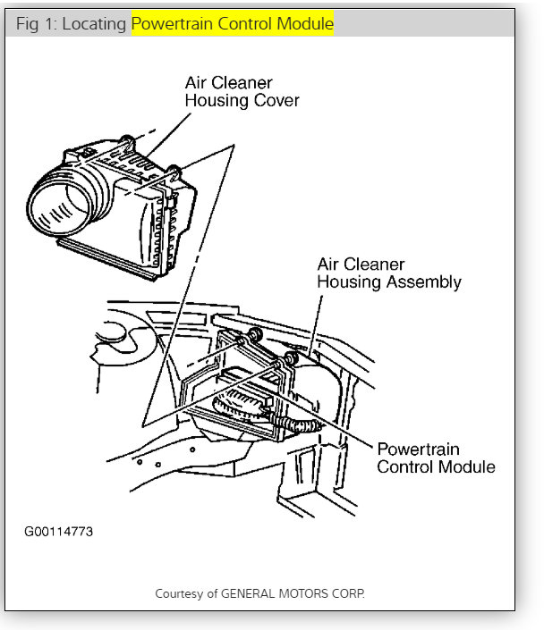

Location of this particular part please?

Powertrain Control Module (PCM) Left front side of engine compartment, in air cleaner assembly. If you intend to replace it, the replacement will have to be re-flashed. Check out the diagrams (Below). Let us know what happens and please upload pictures or videos of the problem.
