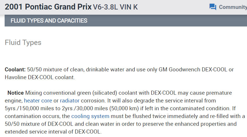

My husband may have put wrong coolant in my car. What coolant should we have used?
Jun 10, 2010 at 8:07 AM
DANNY L
  • 5,648 POSTS
Hello, I'm Danny.

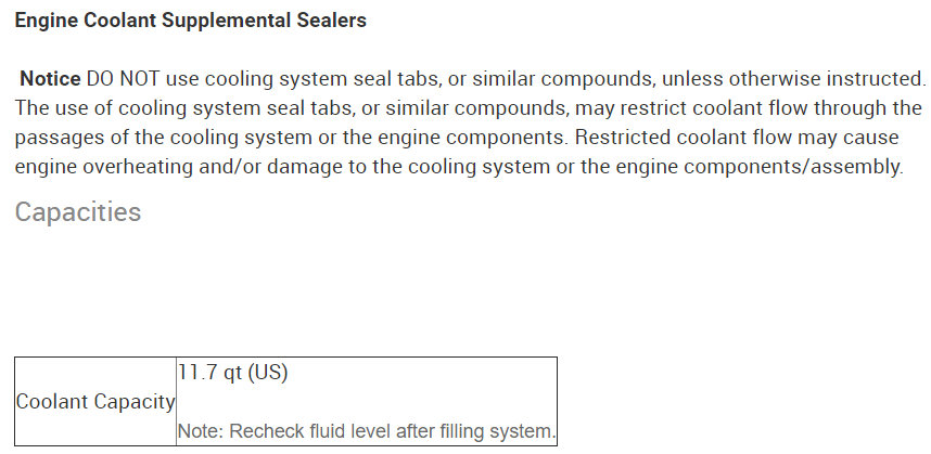

Your vehicle uses the GM brand DEXCOOL which is orange in color. I've attached 2 pictures below of you vehicles requirement and description. Hopefully he didn't use the green type of coolant. Hope this helps and thanks for using 2CarPros.
