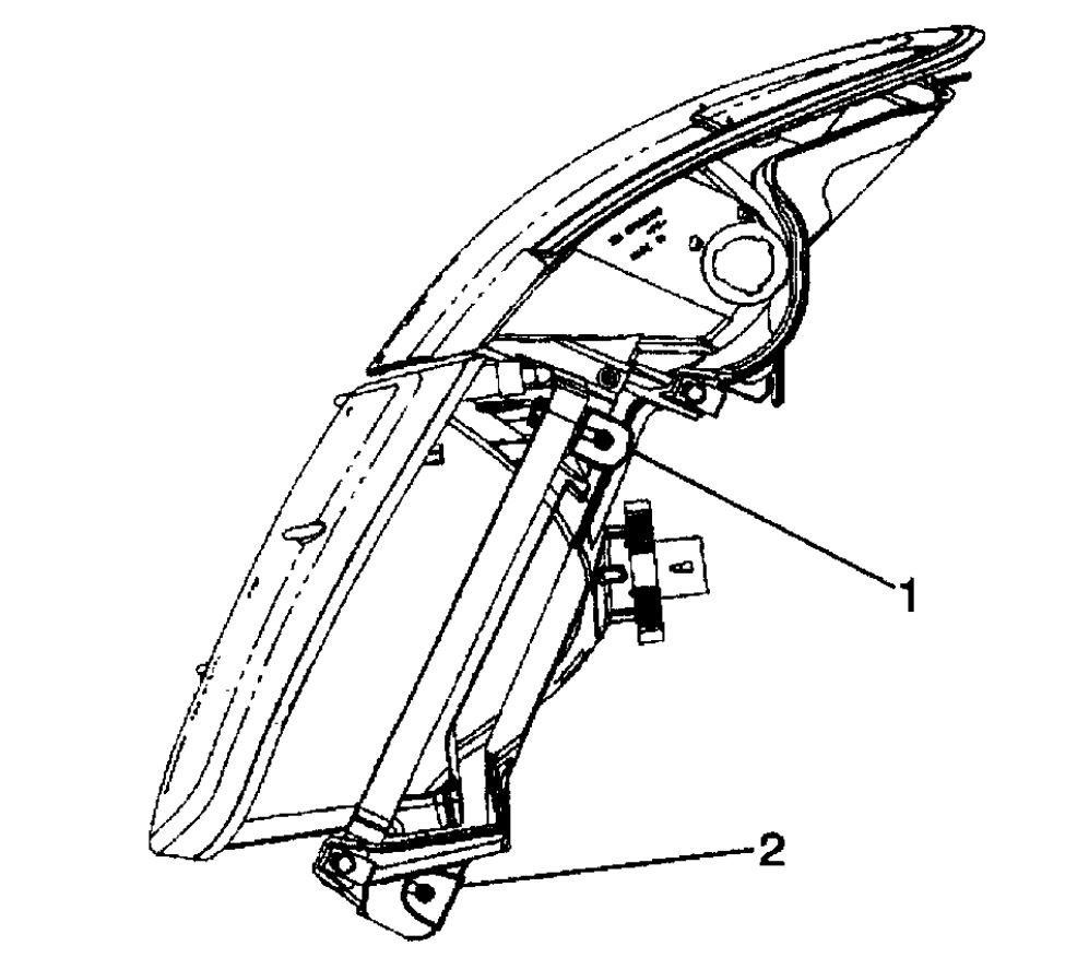

The horizontal adjustment screw (2) is located on the rear middle edge of each of the headlamp assemblies, toward the center of the vehicle. The vertical adjustment screw (1) is located on the rear upper edge of each of the headlamp assemblies, toward the outboard side of the vehicle.
See diagram below

I think I need to aim my headlights (down )how do I do this?

I was driving my car the other night and it was very hard to see...it seems like the head lights are pointing towards the middle of the lane, so we want to adjust them.
The only switch we can find to adjust is the up and down...does anyone know where the sideways adjustment would be done at on a 99 Pontiac Grand Prix.

I have added a picture the vertical adjustment screw (1) is located on the rear upper edge of each of the headlamp assemblies, toward the outboard side of the vehicle....Just pull up to a wall about 20 to 25 feet away and adjust them where you want them...
