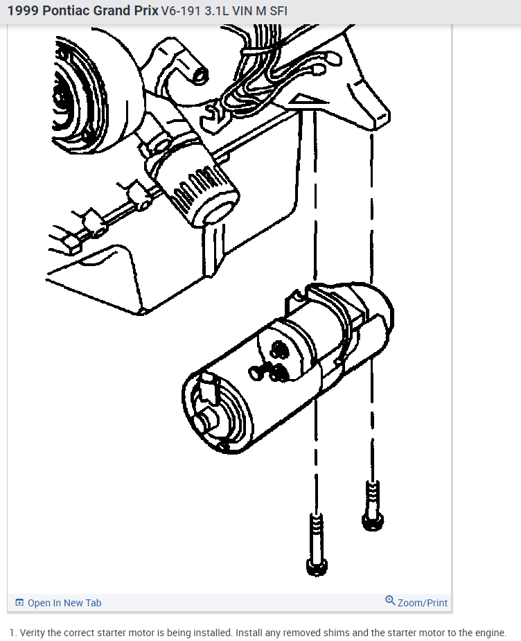

This broken nose cone of the starter can happen due to few different factors.
It could be because of incorrect flywheel clearance. If the flywheel is too close to the starter.
It can also happen if you happened to turn the key to start when the engine is already running.
Also if there is too much resistance for the engine to turn over.
Check your flywheel and inspect the clearance between the starter and the flywheel. If there is any type of shim that the starter requires, it can trigger that issue as well.
