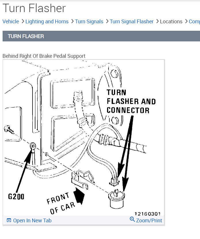

My turn signal flasher broke and I want to know where it is located so I can fix it. Please help

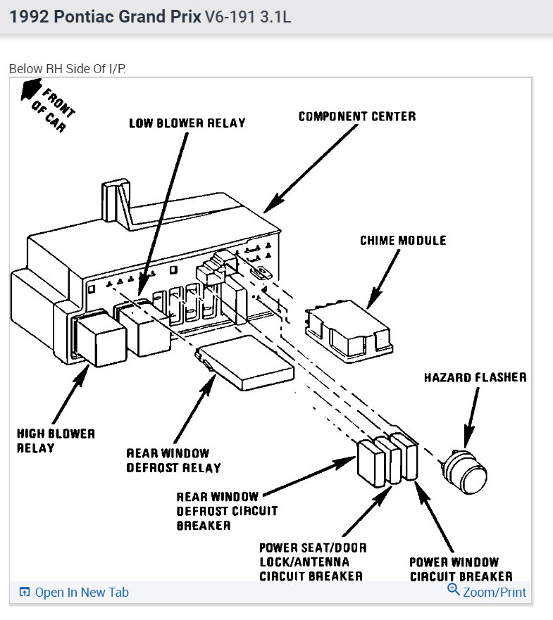

The turn signal flasher is behind the steering column bracket. Behind Right Of Brake Pedal Support. Check out the images (Below). Please let us know if you need anything else to get the problem fixed.
