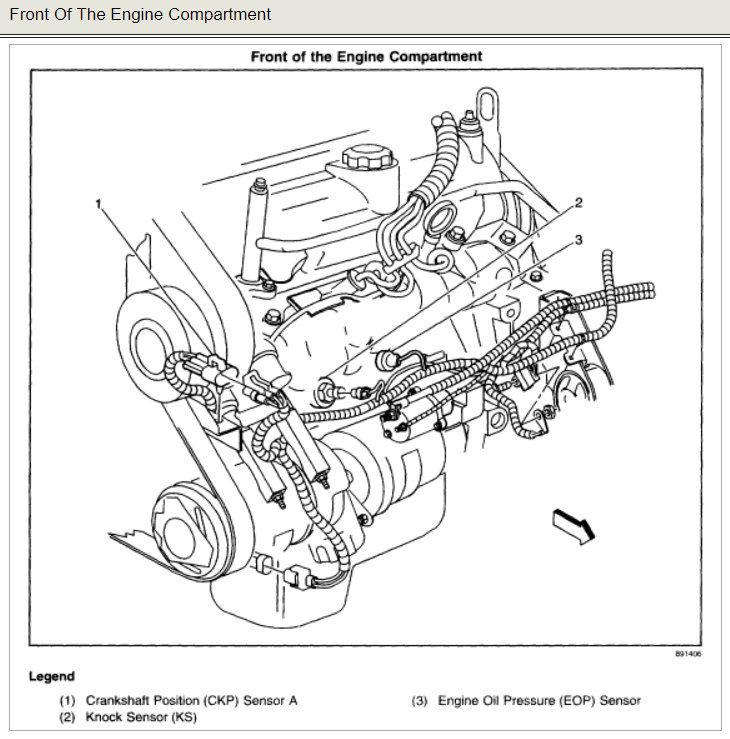

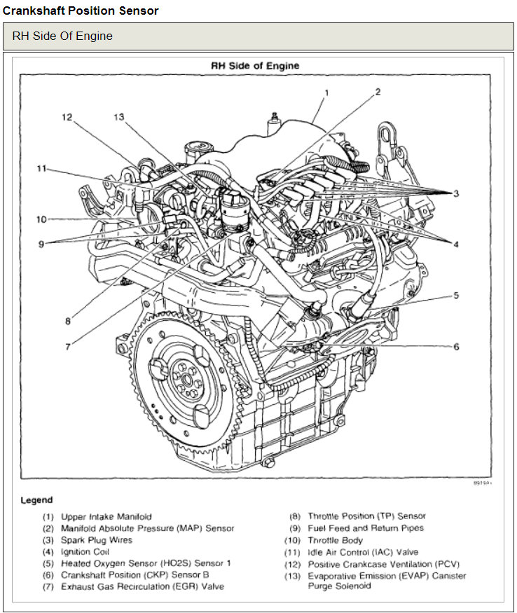

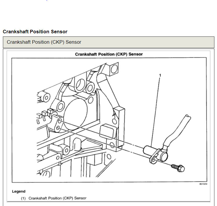

This sounds like a classic crankshaft angle sensor which will not set a codes when it is going out. Here is a guide to help you see what you are in for when doing the job:
Here is the location for your car both engine types in case anyone needs them.
