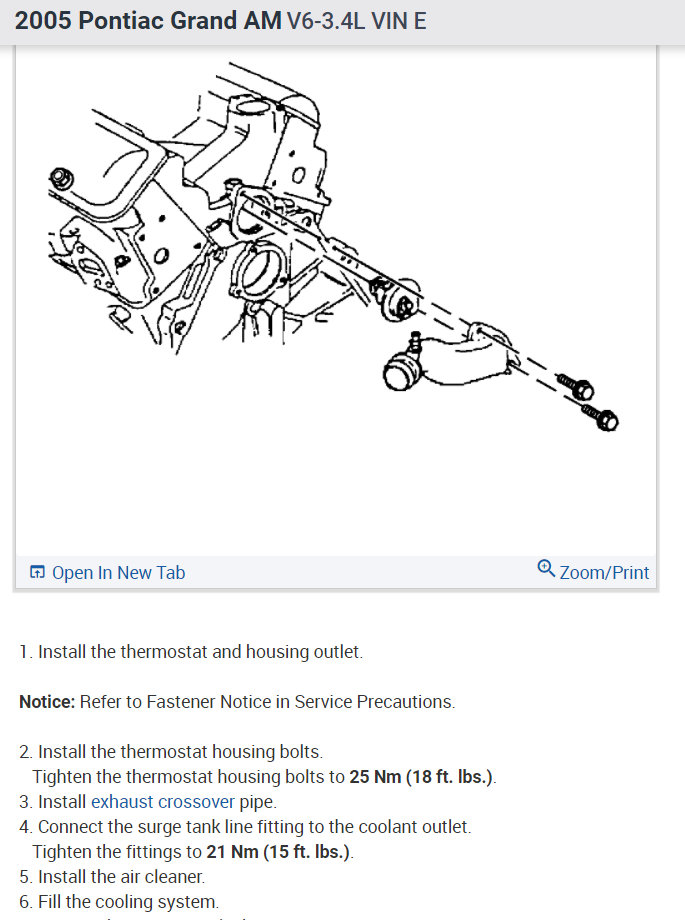

BLKDRGN66

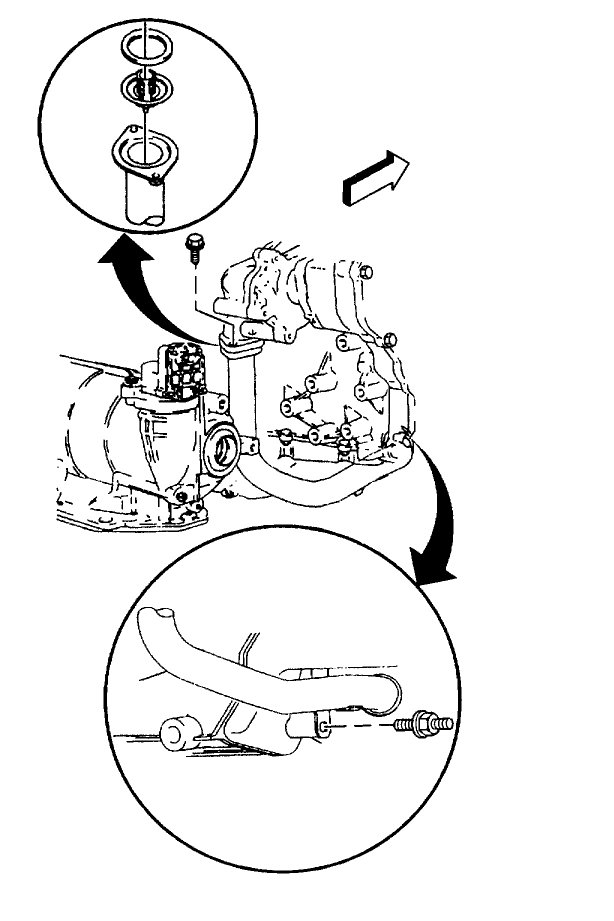

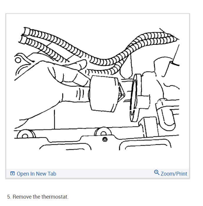

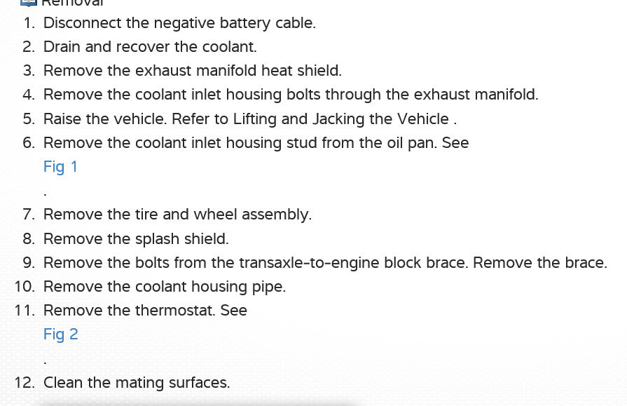

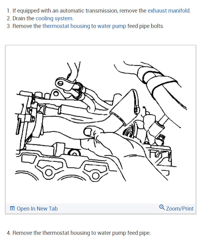

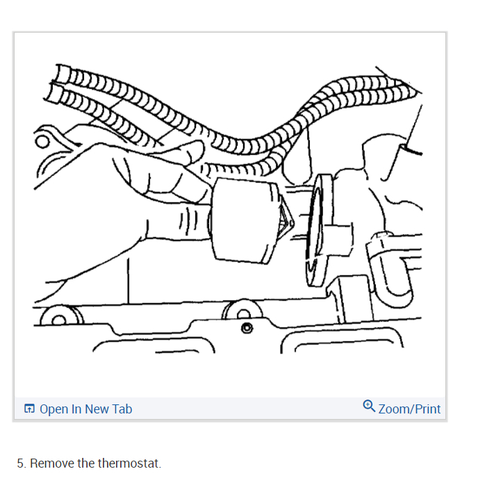

Where is the thermostat located and how do i replace it? the car overheats and jerks when i try to drive it HELP
Apr 5, 2009 at 8:54 PM
BLUELIGHTNIN6
  • 16,542 POSTS
Here is a guide to help you step by step with instructions in the diagrams below to show you how on your car.
Apr 5, 2009 at 11:12 PM

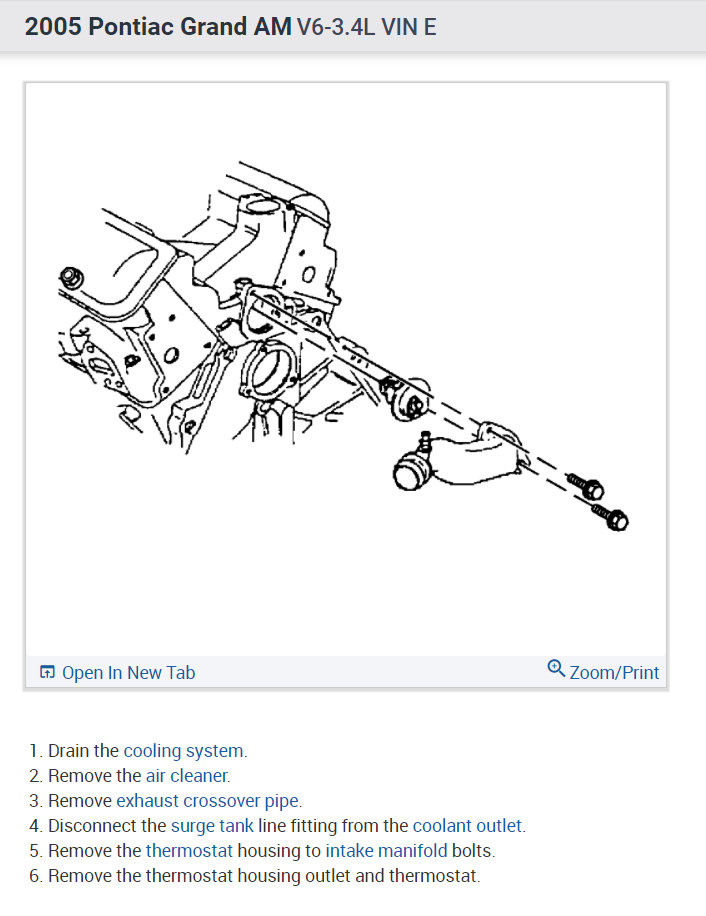

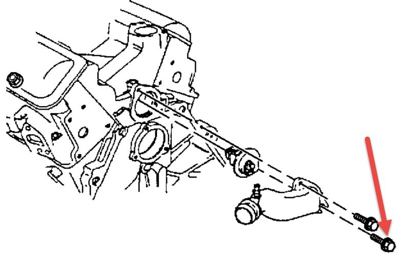

KEVMF

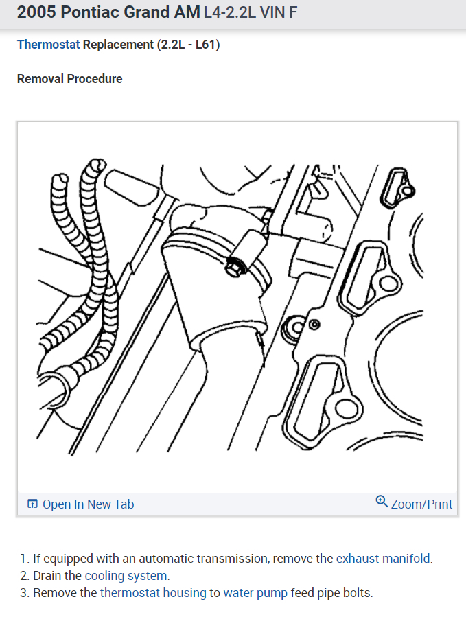

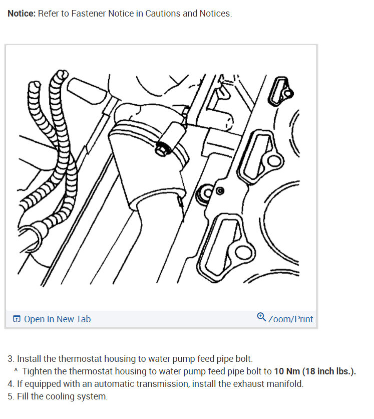

How do I get into the thermostat housing to change my thermostat
Dec 9, 2020 at 11:20 AM (Merged)
HMAC300
  • 48,601 POSTS
if air cleaner duct work in the way remove it. then remove two bolts from housing an dcleand surfaces then reverse procedure for install. the bottom bolt in pic ned only be loosened until you can remove by hand, use a universal socket. 13mm

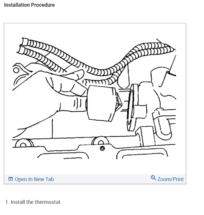

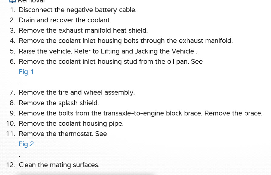

JOSHUA KERR

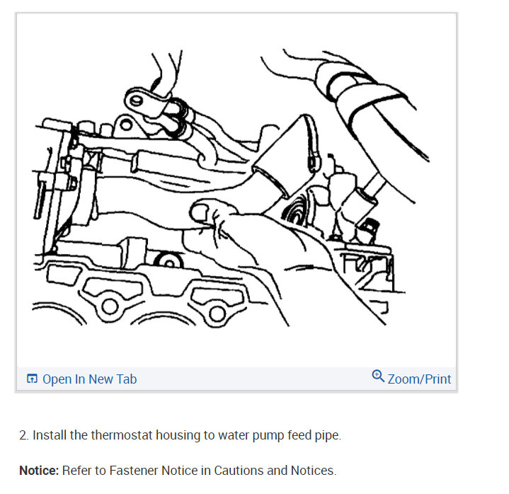

Putting in a new thermostat where is it located?
Dec 9, 2020 at 11:21 AM (Merged)
HMAC300
  • 48,601 POSTS
see pictures, you have to go through the wheel well to reach it.

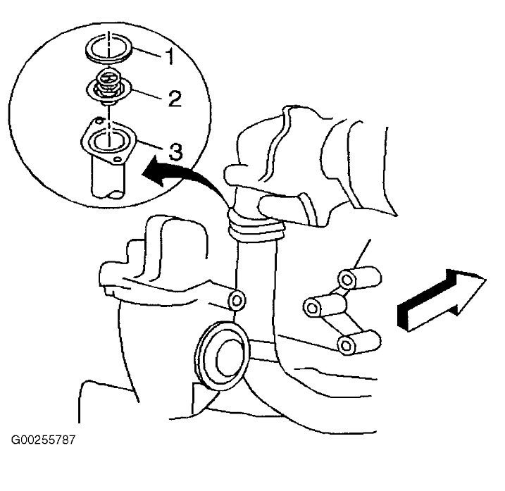

OLIVEIRACT

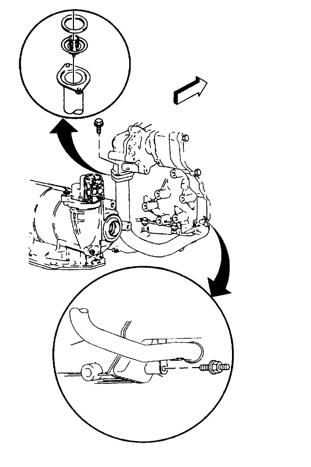

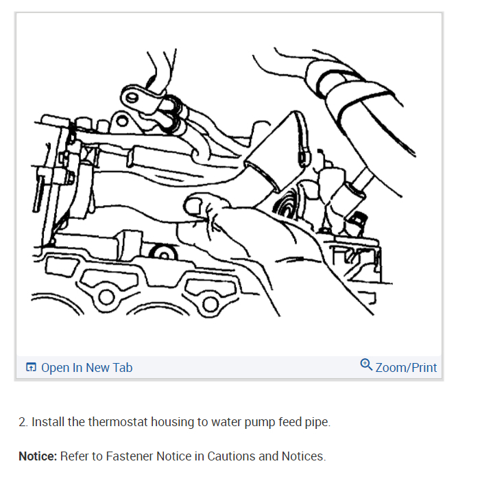

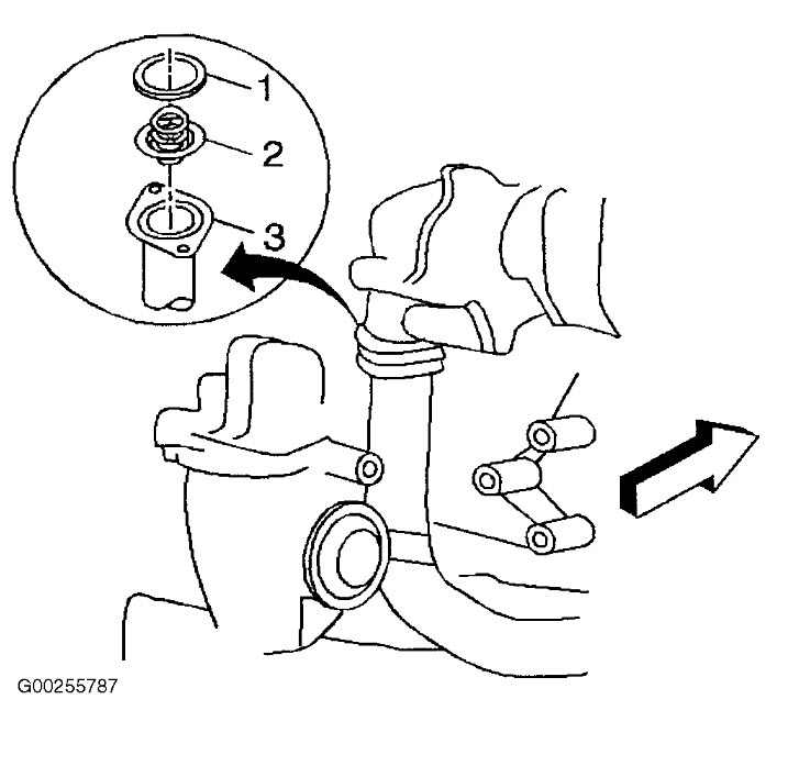

location of t-stat on 2.4, upper or lower water inlet hose?
please give specific details, thank you
The thermostat is located on the tube headed to the water pump. Here is a guide and a diagrams (Below) of how to do the job
Here is your car (below)
