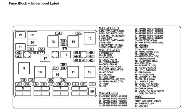

my car won't start. i have no fuel pressure. can you tell my where the fuel pump relay and the fuel pump inertia switch are located in my car? i would like to check these before buying a new fuel pump

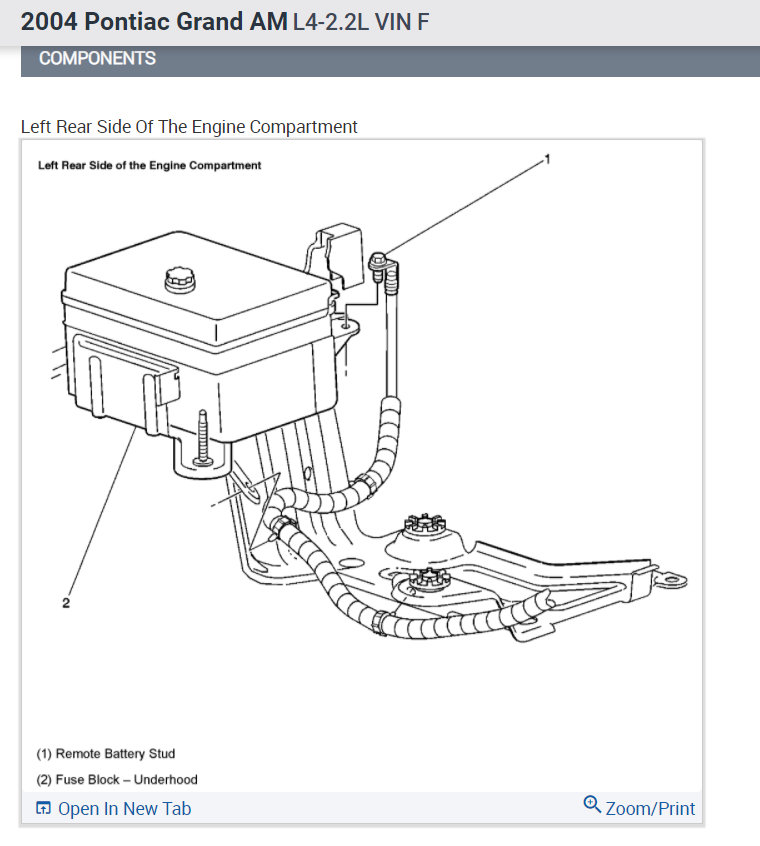

Do you hear the fuel pump come on for a few secs? If not here is a guide to help check the relay with the relay location #18 in the diagrams below.
Check out the diagrams (Below). Please let us know what happens.

where are the fuses and relay for the fuel pump, i found the relay just can't find the fuse. there is a fuel inj fuse. help.

The fuel injector fuse 15amp powers the fuel pump relay

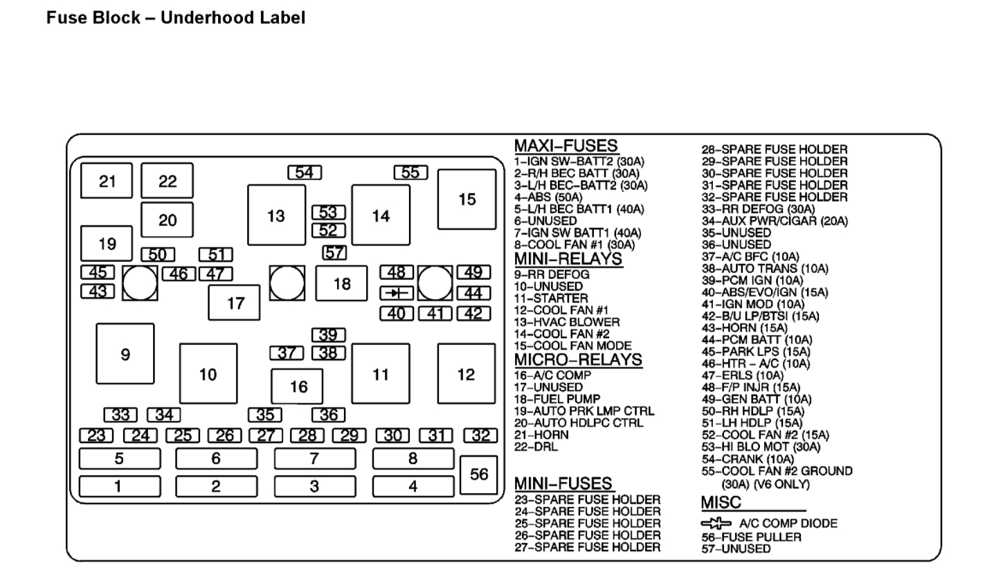

The fuel pump relay is located in the junction block and the fuse for the fuel pump is no.18 see below-
https://www.2carpros.com/forum/automotive_pictures/12900_junction_block_1.jpg
https://www.2carpros.com/forum/automotive_pictures/12900_fuel_pump_11.jpg
