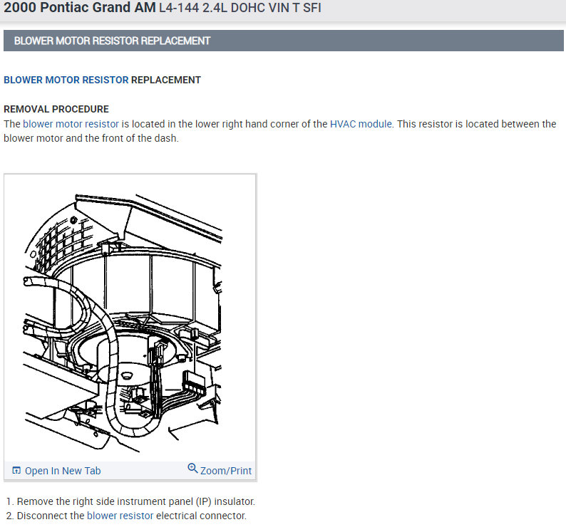

A 2001 grand am where are the blower resistor located

blower motor resistor is below the right side of dash, pic below

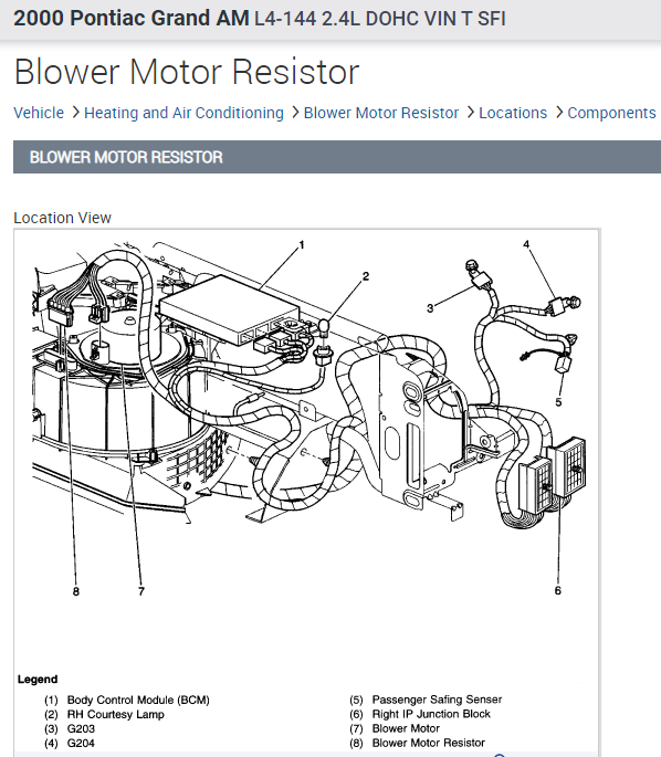

remove the under dash panel on the pass side. after that look underneath and you will see the heater box and the metal round thing about the size of your fist is the blower motor. the resister is right next to it. it is held in by a few 7/32 screws. hope this helps

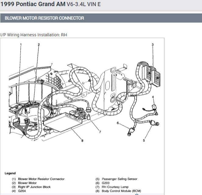

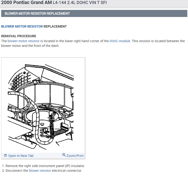

Over time the blower motor resistor will get burnt on the different speed setting and can only work in one speed.
The blower motor resistor is located under the dash on the passenger side. It is mounted tot he blower motor.

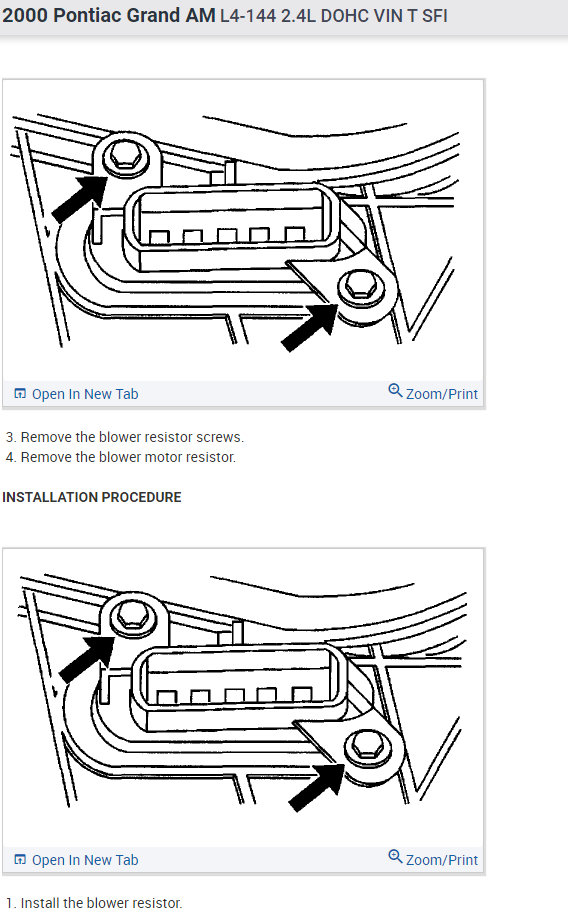

To take off the sensor simply disconnect the wiring and remove 2 screws that holds it in place.

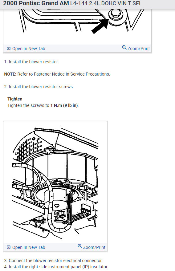

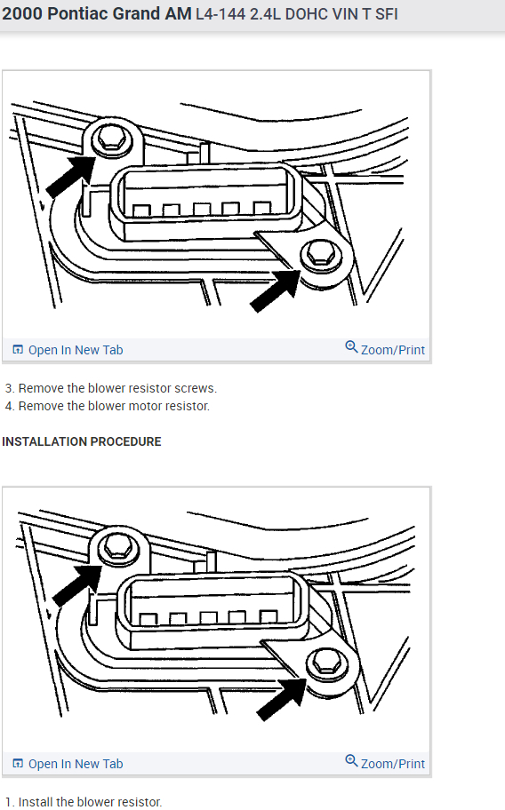

I have attached the diagrams for your reference.
Thank you.

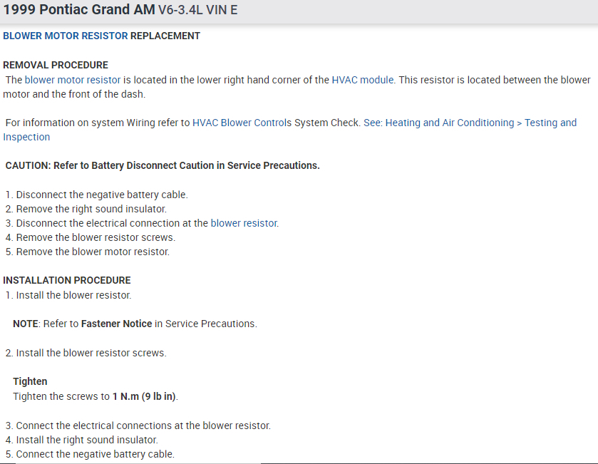

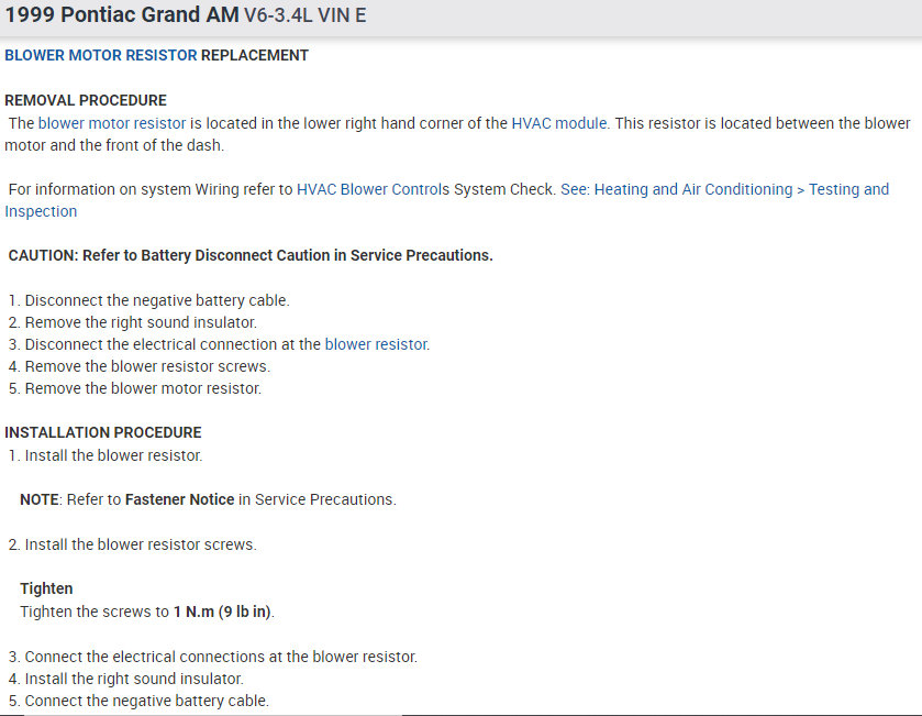

Blower motor resistor is located on the blower motor case itself. Blower motor is located under dash, remove right lower interior panel for access.
REMOVAL/INSTALLATION:
Disconnect negative battery cable.
Disconnect resistor wiring harness.
Remove resistor mounting screws, then resistor.
Reverse removal procedure for installation.

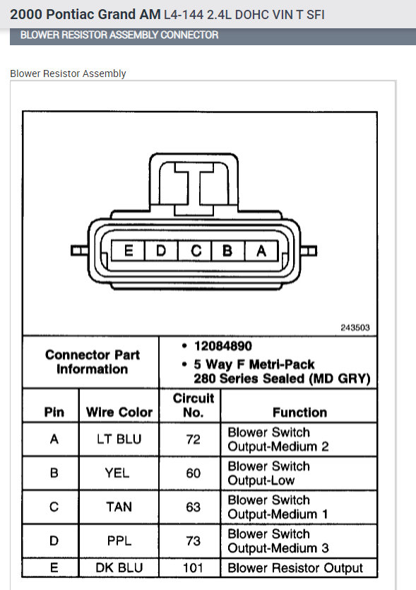

My heater control inside the vehicle only works on the 4 & 5 setting. I get no air at all on settings 1,2 & 3.
Nov 9, 2024 at 4:50 PM (Merged)
SQM
  • 6,383 POSTS
It does sounds like a faulty blower motor resistor. Which is a very common issues with these cars. The resistor is mounted on the side of the blower motor. See below for the replacement procedure of the resistor.

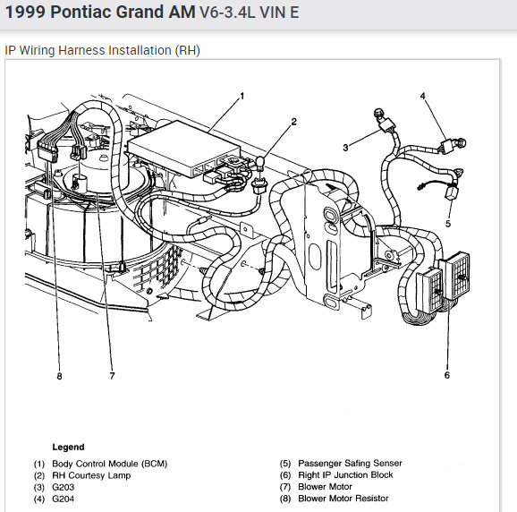

Remove the right lower interior panel in front passenger side, it's screwed to the side of the blower motor...

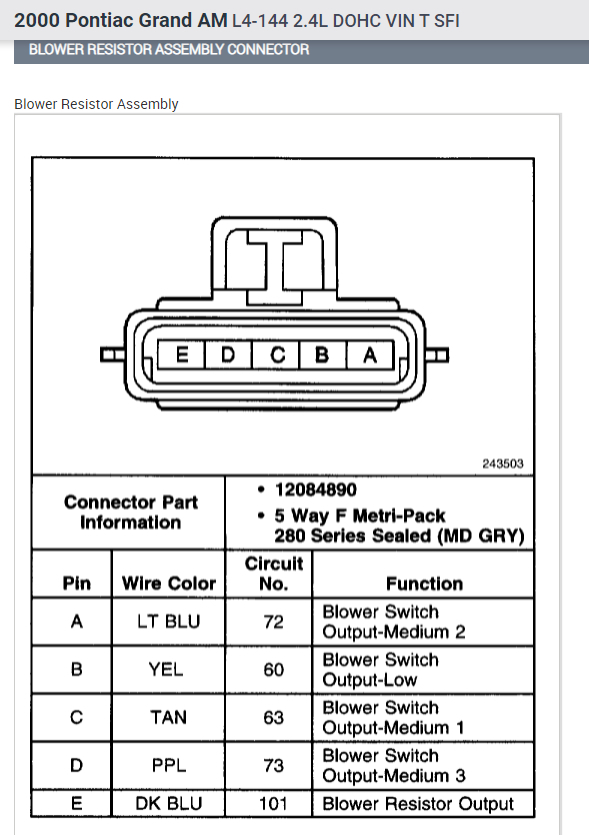

The blower resistor should be mounted next to the blower motor. The resistor connector and blower connector should be in the same wire lume. I believe the blower resistor has 5 wires to it. DK BLU,PPL, LT BLU,TAN,YEL
