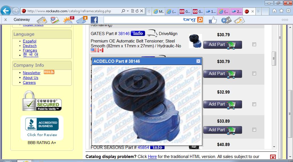

SATURNTECH9
  • 30,869 POSTS
Idler pulley with spring?The idler pulley shouldn't have a spring.Are you talking about the belt tenisor?if so did the bolt break that holds the pulley on?
Jul 28, 2020 at 1:08 PM (Merged)
SATURNTECH9
  • 30,869 POSTS
Does it look like the one i posted?
FUNNYF
  • 17 POSTS
Yes, that looks like it.. the main bolt that holds tenisor onto motor broke, not the bolt that just holds pully onto the spring tenisor. HOW DO I GET TO IT to get broken threaded thats broke off in block? thank you!
SATURNTECH9
  • 30,869 POSTS
Your going to have to put a piece of wood on the jack and slide it under the oil pan.Then jack the jack up till the engine is resting on the jack.Then remove the upper engine mount then jack the engine up to get some more room to work.As long as the bolt wasnt cross threaded when it was put in it should just unscrew.Did the bolt break flush or bellow flush in the threaded hole?
