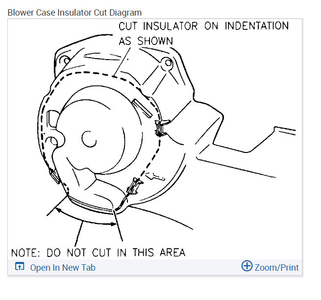

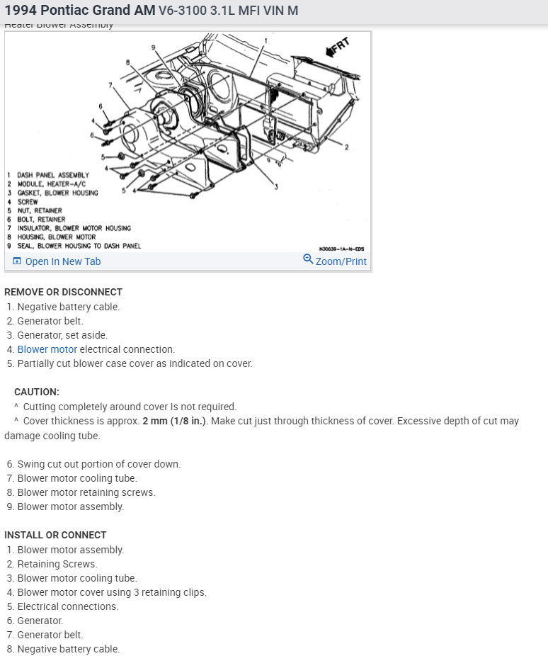

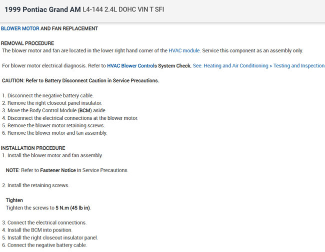

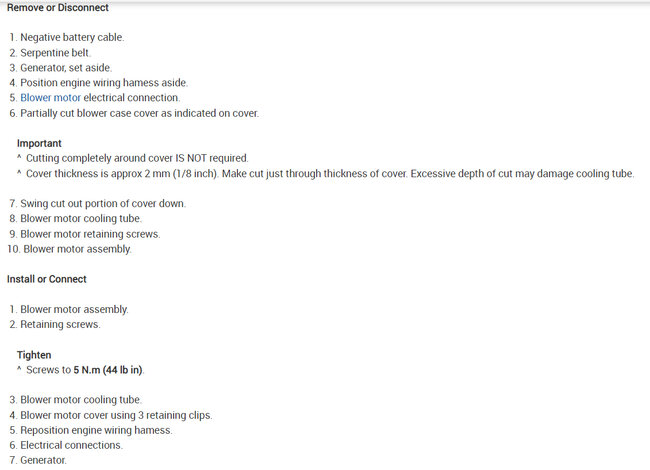

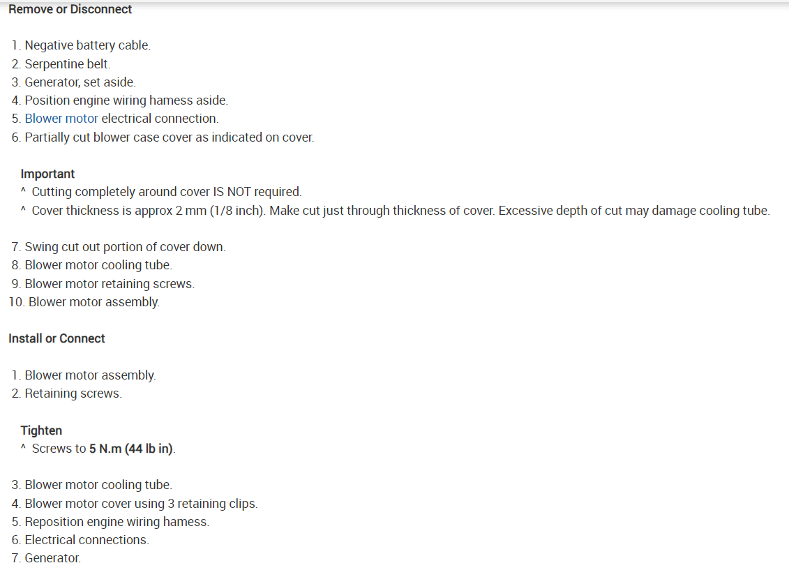

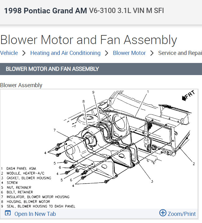

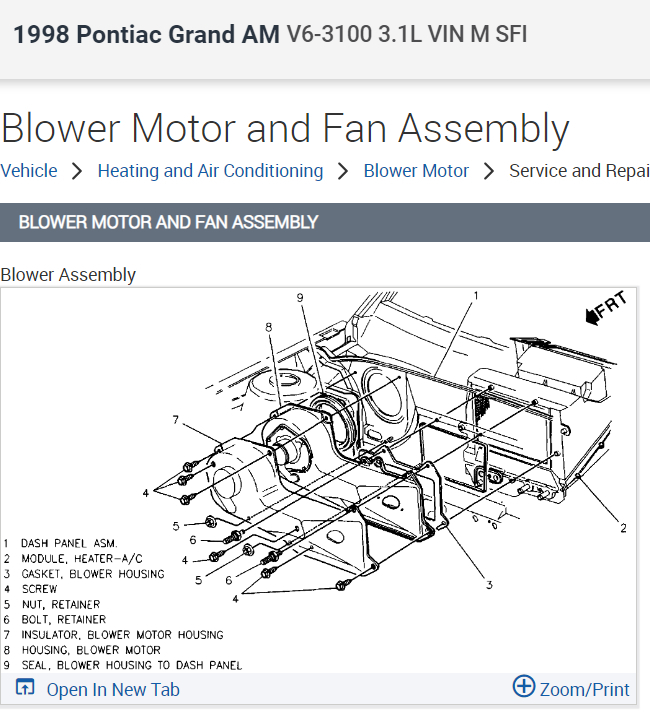

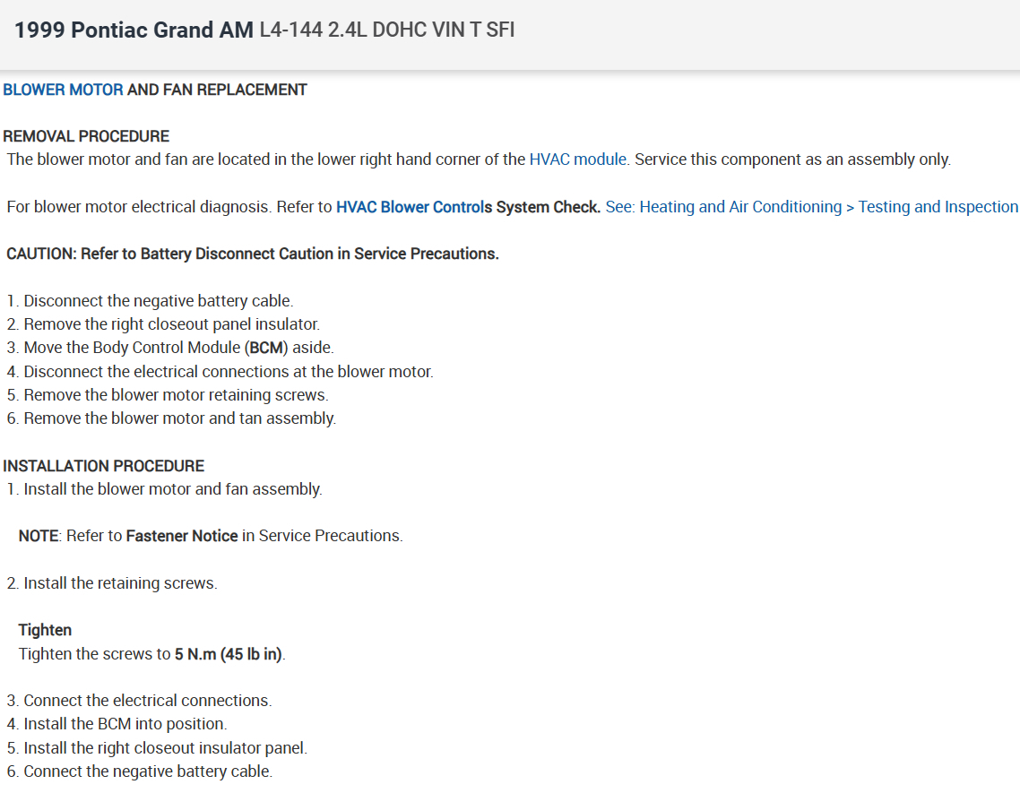

I agree with BMRFIXIT, here is the blower motor location and how to replace it. Check out the images (below). Let us know if you need anything else.

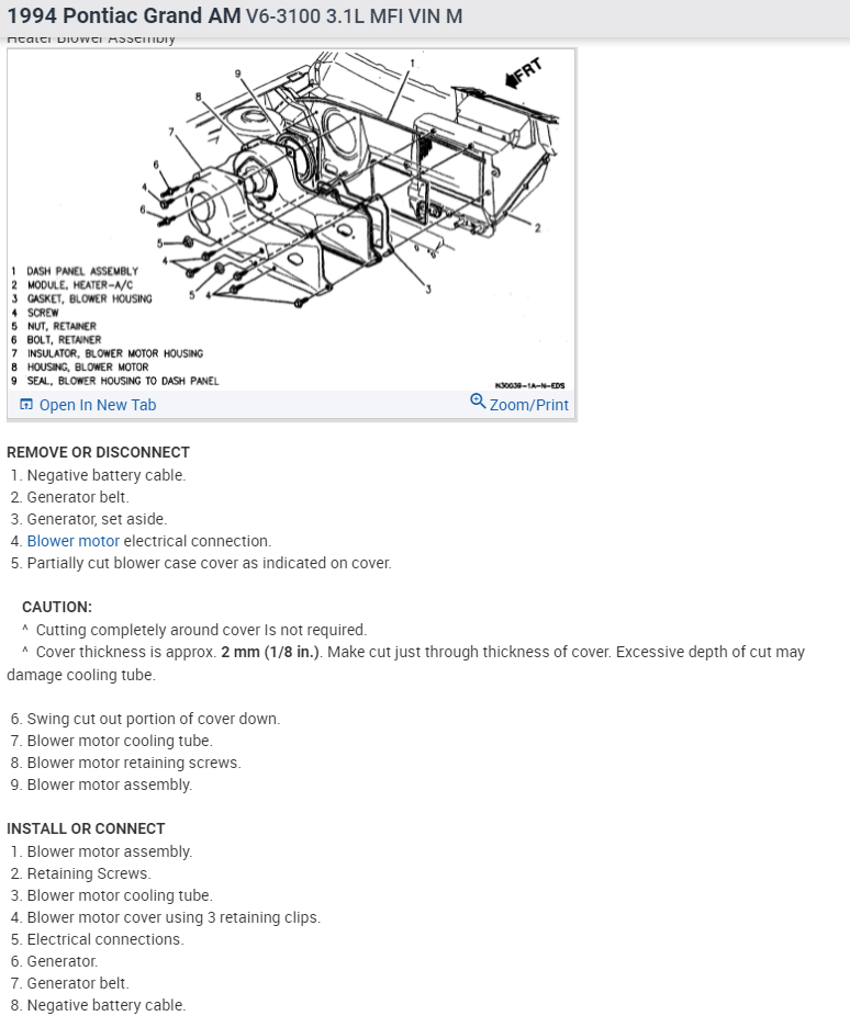

Yes, if the blower motor is not working the heater will not work as well. Here is how to test he blower motor power and ground to make sure the motor is the problem.
https://www.2carpros.com/articles/how-to-test-an-automotive-hvac-system-blower-fan-motor-a-detailed
Here is the location of the blower motor and how to change it out. Check out the images (below). Let us know how it goes. You will need to cut the insulation to get at the blower motor.

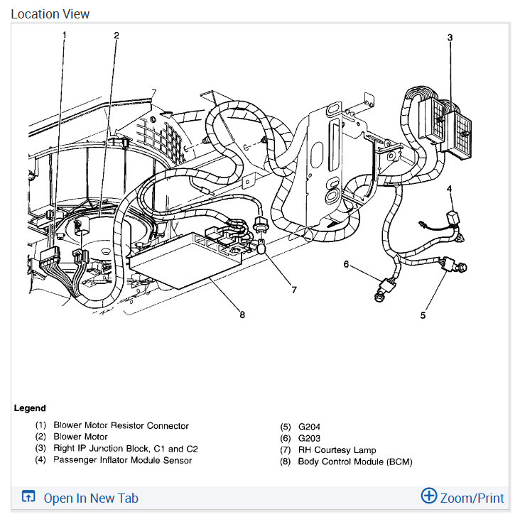

Have you checked heater fuses? I don't know an easy way to get at the connector. You may have to access the blower motor and follow the wires.
The autozone site has info on getting at the blower motor. Click on( vehicle repair guides) follow the links for y--m--m, then type blower motor in their( parts search box), that page will have a link at the bottom for getting at the blower motor.

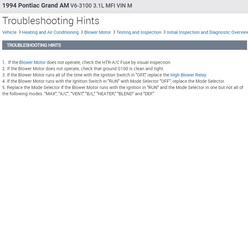

BLOWER MOTOR WILL NOT RUN

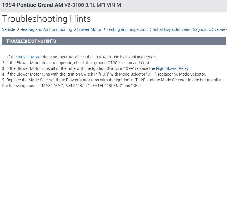

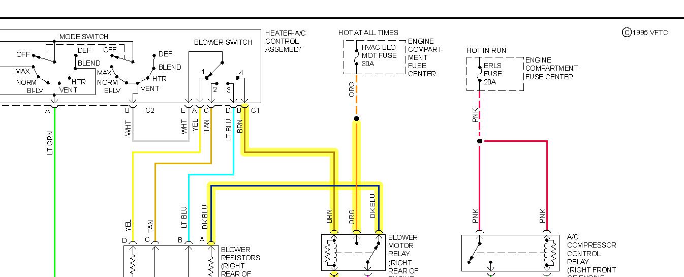

Check fuses. Turn ignition switch to RUN position. Check for voltage at function control switch. Switch blower switch to HI position. Check for voltage at switch and at high-speed blower relay. Ground blower motor with ignition switch in RUN position. If blower operates, motor is okay.

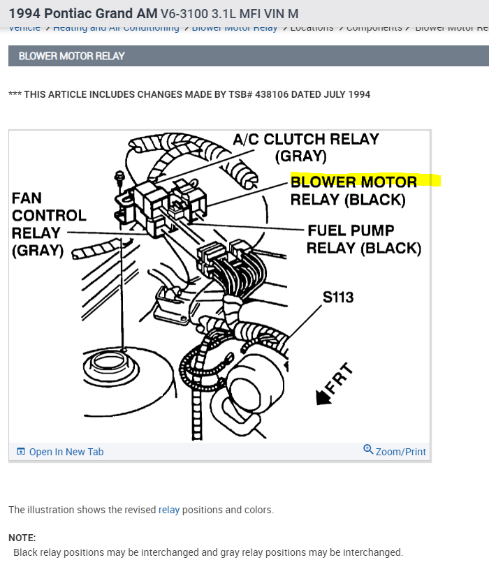

Check the blower motor fuse 30amp in engine compartment fuse center and blower relay in right rear in engine compartment-
Do this -you can power the blower motor purple wire and see if it works direct from the battery postitive post-

At fuse block check the Heater/AC fuse 25amp. This problem could be the Heater/AC control assembly,blower motor resistor/blower motor relay located it in the right rear of engine compartment. See below

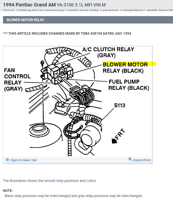

An inoperative blower fan can be due to a faulty switch, bad relay, malfunctioning blower motor resistor, bad motor or wiring issue.
First check the relay.
The blower motor relay is located under the hood (see diagram).
Check for any corrosion or burnt pin(s).
You can also test the relay.
If the relay is good, then make sure the blower motor is getting power. To see if the motor is good or bad you can test it by simply applying 12V power to it.

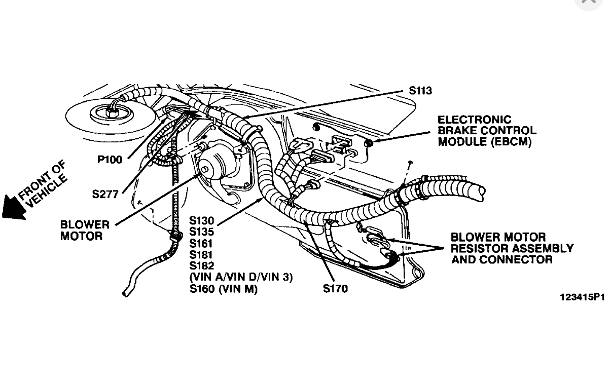

check the wires on the resistor and the motor
if all ok motor no good
