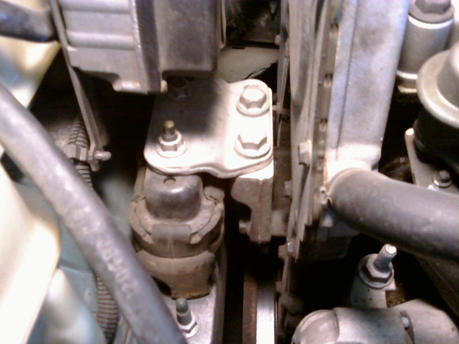

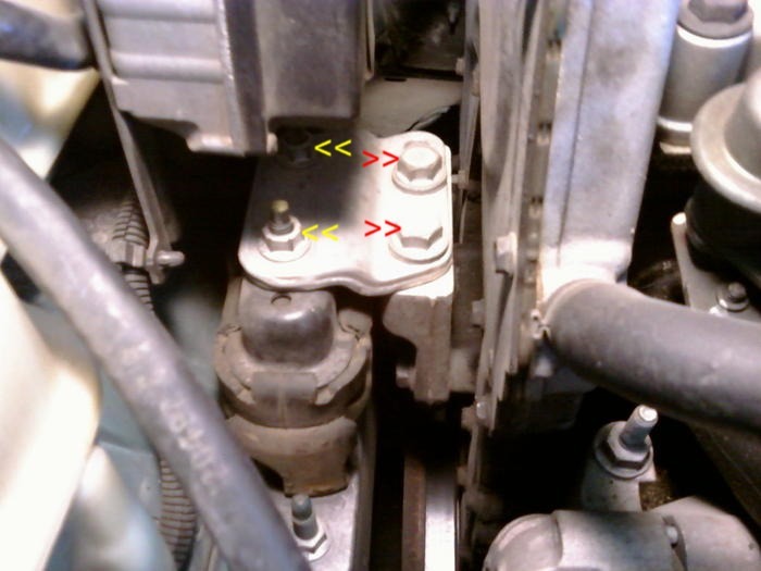

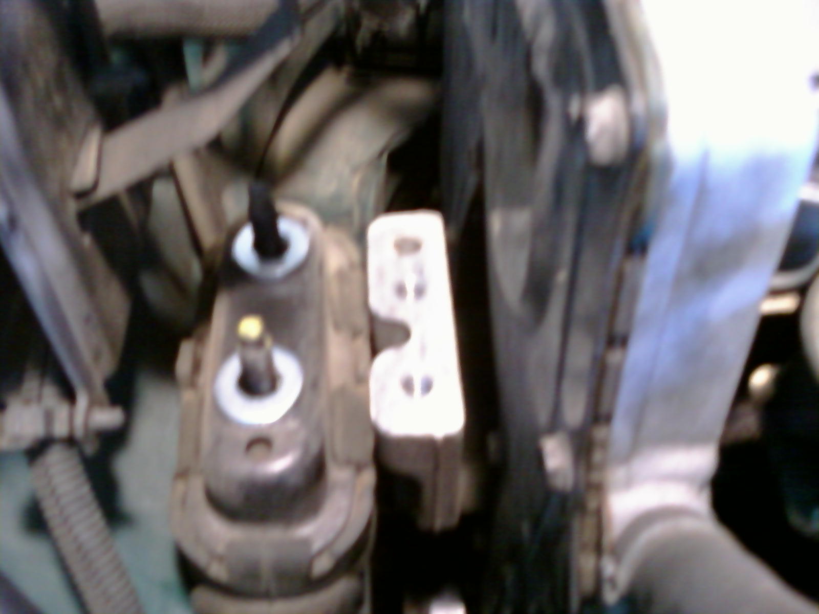

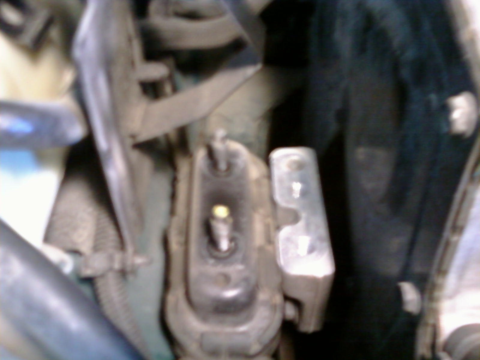

I checked the motor and transmission mounts, and found the front transmission mount cracked. I replaced it, but the shake is still there. I also noticed that when I drive into the driveway, which has a slight uphill slope, and park with the trans in drive the shake is there. Put it into neutral, or reverse, it is gone. When in park it is gone, until you take your foot off the brake pedal. At that point the car coasts back slightly until the transmission is holding the car, and the vibration comes back. This had me convinced that the front trans mount was the culprit, but as I said, replacing it made no difference.

Is it possible that the rear transmission mount has gotten weak with age? It looks okay, and does not have any cracks that I can see, but is the only logical answer that I can come up with. If it was anything in the engine itself causing the shakes, why would it only do it in park once the transmission is holding the car? The driveway only has a slight incline, but it is enough for the car to roll back if put in neutral. Putting it in park does put slight pressure on the trans mount, but not much.
