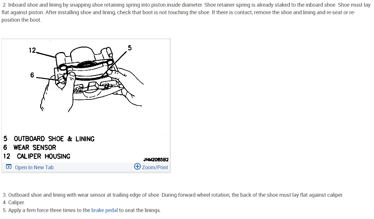

I agree with NDDUNC, it sounds like the brake pads are worn out I would check the front pads first. Here is a guide to help explain better.
https://www.2carpros.com/articles/brake-pad-symptoms

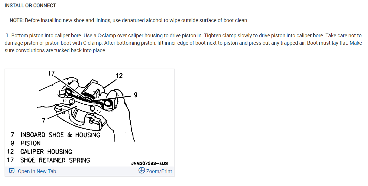

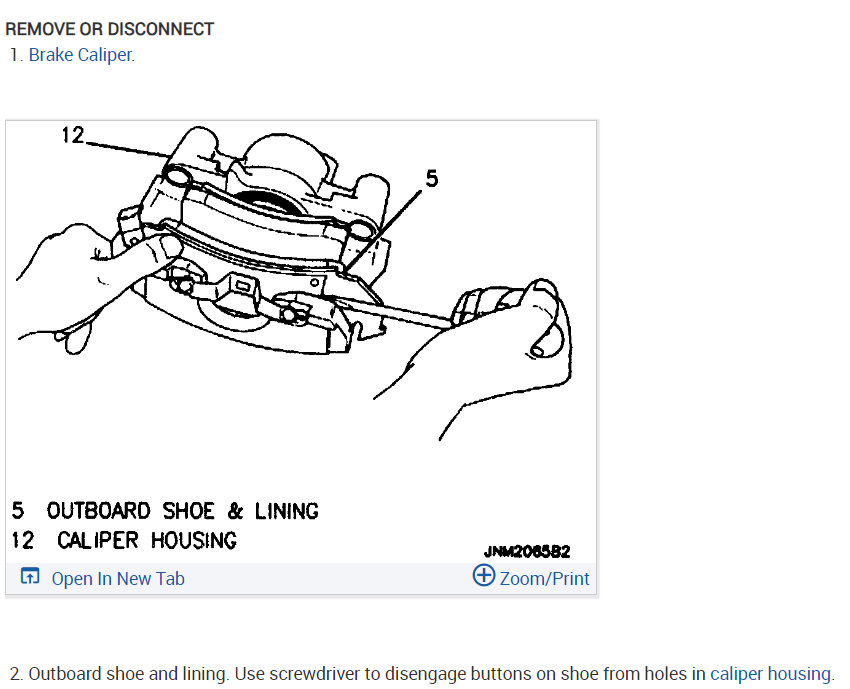

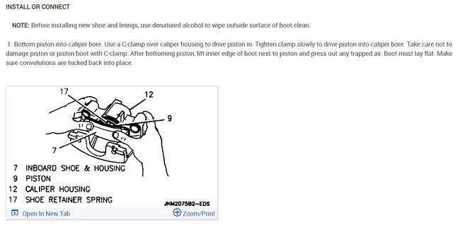

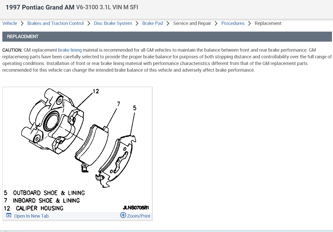

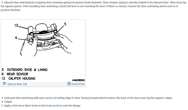

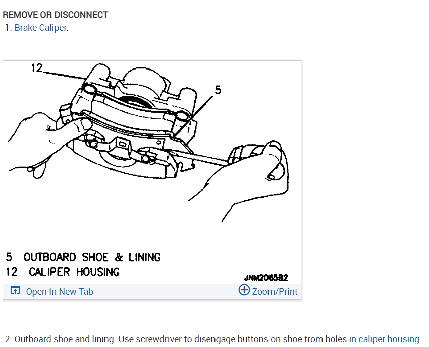

Here is how to do the front brake pads replacement on your car. Check out the images (below). Please let us know what happens.
