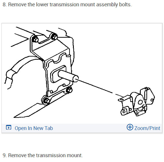

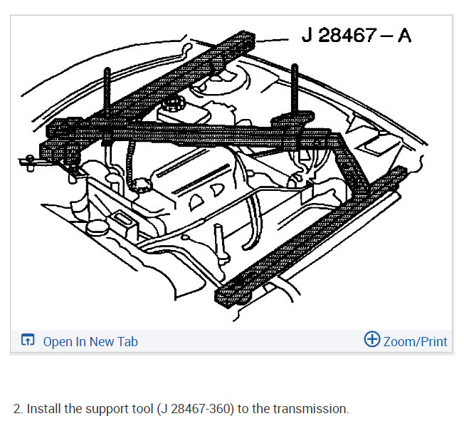

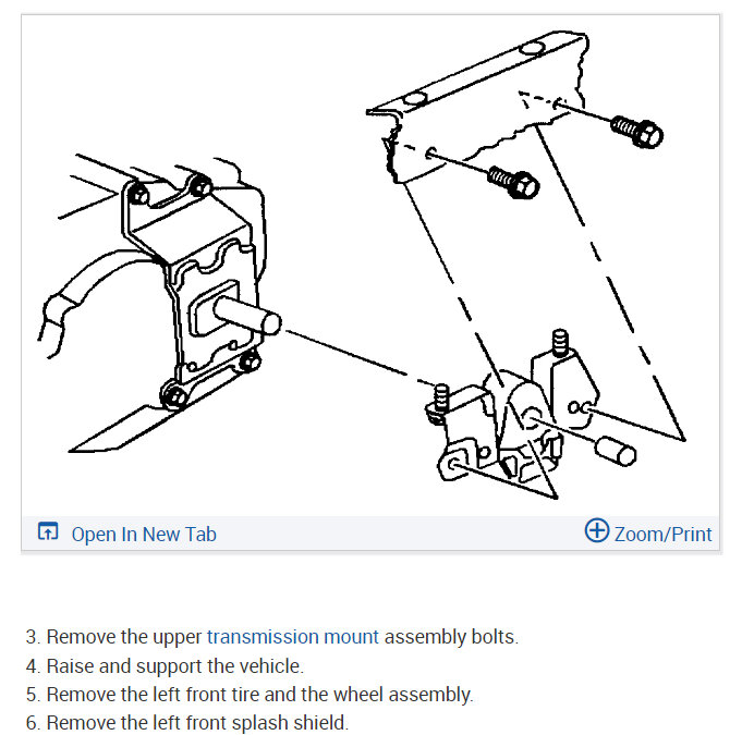

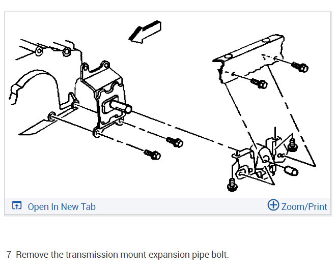

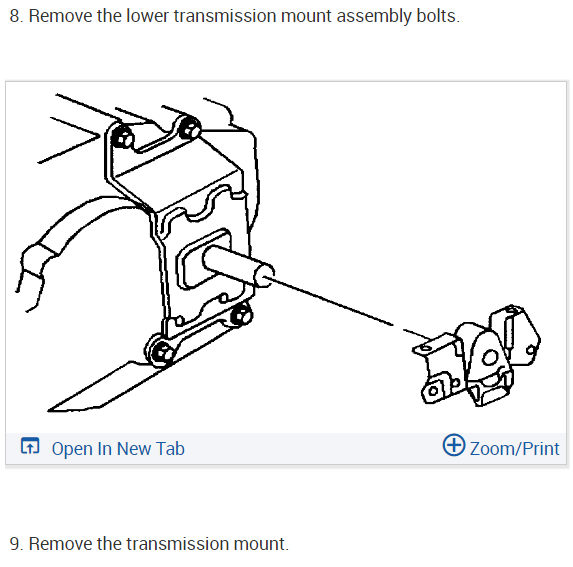

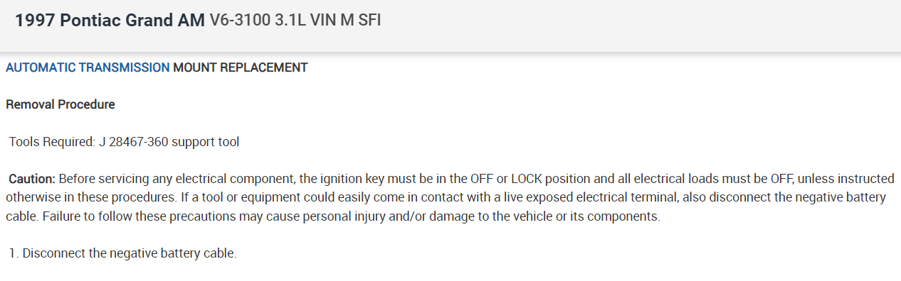

1997 Pontiac Grand Am V6 Front Wheel Drive Automatic 160000 miles
How do you replace the transmission mount
