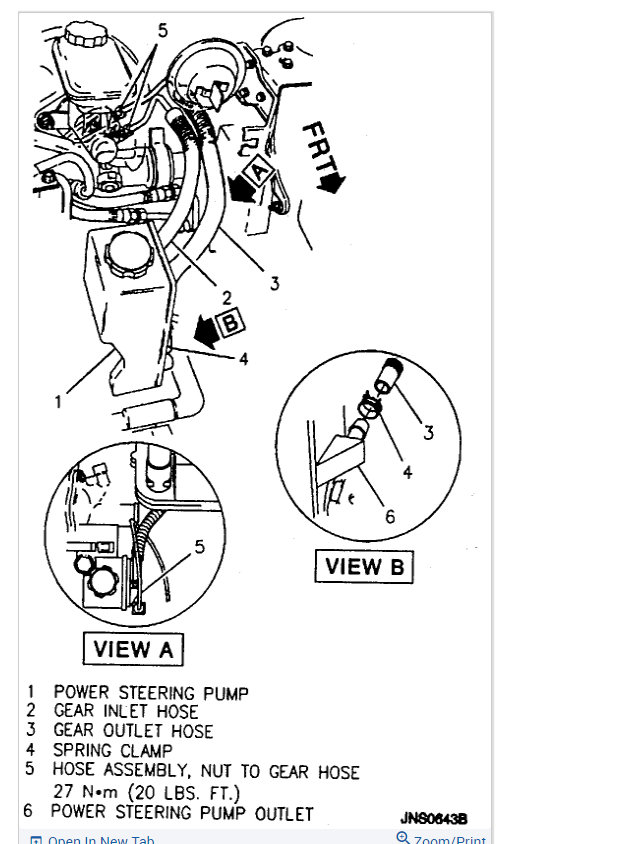

how do i change the high pressure power steering hose on a 97 pontiac grand am gt.
Aug 5, 2010 at 7:10 PM

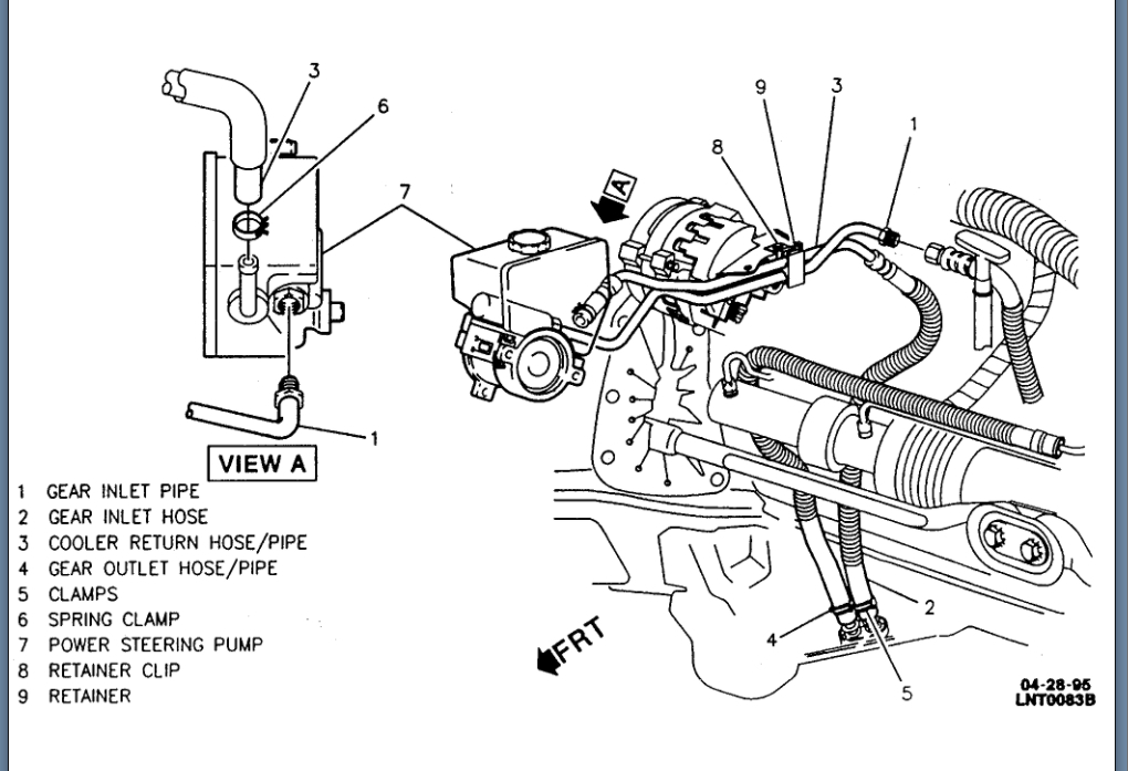

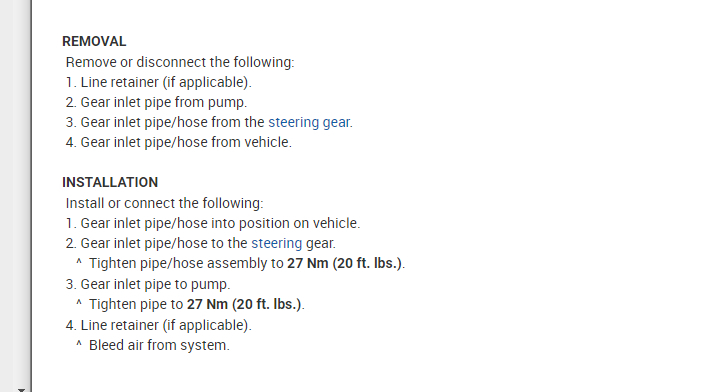

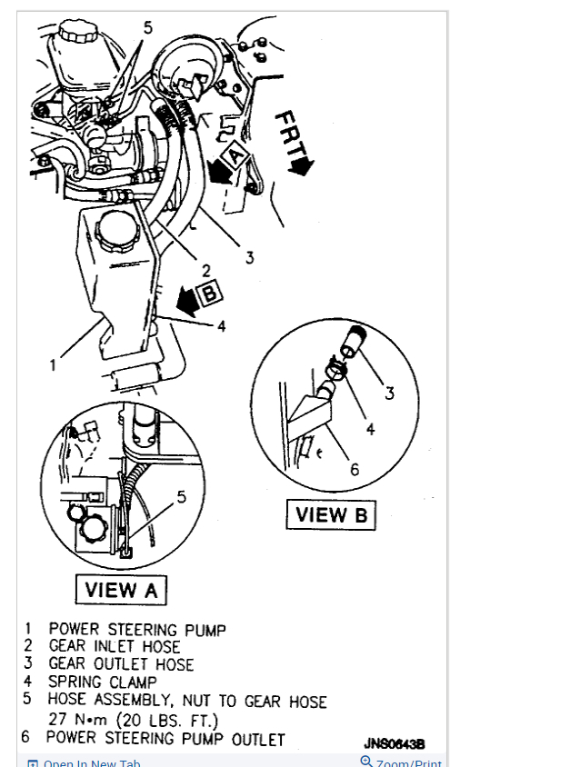

I am attaching the info below but when you finish you will need to flush the system and fill it properly.
Here is a guide that will help with this:
https://www.2carpros.com/articles/power-steering-fluid-flush
Please see the info below from the manual that will help with this.
Please run through this material and let us know if you have other questions. Thanks
