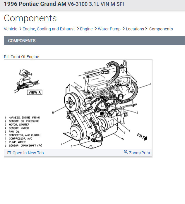

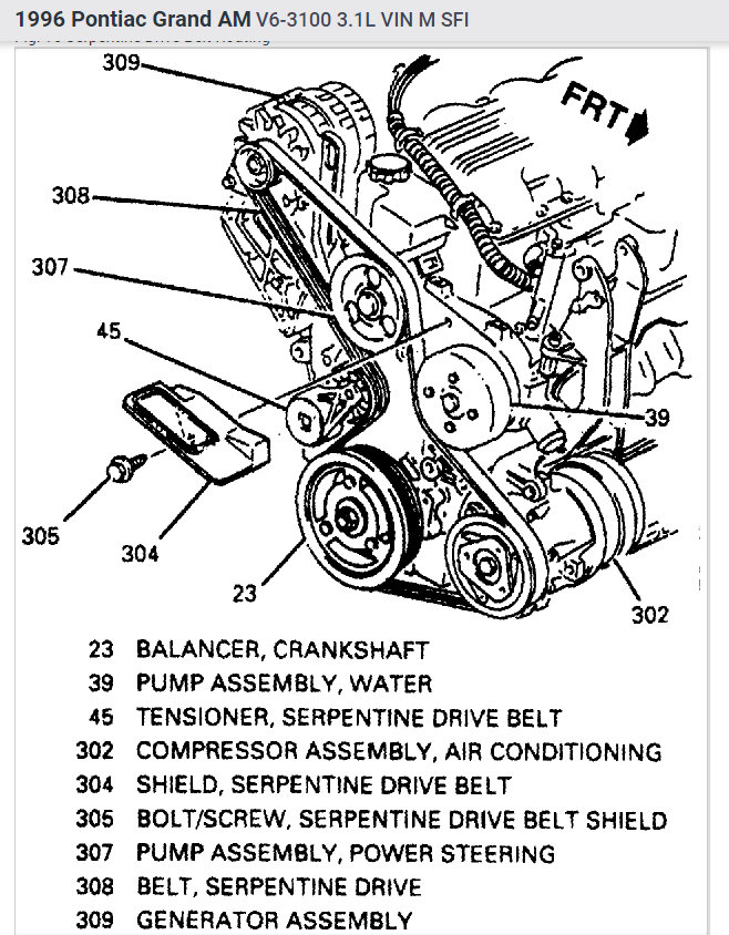

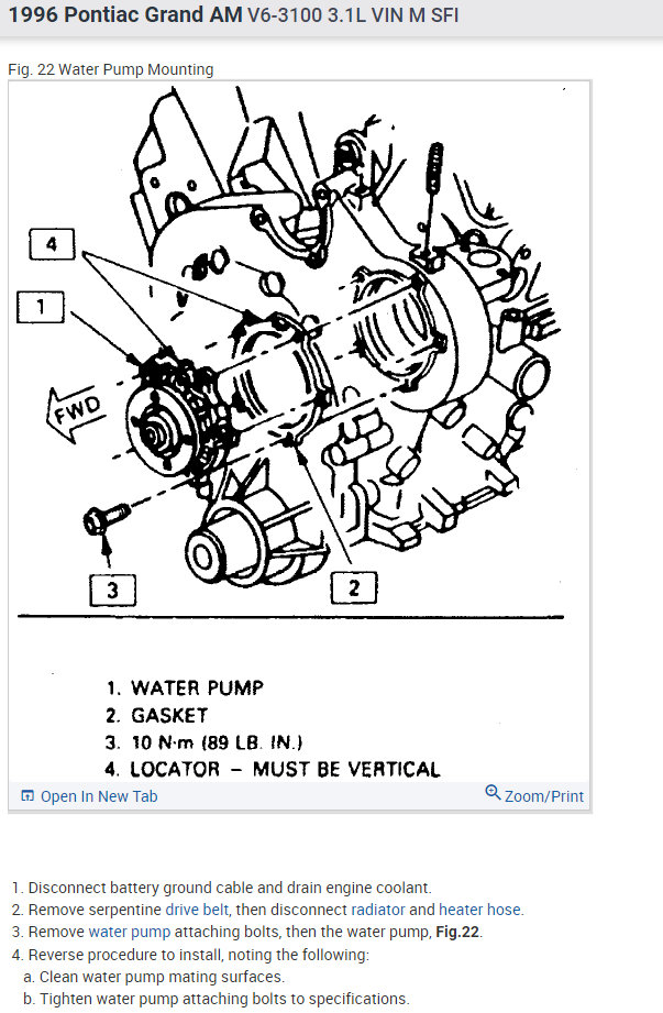

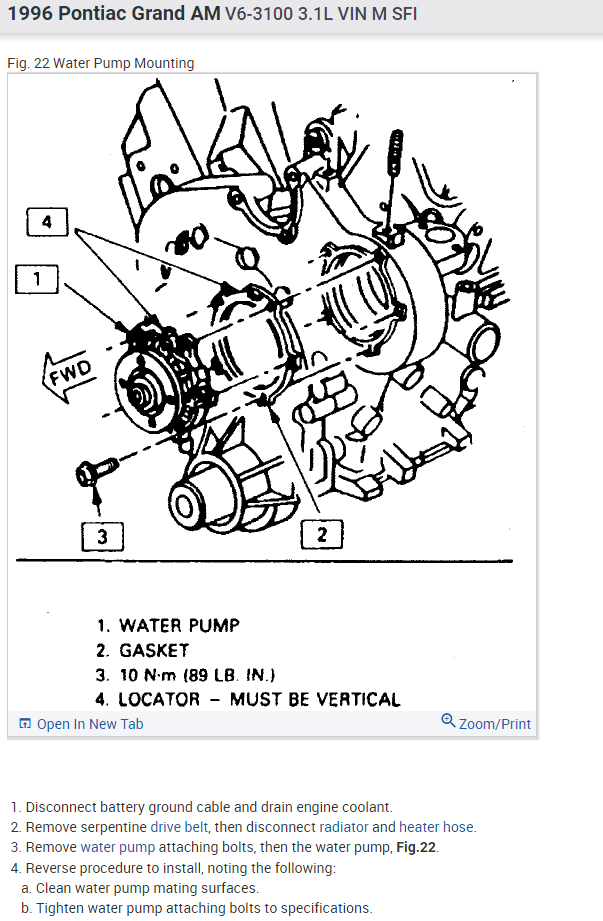

In order to replace the water pump you will have to take the serpentine belt off first.
Remember to only work on the vehicle when the engine is cool.
First drain the coolant. There is a drain plug at the bottom of the radiator.
You might find these articles helpful:
https://www.2carpros.com/articles/water-pump
https://www.2carpros.com/articles/water-pump-replacement
I have attached the water pump replacement diagrams for your reference.
