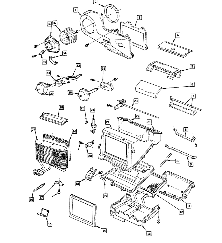

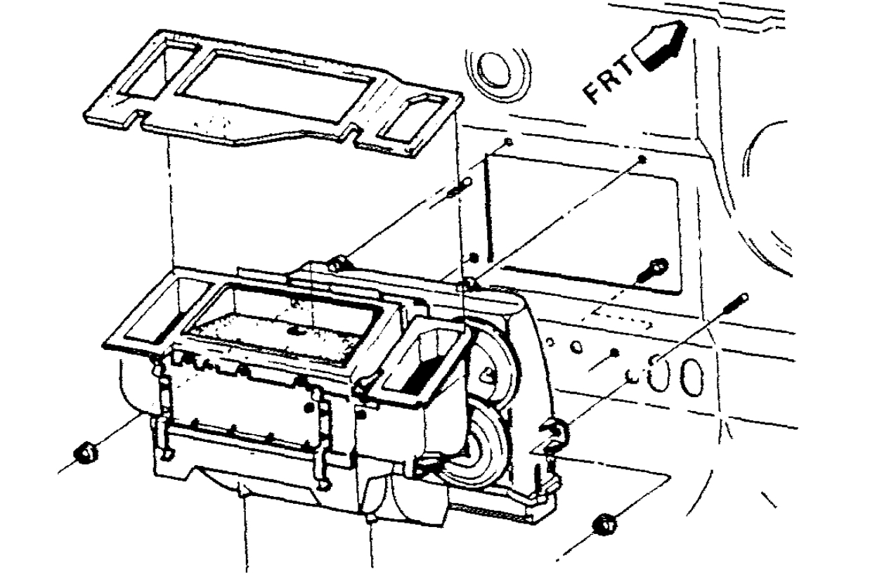

Could be an air mix or blend door not opening due to actuator or vacuum problems
Dec 13, 2007 at 11:18 AM
Yep, I agree with RASMATAZ I would check the heater hoses and if hot it will be a blend door problem, I have seen a ink pen fall down into the system which blocks the blend door movement. Please go over this guide to see what I am talking about,
https://www.2carpros.com/articles/car-heater-not-working
To be sure I would put vacuum to each of the blend door servo motors to see if anything changes, please check out the images below to see what I am talking about. Check out the images (below). Please let us know what happens.
