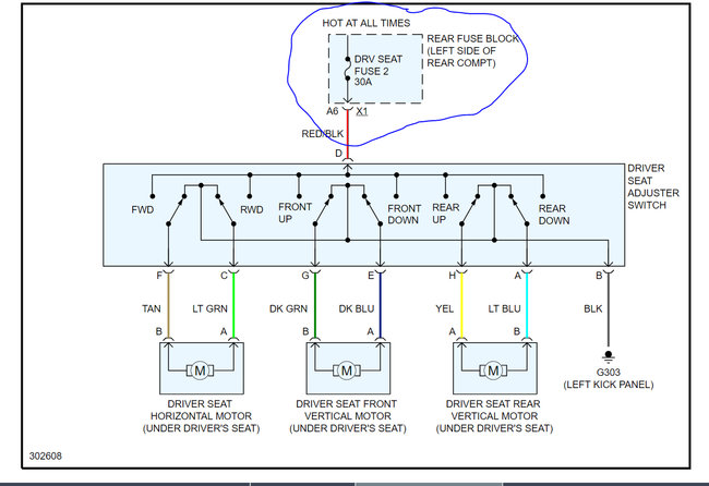

Let driver side window down and got out of car only to find out when I got back in the car the power windows weren't working. The 30 Amp fuse was blown. Went to purchase another being there was no specific one to use and that one blew as well. Then 2 more blew.What is the correct Fuse amp to use and if there are any additionals to that so I get the right one? Or is there another problem?

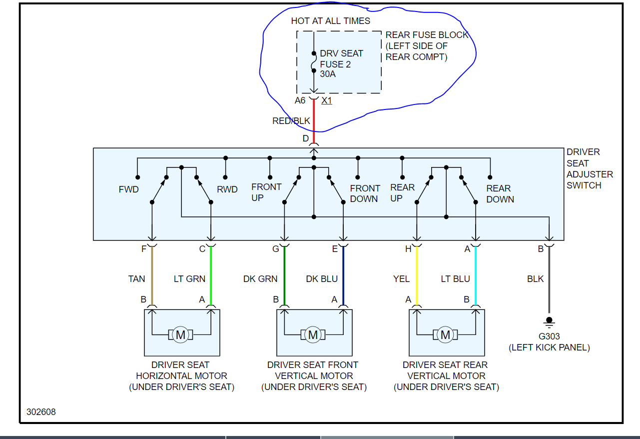

Good morning,
The fuse amp is correct. The fuse is failing because there is something that is drawing more than 30 amps. When that happens, the fuse is a protection device that will prevent damage to other components.
I attached a wiring diagram for you.

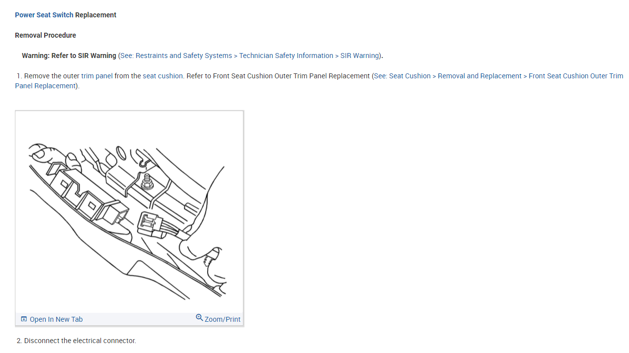

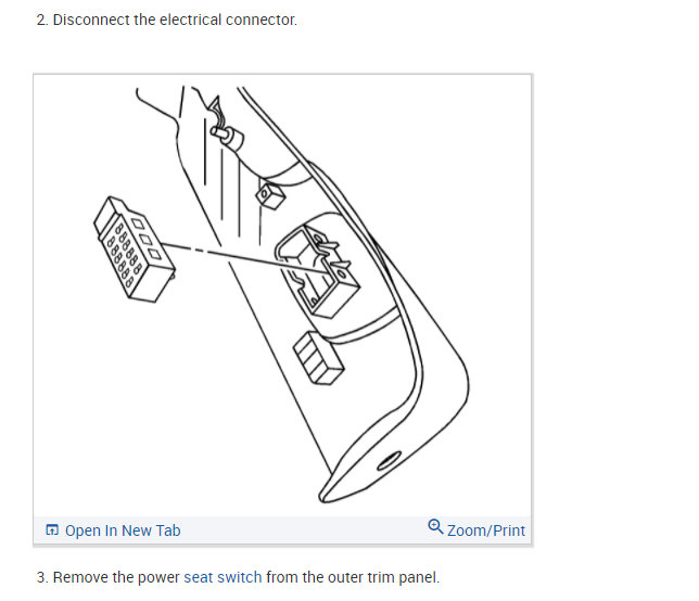

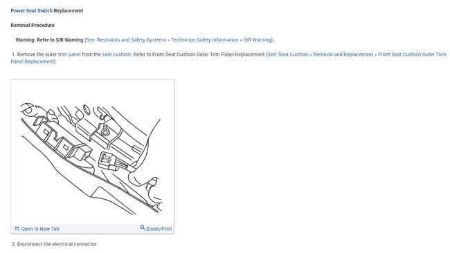

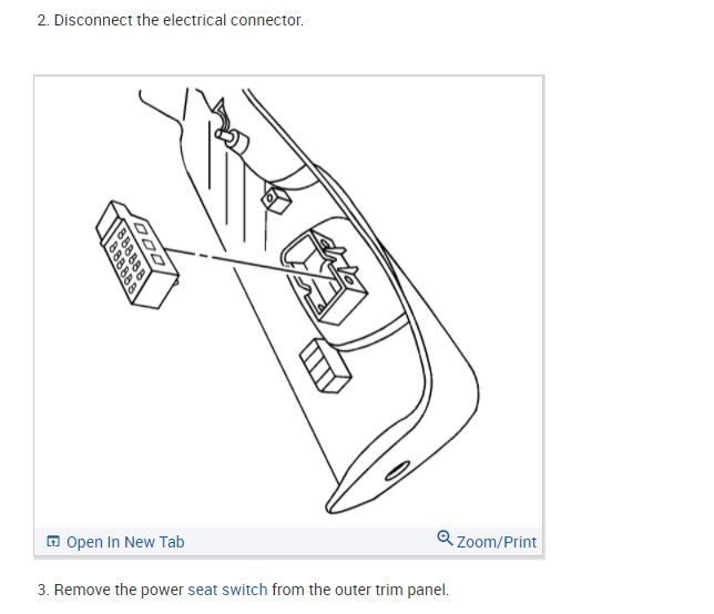

I would disconnect the switch on the driver's side and see if the fuse still fails. That will eliminate the driver's seat as a failure.
