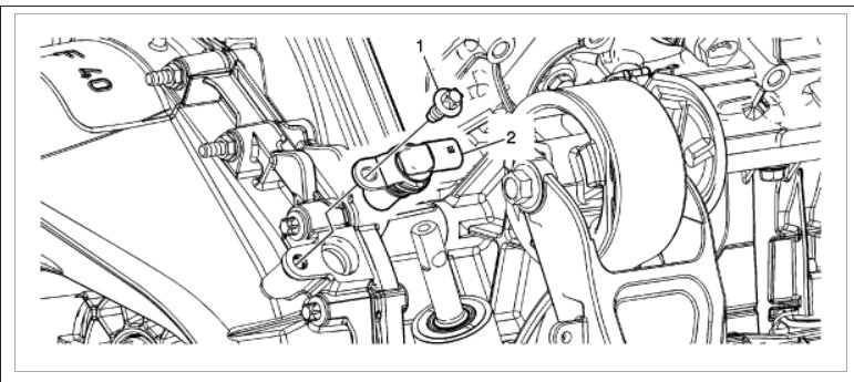

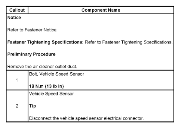

This is an easy one your VSS vehicle speed sensor is not working right I would replace it which should fix the problem.
Here is the location (below)
Please let us know what you find.
