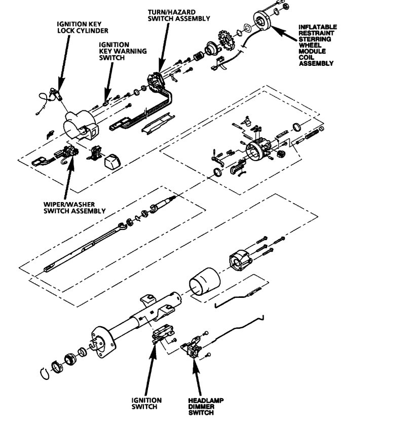

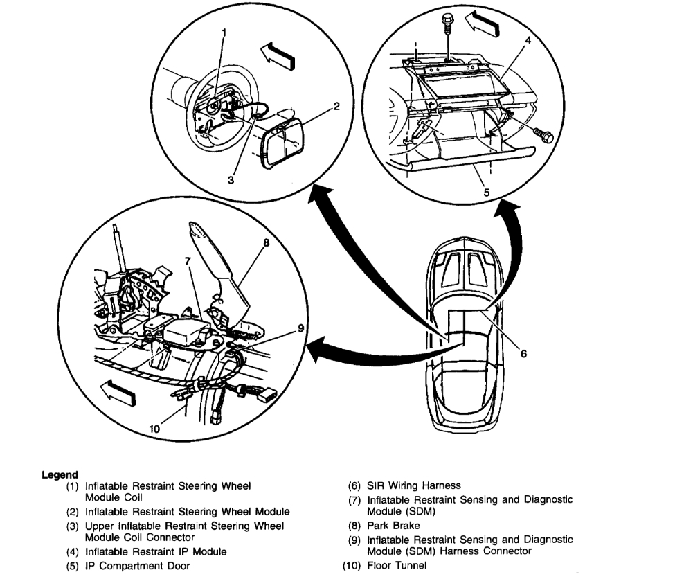

It sounds like the clock spring is broken internally. Here is how you replace the unit. They call it an inflatable steering wheel coil. Check out the diagrams (Below). Please let us know what happens.
