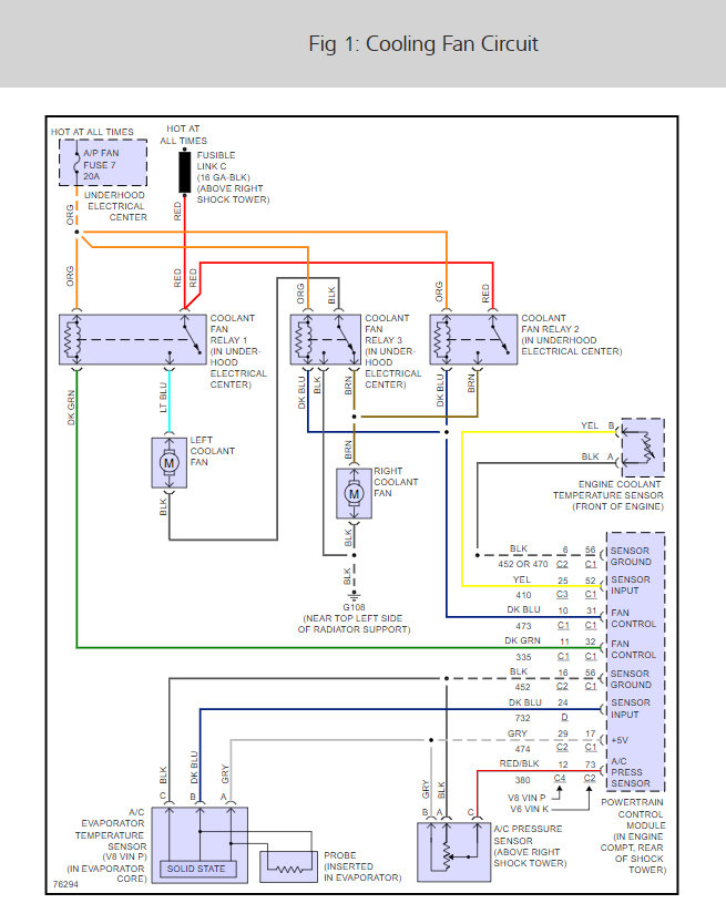

cooling fans wont come on when engine warms up my understanding is 3 relays in fuse box and one fuse can you tell me where a possible thermostat switch is located or a wiring diagram?

test fans by unplugging electrical connector at the fan motor and use a fused jumper to connect the fan directly to the battery. I can tell you how to check the relays (check continuity between 1 and 4, should be none until power is applied to 5 and ground to 2) the engine coolant temp sensor is connected to the water pump. I would check for power at fuse #7 in the under hood fuse panel here is the cooling fan wiring diagrams so you can see how the system works.
Check out the diagrams (Below). Please run this test and get back to us.
