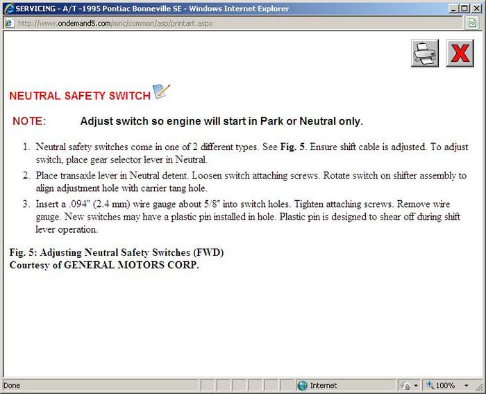

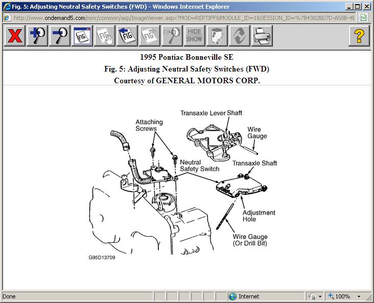

Pretty much dont forget to remove the shifter cable and the arm that it hooks too.Also you will have to adjust the new switch.I posted how to adjust it let me know how it comes out.

Thank you for the tips and diagrams. I will let you know how things go when I get off the ship I am on at this time (on Dec. 28th). Happy Holidays to you and your family!!

I have replaced the Neutral Safety Switch yesterday following the directions you posted and everything went well! This was my first time using this web site. I thank you again and hope your Christmas Holiday was nice. I don't serve on a military ship I work on a supply ship servicing oil rigs in the Gulf of Mexico. Thanks, Tom.
