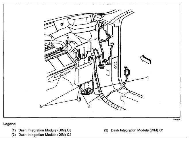

WHERE IS THE BODY CONTROL MODULE LOCATED ON THIS CAR?
Feb 1, 2010 at 3:29 PM
Hey Fred,
It is located on the passengers side near the kick panel, here is a diagram to show you.
Please let me know if you need anything else to get the problem fixed.
Best, Ken

My wife's bonneville se has multiple electrical issues. interior dome lights stay on, door ajar indicators when no doors are open, windshield wipers come on with out being turned on. door locks and windows other than the driver's work sometimes. I think it could be the BCM. Can you send me a diagram showing me where it is located on this car?

Behind right side of dash, near rear of glove box.
